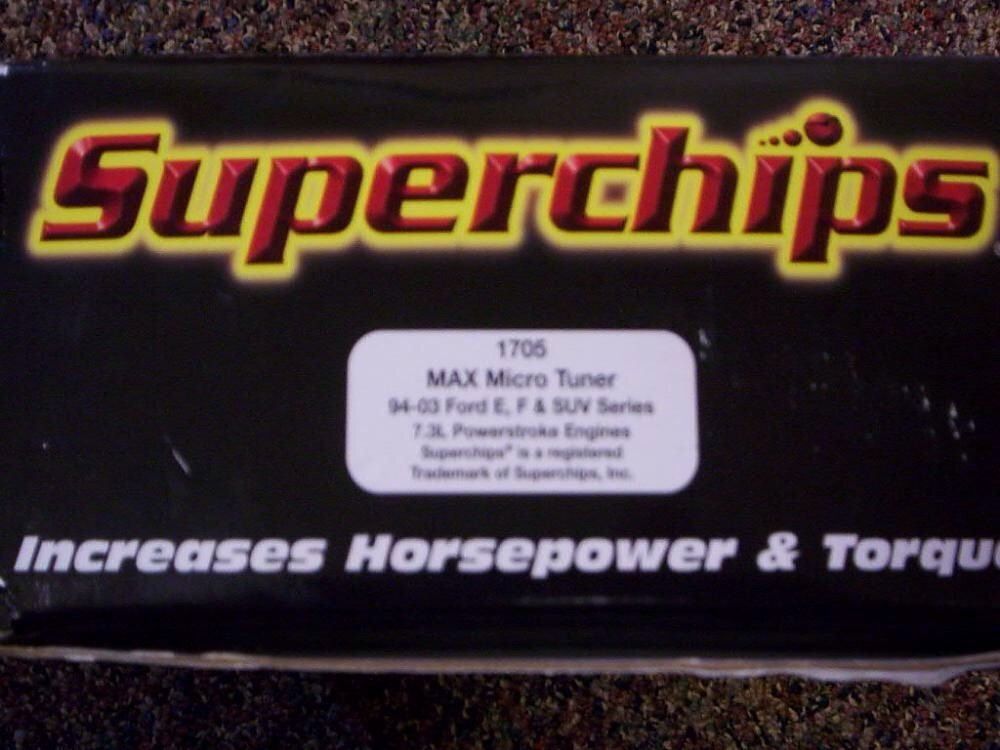

Which one is it ?
If it's the superchip 1705 it will work

It's its the 1705 then it's for 94.5-03 7.3

Yes it is the 1705 and I think it should because I've read that a guy took one off his 96 and put it on his 01

It will work. I have one.

I bought it new and used it in a 97 and a 01

97Ford7.3---If you do decide to get the SuperChip, be sure to have your buddy set his truck back to stock setting, or it will not work in your truck. They will ony work in one truck at a time.
