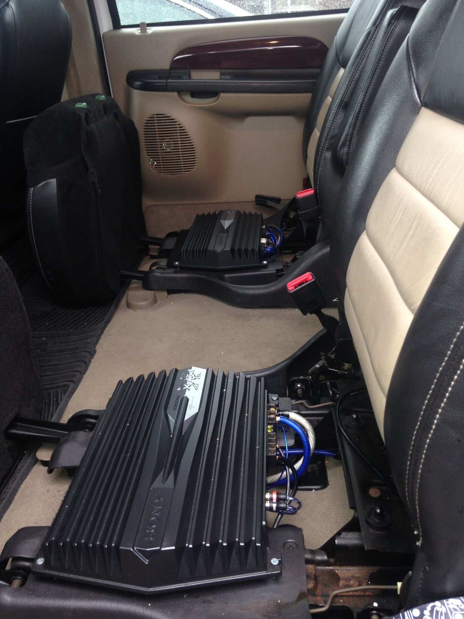

Old Feb 5, 2015 | 11:06 AM
alex--taylor's Avatar
alex--taylor
Joined: Dec 2014
Posts: 114
From: Washington
Here is how mine are rigged. I have one for the mains, and one for sub.
AT
Two amps, 1000 watts for the mains, and 600 watts for the sub
