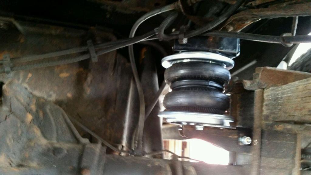

I just installed my Air Lift 5000 kit last weekend. Very nice kit, everything went together perfectly. In case you weren't aware, go on their website and download the rebate form. There is currently a $50 rebate on the bag kits, and another $50 rebate on their compressor kits.

Same kit I bought, same place I bought them. Far as I could tell, Ebay purchases were exempt from the rebate.... but any other retailer qualifies. Print your invoice off Amazon, print the rebate from Air Lift, then cut the UPC tag out of the box and send it all in. I had my rebate check in under 4 weeks.
I took my time and had the bags installed in my truck in about three hours. For lack of a better solution, I put my fill valves in the trailer plug bracket.
Would like to see before and after pics with the camper if you have a chance. My wife claims we are buying a 24 - 25ish foot bunkhouse before camping season this year, so i'll be in the same boat.

Why two schrader valves? Does the kit not have a tee for single inlet and an air line between bags? I guess ya had to pull the factory bump stops?
I hope the kit is as easy to install and works as good as the Air-Lift spring bags I put on my wifes old 3rd Generation 4Runner. Last year I decided to use it to pull my 21' Pro-Line Walkaround to the Florida Keys for a week, with both of our boys AND the mother in law in the back with all luggage. LOL. That little Toyota was pushing it's towing limit on the 10 hour drive. The bags were more than enough to level it out, and then some. Also fixed the sag those trucks develop over time, even with only 2-3 psi in the bags.
My Excursion doesnt sag right now unladen, it's perfectly level. But those springs are weak! The wife likes the cushy ride though, so I'm hopeful the airbags will be the best of both worlds.
One valve for each bag. It would be easy to add a tee but it isn't recommended. The theory be hind it is..... when cornering, the bag toward the outside of the curve will compress and send air through the line into the bag on the inside. This will amplify the body roll in something as heavy as an Excursion.
Yes, the factory bump stops come off, as that is where the air spring ends up.
