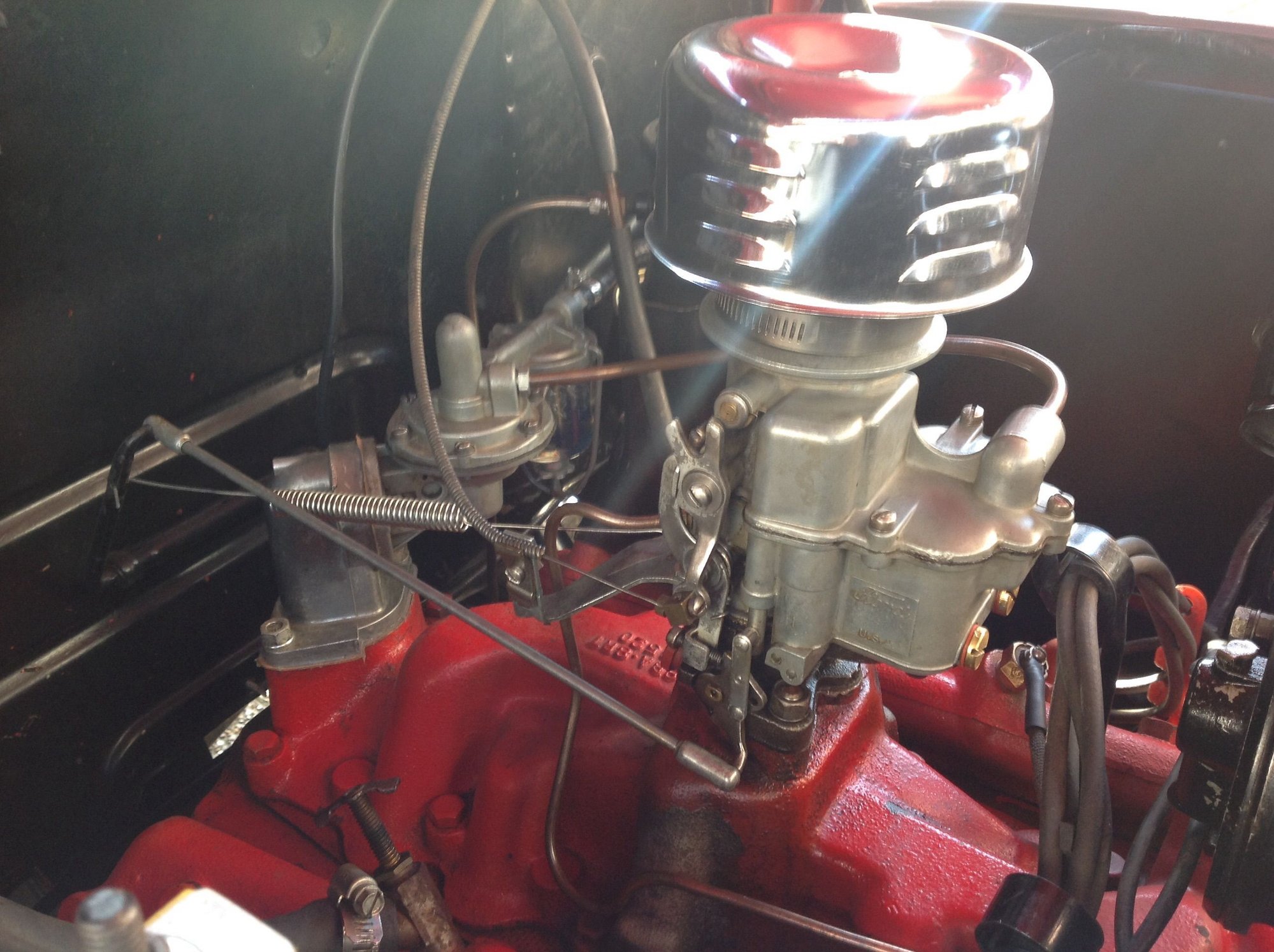

I am trying to figure out how the manual choke cable attaches to the Holley 94 carb.
Does anyone have a picture?

Here is how my choke attaches to the Holley 94. My F1 has an 8BA motor. I think this is the stock choke cable arrangement.
I have seen pictures of one that has an attachment to a "ball joint" that is similar to the throttle cable attachment. I think this arrangment is the normal stock one.
Hope this is helpful.

My 8ba in my 51 ford Tudor has a holley 94 and the choke cable attached the same way
