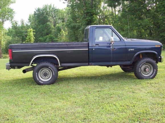

Doing the swap on my 85 was a night a day difference.. Pulled out the tired 351 Windsor/T-18 4 speed replaced with a VE pumped 5.9 and NV4500 trans.. Even though my 5.9 was mostly stock I still doubled torque and fuel mileage.. I had a ton a comments on my truck and it was nothing to look at.. I will be starting the swap on my 79 this weekend...
