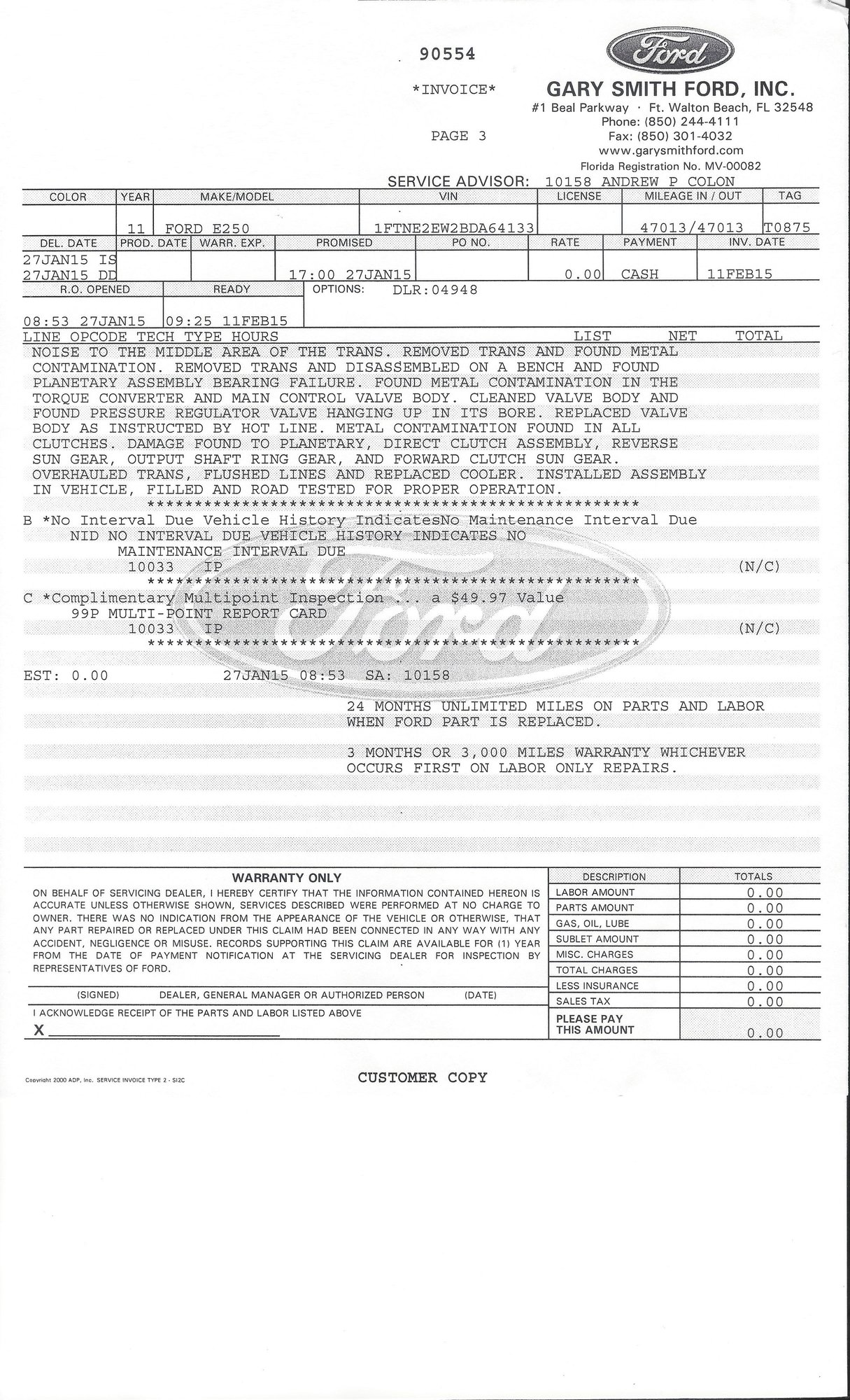

HEllo my name is Jesus I'm having the same exact issue with my van if you can please send me the parts they replaced on yours I would really appreciate it please I'll be waiting for your response

You may be waiting for a long time---this thread has been dormant for almost 7 years now without any updates or follow-up replies.
