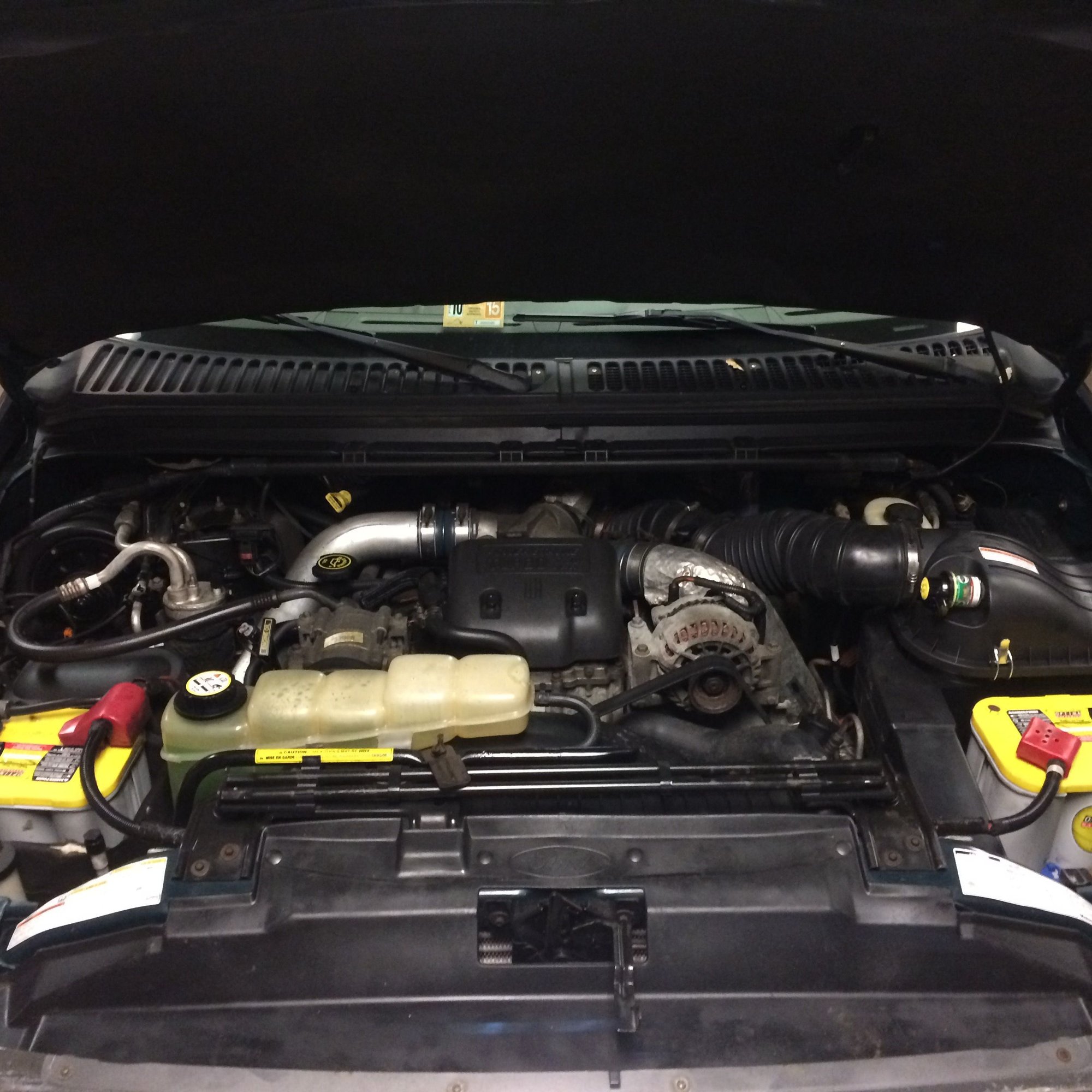

I have yellow top in my truck...they crank the starter nice
