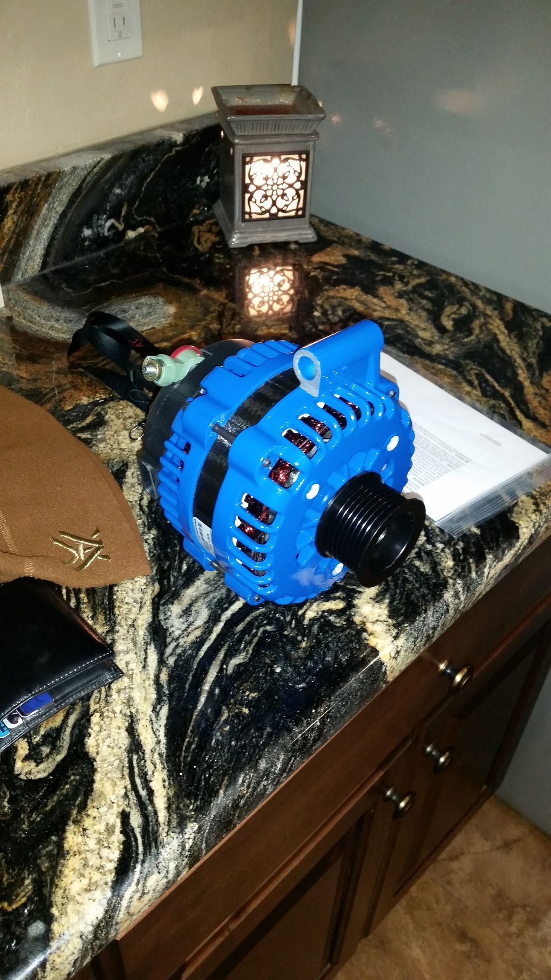

Last week my alternator started to die on me. Putting out less than 12 volts. After reading alternator threads on here until my brain was numb, I decided to order the DC Power 185 Amp alternator. I ordered it Tuesday and it got to my house yesterday! Beautiful Ford blue.
The problem now is the wiring. It takes a different wiring plug than my truck has. Their website says an adapter is included but I did not get one. Did those of you with a DC alternator have this problem?

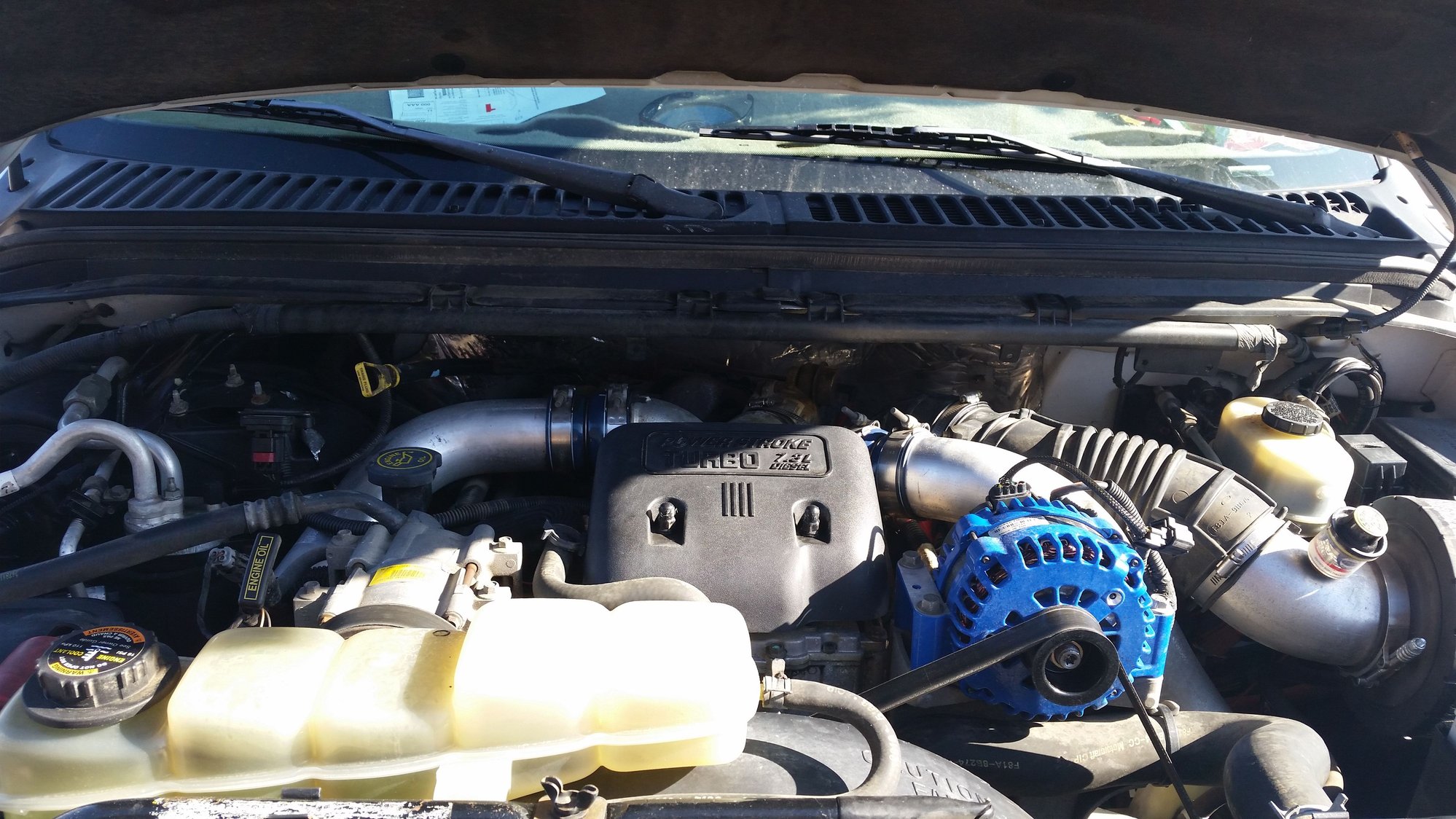

Ford Truck Picture by bleeds blue | 2829854 | Ford-Trucks
Any idea if the adapter would be available at one of the local stores? Orielly, autozone? I dont really want to start hacking wires.

That sure is Purdy. I'd have to clean the rest of my engine bay just to be able to put that thing on. Hope you get it hooked up soon.

Stinks they left out adapter. Wont hurt to call your favorite parts store and ask. They can order i am sure.
I love the granite workbench.LOL
