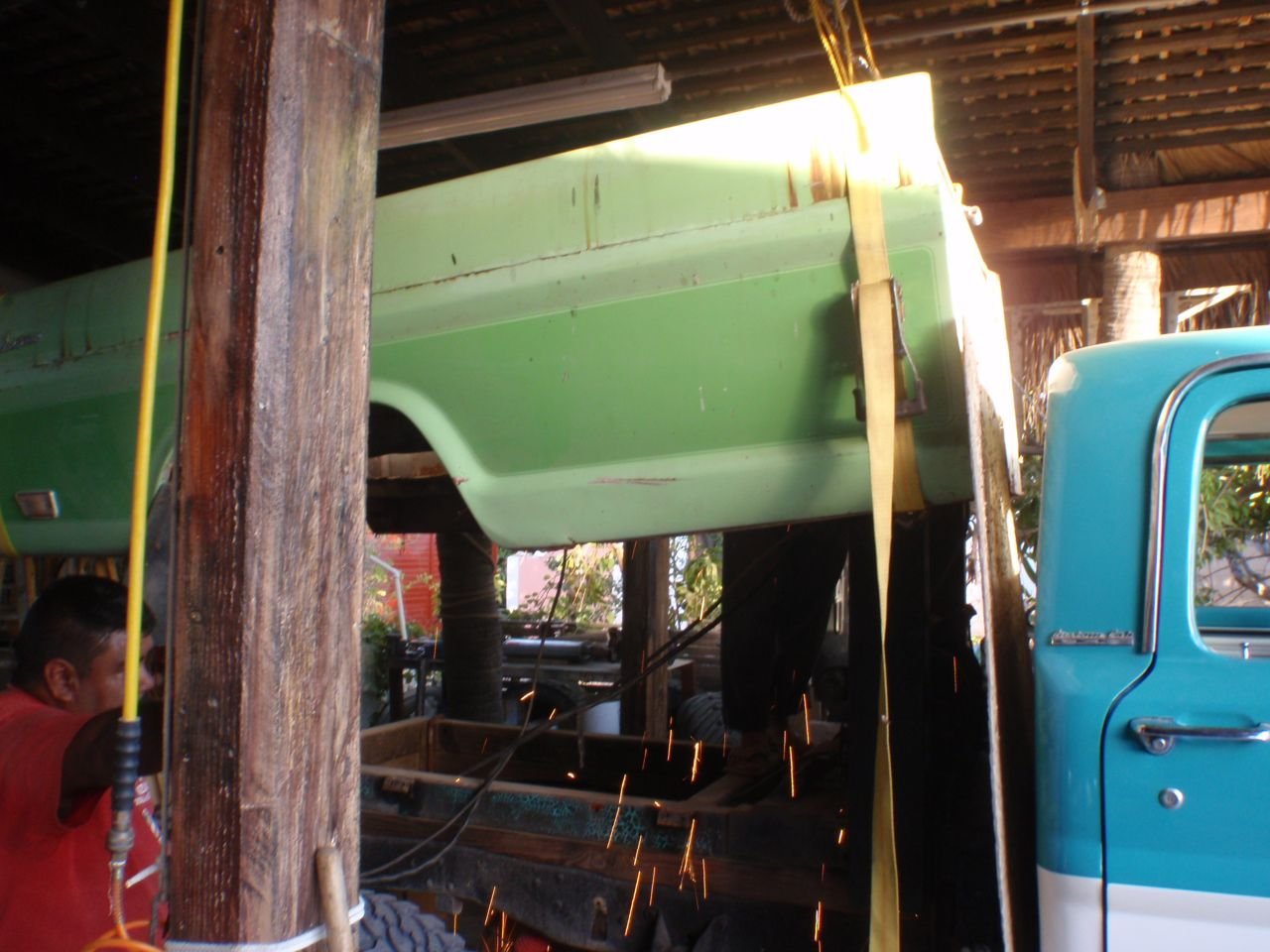

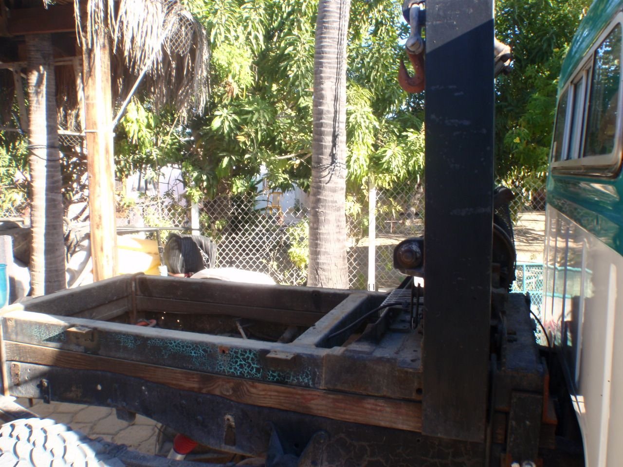

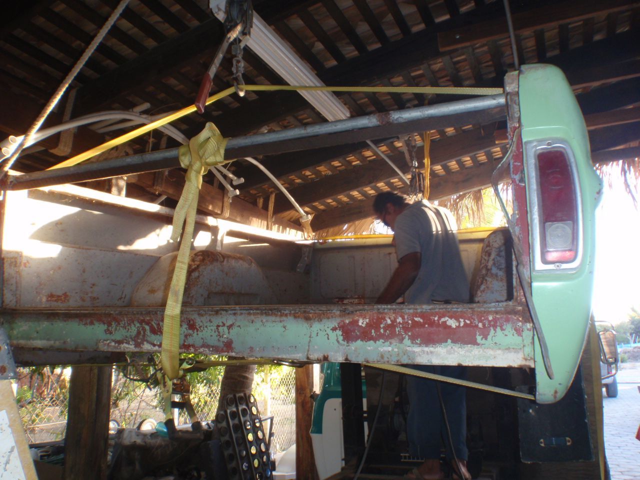

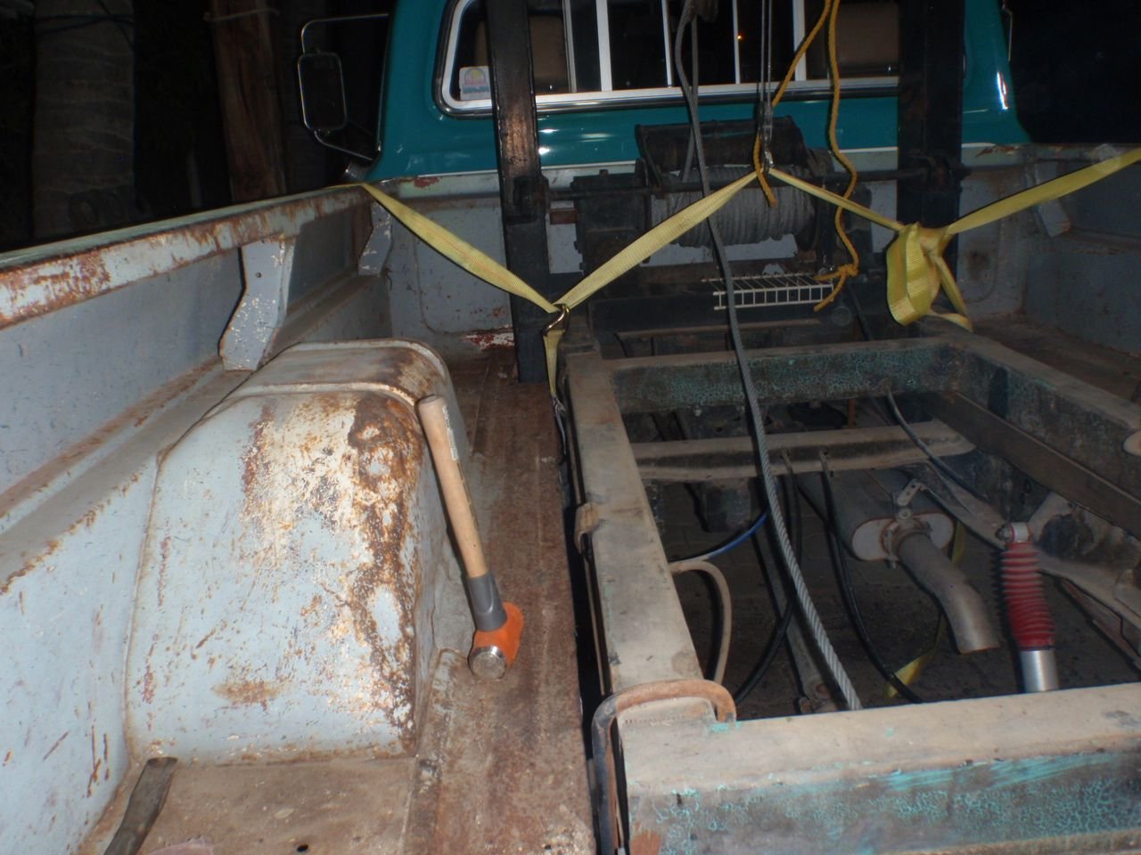

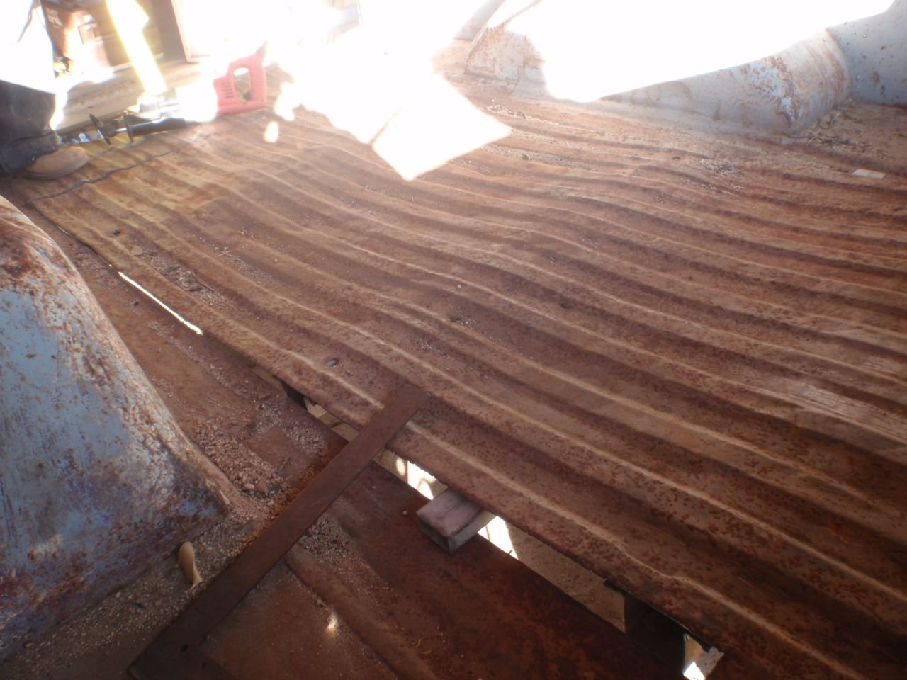

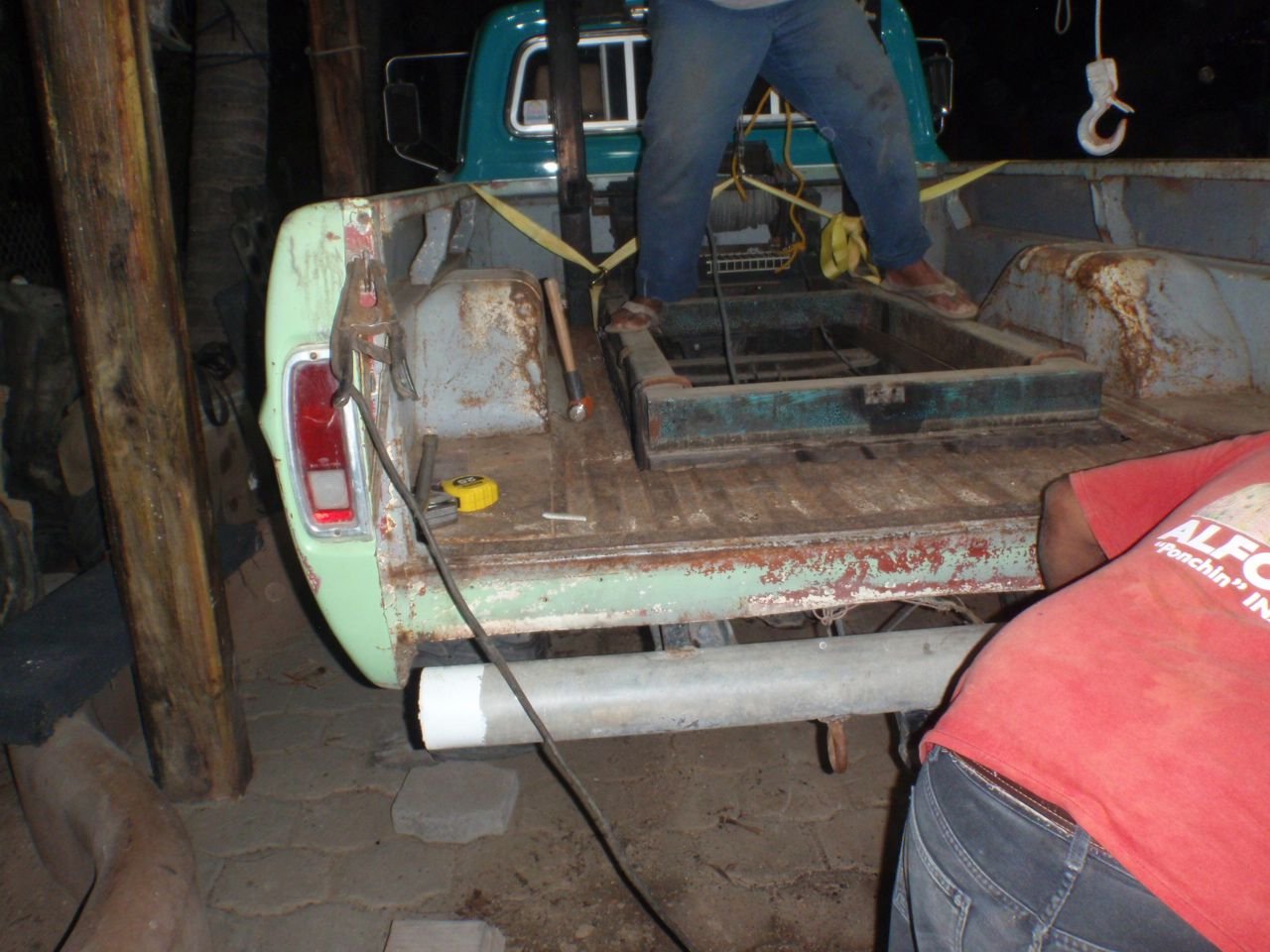

I bought my truck in '69, and after a few years as a stock Hi Boy, I converted it to a flat bed, with behind-the-cab winch & boom.. Now, I am converting it back to a factory bed. The winch, gantry, & booms will stay, which has required some mods to the floor in the bed. So far, it is working out pretty well. Comments & suggestions are most welcome, as my old brain can use help, when inventing...

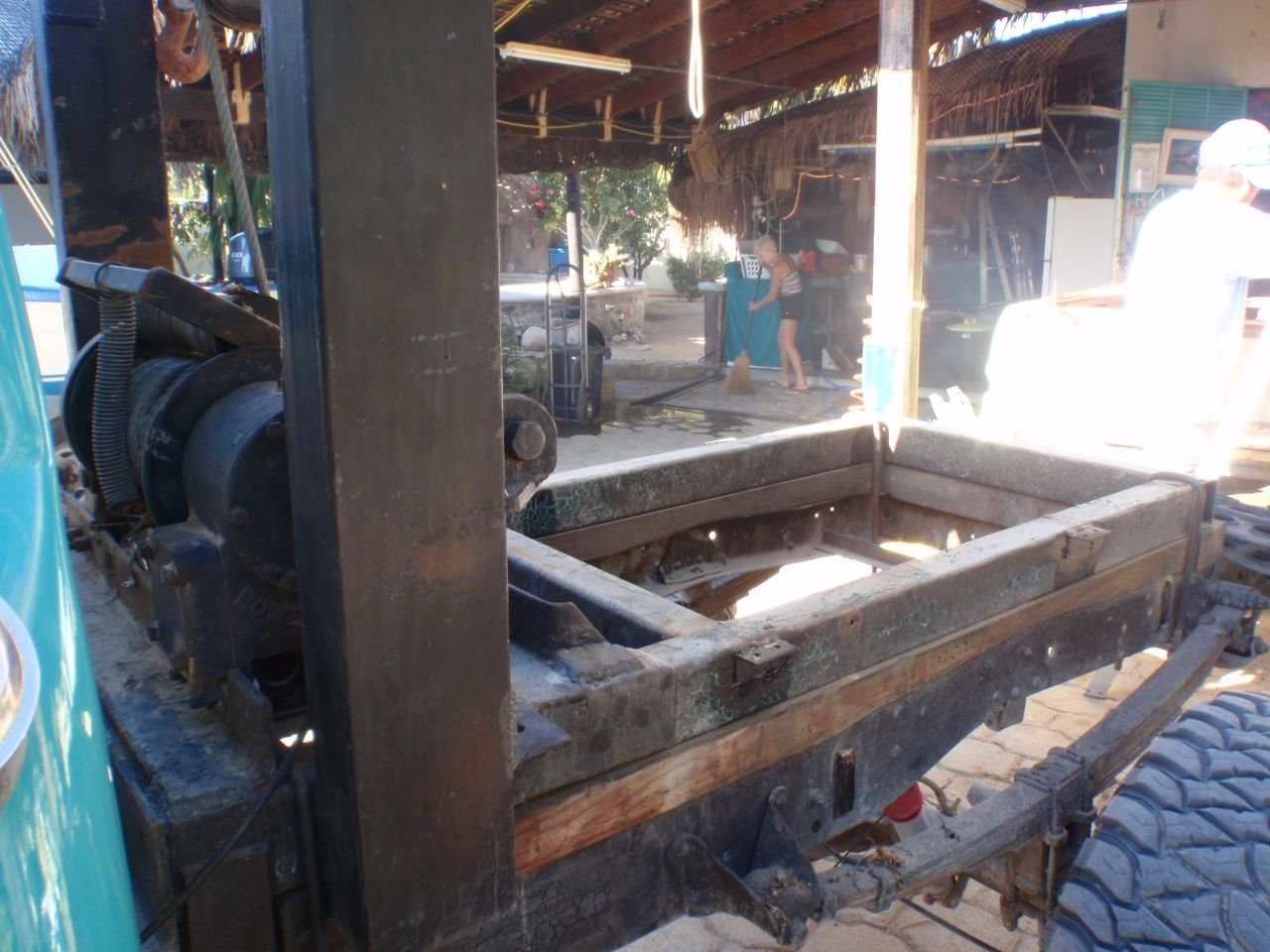

Hope these photos are better views, and I will take some more today, we are suppose to have lots of sun today... The old winch is a Bower 303, which is rated at 30,000 lbs. I found it in a junk yard, , in Carson Ca. in 1970. Scored it for $25.00 back then. The power take off, is a Chelsae, and it is bolted to the back of the transfer case, on the center shaft, so when the transfer is in neutral, and the winch engaged, I have 4 speeds up & one down. Power down is way cool.

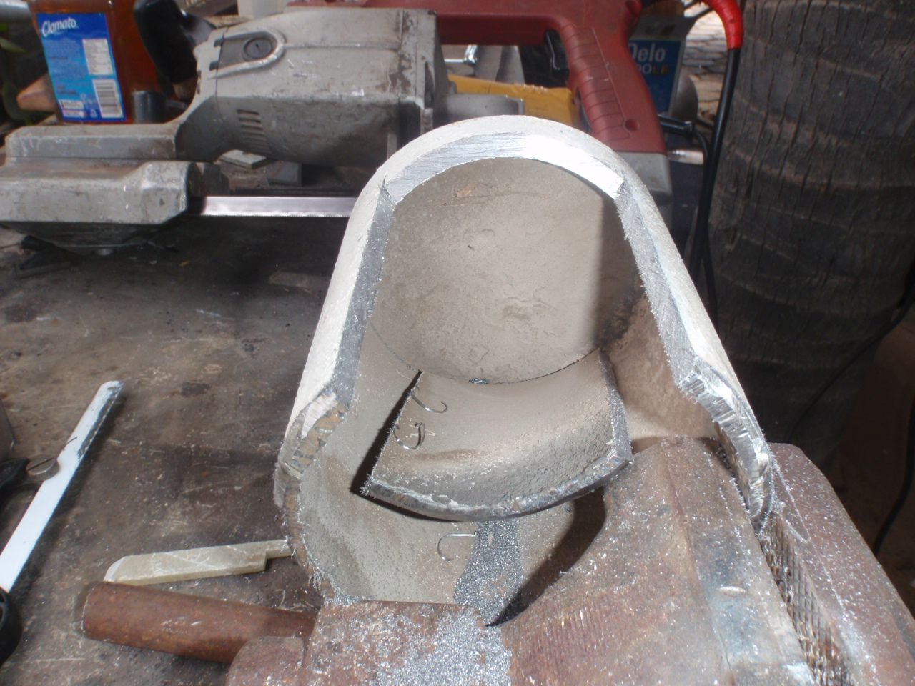

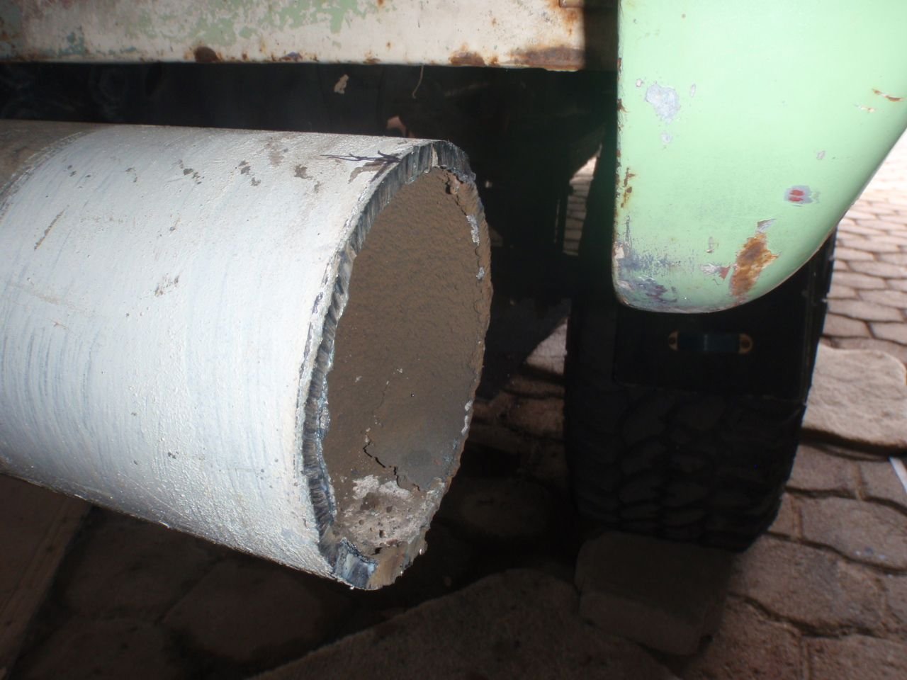

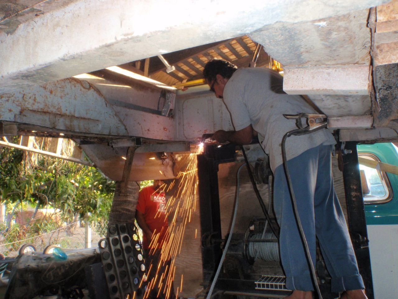

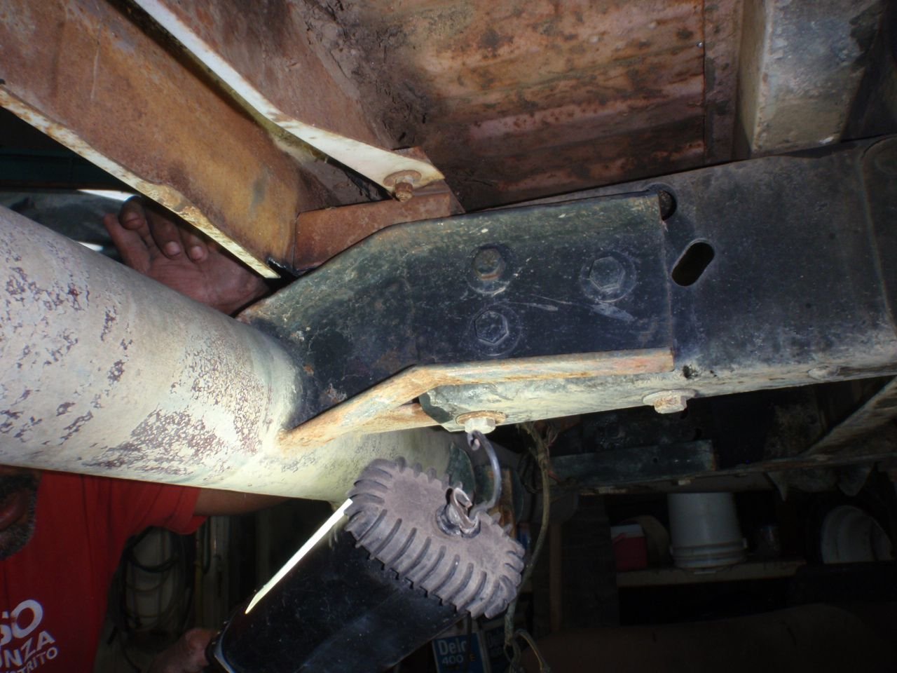

Progress on the rear bumper... thinking back. I prolly should have just pulled it, but true my nature, I went over the top when attaching it some years ago... so to expedite things a little, I just cut off the ends with the plasma arc... so... a short cut, turns into the long way around... will I never learn?? Anyway, it was easier to deal with the small pieces than the entire thing... see for yourselves...
