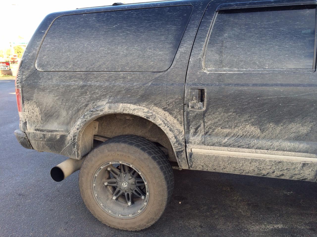

I spent a week or so up north, I could not drive my EX in that crap. If your looking for long term protection garage it! Growing up in CT. I would buy a beater for use every winter.
Attachment 112775
I'm still waiting to see pics from your WV trip, i don't recall seeing them in the thread. I bet you had to spray that thing off the second you hit GA or FL, then wash it 2-3 times to make sure you got all the salt off of it
-The Great
-The Great
I had it pressured washed 2 hours concentrating on underneath then clay, compound and wax total detail by pro was about 8 hours 2 guys. Lol
