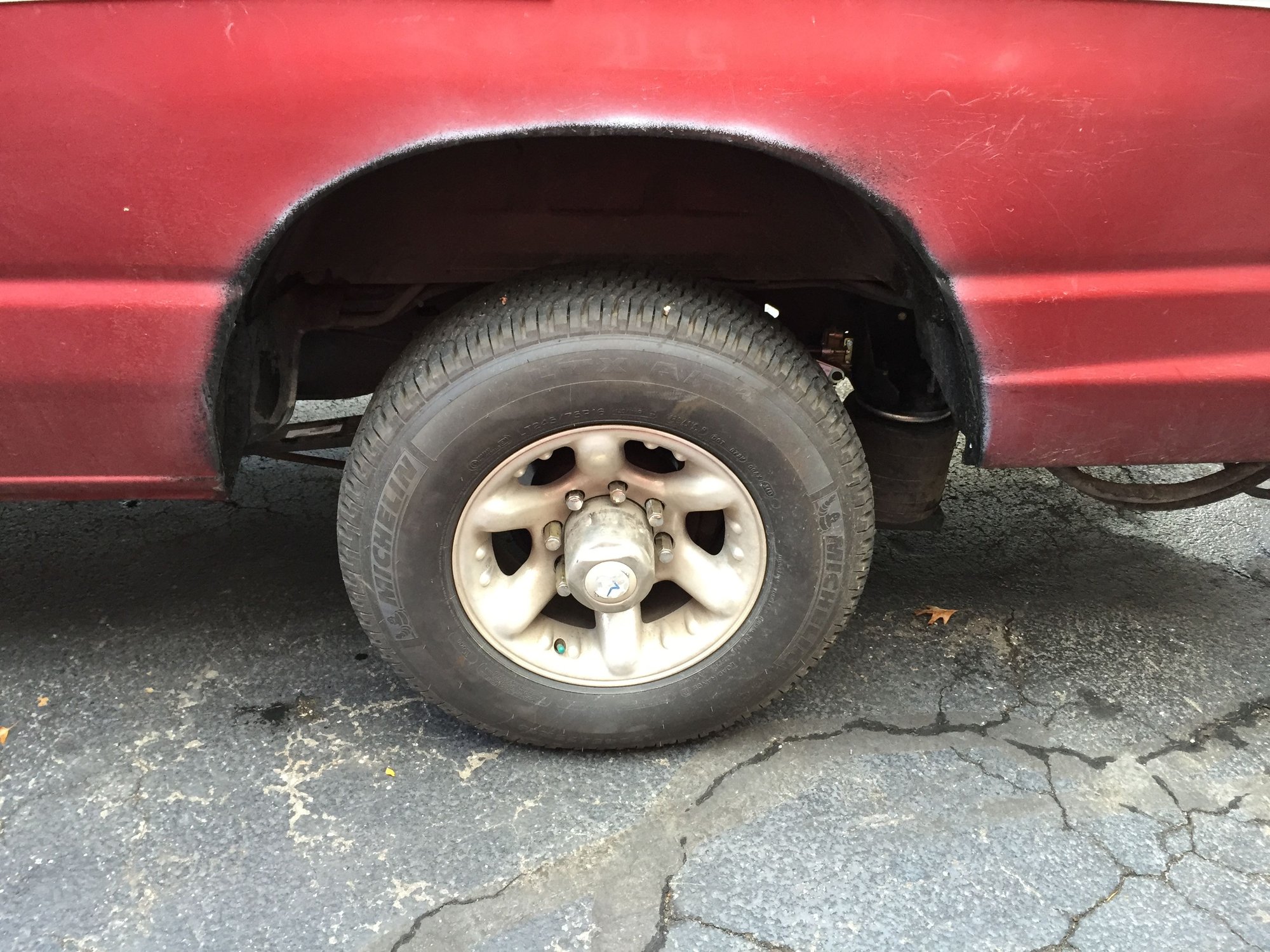

Ok, Pictures are here. I have to tell you now, I am bad about taking pictures and I really need to get into the habit of taking more. I am building this for someone else.
This van is as clean as anything Ive ever seen before. I wish all vehicles I worked on were this clean. It makes work so much easier.
Here is the van and trailer in use.
This is the rear. The wheel well has been opened up and the rear air ride suspension has been installed.
The rear part of the side door has been "shaved" and this is the fitting of the rear fenders.
Removal of the front suspension.
Installation of the front axle. Front axle is a Dana 60 from a 2001 F-350 Dually. Springs and hangers are from Ujoint Offroad. Very quality pieces. I will use these again.
Transfer case in place. We swapped the transmission and transfer case from the same donor truck that the axle came from. The transmission crossmember has been lowered by 2"
New dual shock mounts fabbed up and installed.
This is where I am at right now. The front is done. I am removing the Dana 60 rear axle and installing the axle from the superduty. Then it is on to the engine mods!!

looks awesome, same colour even as my daily 2003 E350 ext clubwagon . mine is VERY rusty.
why did you go with the air ride in the rear and the leaf springs in the front? or was this just how it panned out?
I have a dana 60 front for mine from a front wheel drive wheel chair bus, but all the bracketry has been removed. I have been toying with a superduty front as they seem to be pretty easy to find here in Ontario, but the dually rear I have is from a 2000 E450 and has the old 8bolt pattern.
I would definitely figure in the intercooler for a 90% towing application. are you going to drop your trailer hitch or just use a large drop receiver?

I'm curious if the rear portion of the side barn doors is inoperative will that reduce its utility as a hauler---has to be a bit inconvenient if rear seating will be part of this refit.
Maybe that question would be was there no other way to cover the rear wheels and retain that door's function?
The air ride is because of the weight swing of the trailer. He loads this trailer up with all kinds of different stuff. The air ride system is automatically leveling. It is very similar to a semi rear suspension. When he first brought the van home, the trailer would drop the rear right on the ground.
The plan is to make a rear bumper/ hitch similar to a F-450/F-550 style. Big plate with Class 5 hitch sticking thru. The plan with the van is to keep it as low as possible so a big drop hitch wont be required.
The interior plan is for reclining bucket seats for the second row, and the rear will be open for cargo, so rear seat accessibility isnt an issue. The most that might happen behind the second row is a fold down bed.
