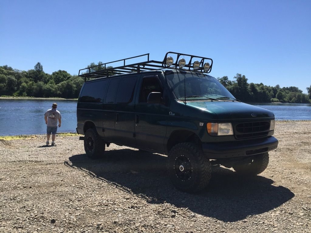

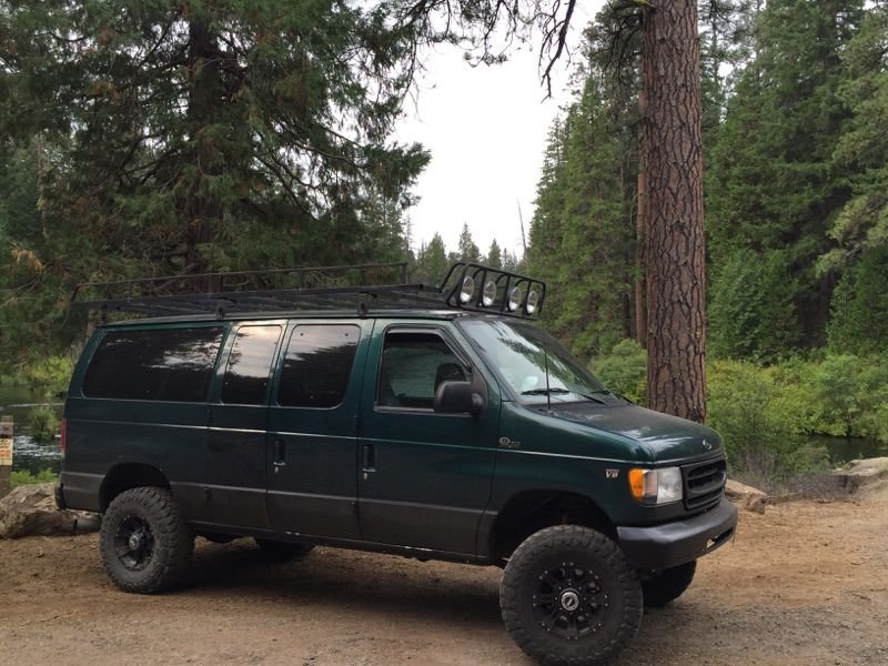

Some teasers until I get the intake pics dug out.
On the Metolius River near Sisters, OR
High-up on the Columbia River rim in Northern Washington.
On the Willamette River in Independence, OR

Nice looking van. Is that a quigley conversion or a sportsmobile? I thinks that's what they are called at least.
Old Nov 12, 2015 | 06:14 PM
Dr. Johnson's Avatar
Dr. Johnson
Joined: Nov 2011
Posts: 508
From: PNW
Thank you! It's a Quigley, works great. My only complaints are the control arms are not sufficient and have already been welded up once and the they need an additional steering stabilizer added to smooth out the wheel on the highway. Otherwise it's been a fantastic truck.
