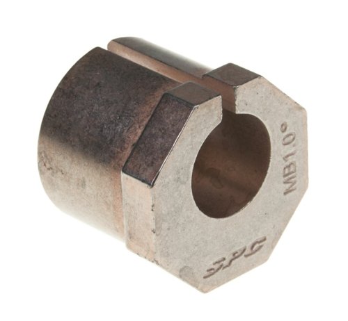

My '12 pulled to the right when I first bought it so I took it back to the dealer I bought it from. They looked at it and said we don't do front ends on the Super Duties so take it to _____ which is another Ford dealer about 30 miles up the road. Took it to them and they checked it out and told me to live with it because it is in spec.. Well, I been driving a long time and I ain't about to put-up with the truck diving for the bar ditch every time I let go of the steering wheel.. Asked the service man to ride with me or drive it himself and he said "Don't need to, it's in spec.. You just don't know how a "big" truck handles"
So, I thanked him and took my truck to a real truck mechanic and he fixed it in less than 2 hours for a $175... Money well spent... I ain't headed to the bar ditch no more.. .

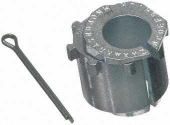

Originally Posted by sdetweil
can u tell us what they did?
Moog Caster/Camber Bushing

Hey guys.
I'm from the 7.3L forum for the reason you would expect, but I just danced this dance for two years myself. Everything the OP describes looks like it was copied and pasted from my threads. The camber was my culprit, but I read something here that raised a red flag: "Moog Caster/Camber Bushing"
While I dread refreshing concern on the matter, I feel it best to share what the experts taught me - the single bushing is a good fix, but the double bushing is a cam inside a cam, and they are known to spin and drift out of alignment on these heavy Superduties. This may or may not be the case on a 6.7L-era Superduty, but I would ask which one they installed.
