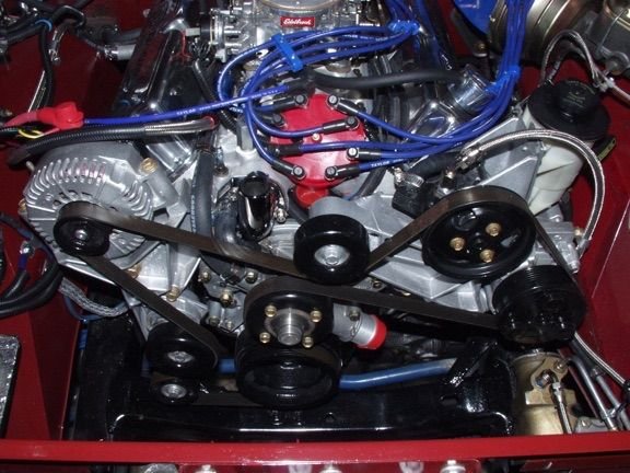

If you can handle the initial cost, go with a complete package now. Here is the V/A Front Runner system, best package that I have found...you don't have to get the bling if you want to save a few bucks.

Can you actually get a Vintage air unit without the bling?
They make one that is not polished/chrome plated...in fact one option is to have it all blacked out. Seems a shame to have all that nice aluminum hidden under a coat of black but I guess some like it that way. I sprayed mine with Glisten PC to preserve the finish and to make maintenance easier.
