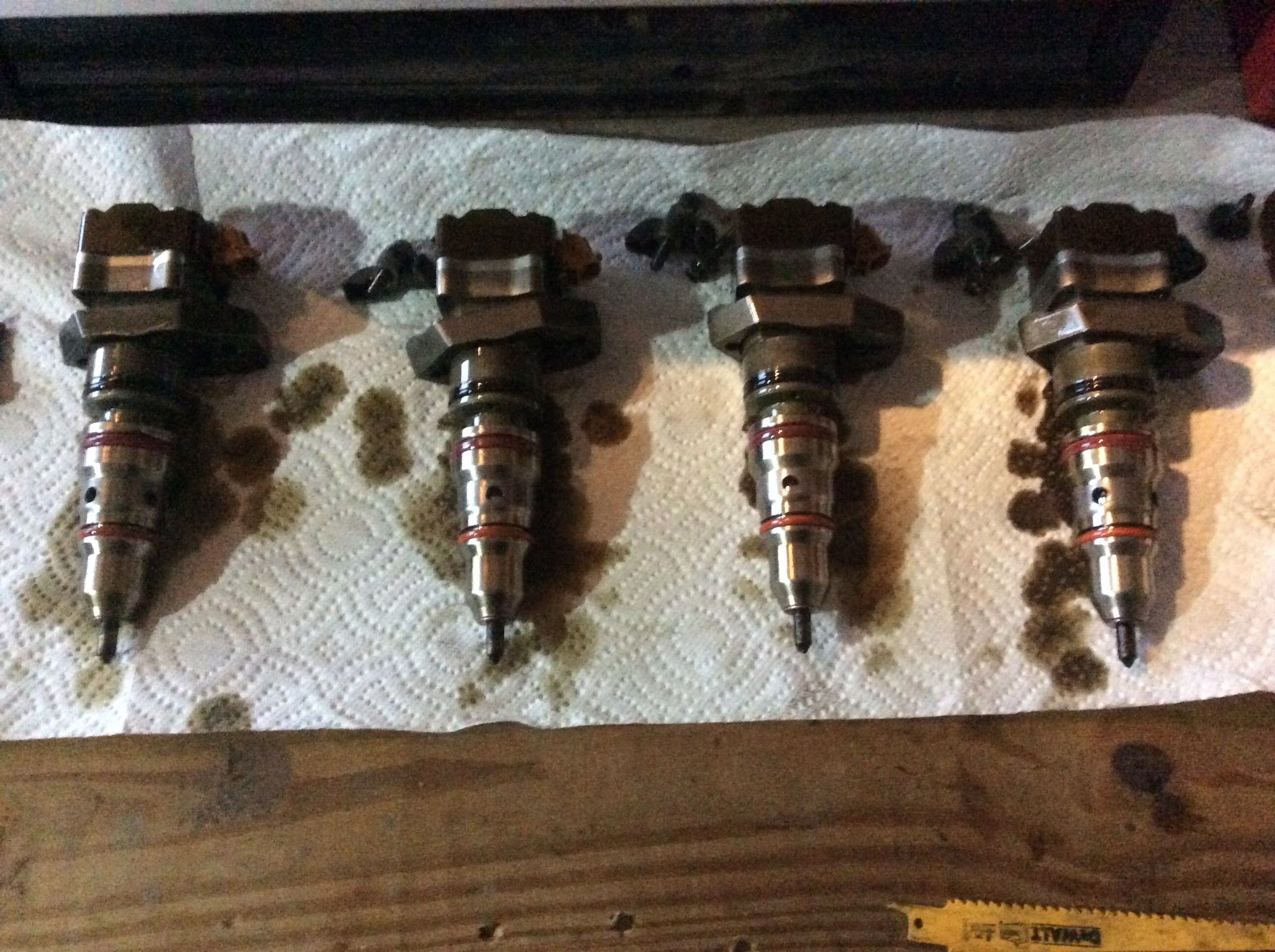

Are these injectors normal?
Is the soot on the tip normal? Stock remans with 4000 miles. 2-8 left to right. Right bank looks the same. Perdels on 2 and 8 were 1.4-2.5. The rest were 0. Passes CCT every time. I can feel the shudder between 800-1400 rpm. Copper washers are really on there. Is that normal?

As a matter of fact the do look quite clean.
Looks all good as long as you didn't remove them with that saw...

Don't see any copper washers, who's remans?

The soot is normal, and it's much worse in the winter.
While the PERDEL of 2.5 is slightly elevated, if that's #8 - that can be explained by the form of CPS you have. If it's a true 2.5, that is a mild imbalance and you may feel it or not. Most scan tools can't see PERDELs once the RPMs go above idle, so I have to ask if the high PERDEL synchronizes with the rough spot on the tach. You may possibly have nothing going on with the injectors.

All that is perfectly normal, and I don't see anything wrong in the pic either. 'Cept that saw blade, I did a double take on that too!
