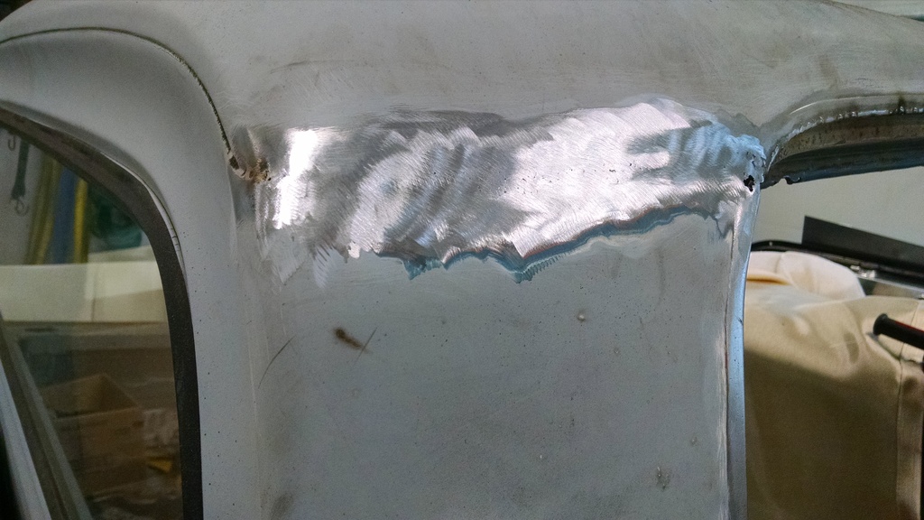

I have done some work on the donor cab, welding up the roof seam and started shaving the drip rails. No bondo buggy here.

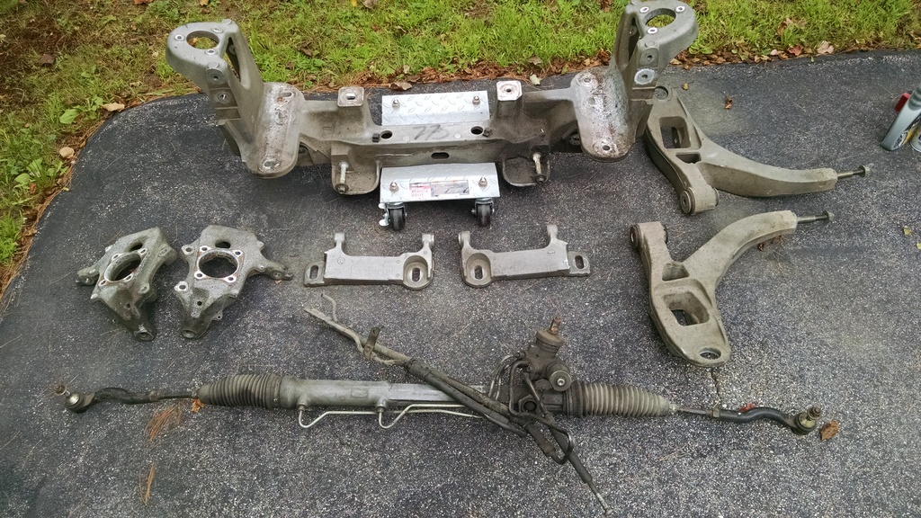

I pulled the front end apart, cleaned, bead blasted some parts and wire wheeled the rest. Going to shoot some AlumiBlast past and replace all bushings, ball joints, etc. prior to reassembly. Pic was taken prior to any cleanup work.
