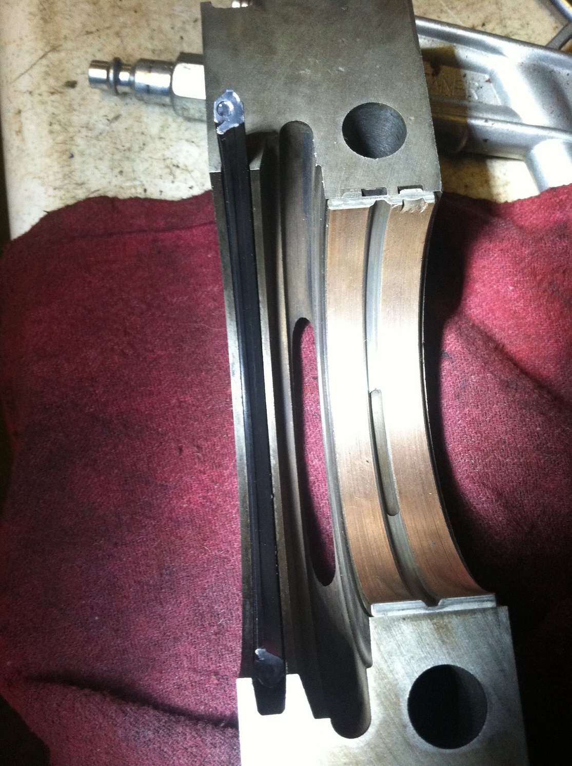

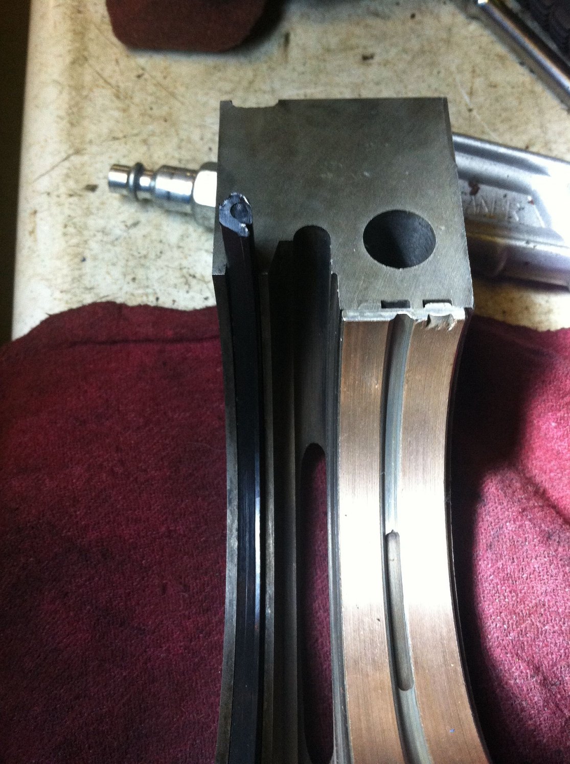

I got what was left of the old rope style seals out. The parts store sold me the rubber one. I can't find a picture that is close enough to show which way it goes. It didn't come with instructions or the little plastic tool I've seen on some videos. The pictures in the manual show where to put the RTV but is not very clear on which way. I read some people saying the big lip goes toward the front of the motor. Not really sure which is the big one. Looks like a curved side and a flat side. I think #2 makes more sense but not sure. (Bearing cap is shown in pictures with the left side facing rear of motor.)
#1 curved part of seal facing front of motor<br/>
#2 curved part of seal facing rear of motor
Also, in the middle of the bearing cap there is a spike to hold the rope seal in and from what I've read on here it will tear the rubber ones up. How do I remove this spike and is there one in the top also?

The lip goes toward the front of the engine. Never had a problem with the "spike" - helps hold the seal....and it's a good idea (if you can) to leave a schosh of play between the seal and block. Like you have in the picture, but remember what side is longer on both berrins.

I'm still a little lost here on what side of the seal has a "lip". I would think that means the #2 picture is right and #1 is wrong.

. Yes, #2 is correct... the lip is that ridge sticking up the most... oil the crank where it will rub against the seal lip.... offset the joints in the seal slightly from the joints between the seal holder halves (like you have it pictured)...
. You're replacing that damaged main bearing, correct? How did that happen?

. There's a chip out of the bearing surface near the top of the picture... prolly wouldn't hurt much, since it's not where there is a lot of running pressure on the bearing... but still, bearings don't cost much...
. Looks like it was pried on or driven on with a screwdriver or something... I've never seen damage like that before...
. Also, the bearing is copper colored... not sure if those should be silver/grey babbit... and worn down to copper...

That's not a chip that is used to line up the bearing in its bore and to keep it from spinning in the block
. Never seen that notch so jagged before... and nearby areas so chipped off...

. Layers of an engine bearing... babbit wear layer... copper layer... steel backing shell...
