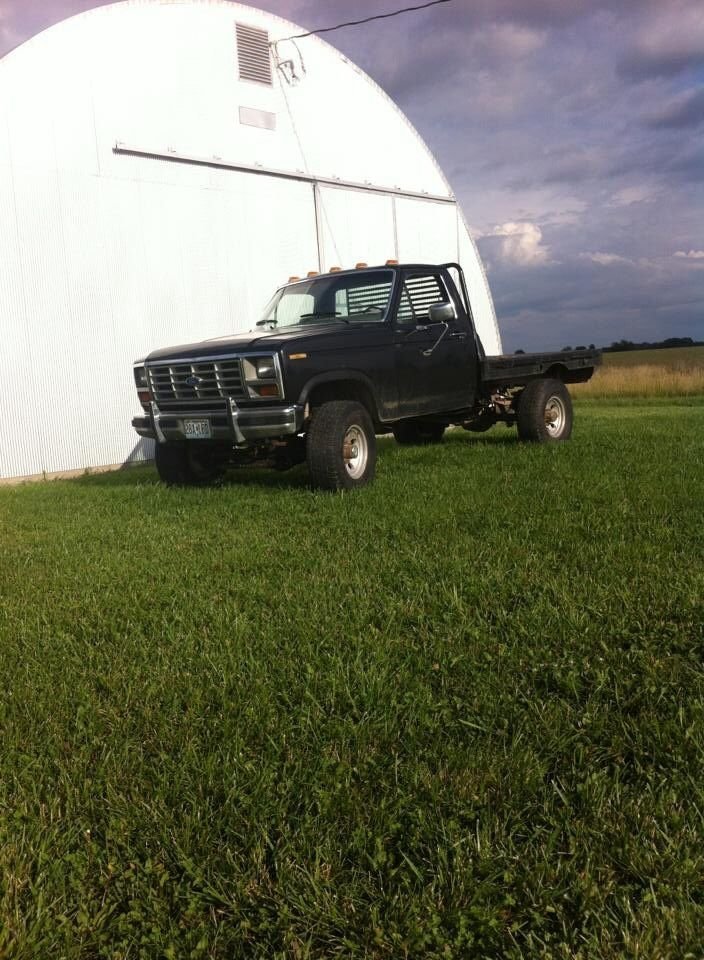

Here it is the day I brought it home

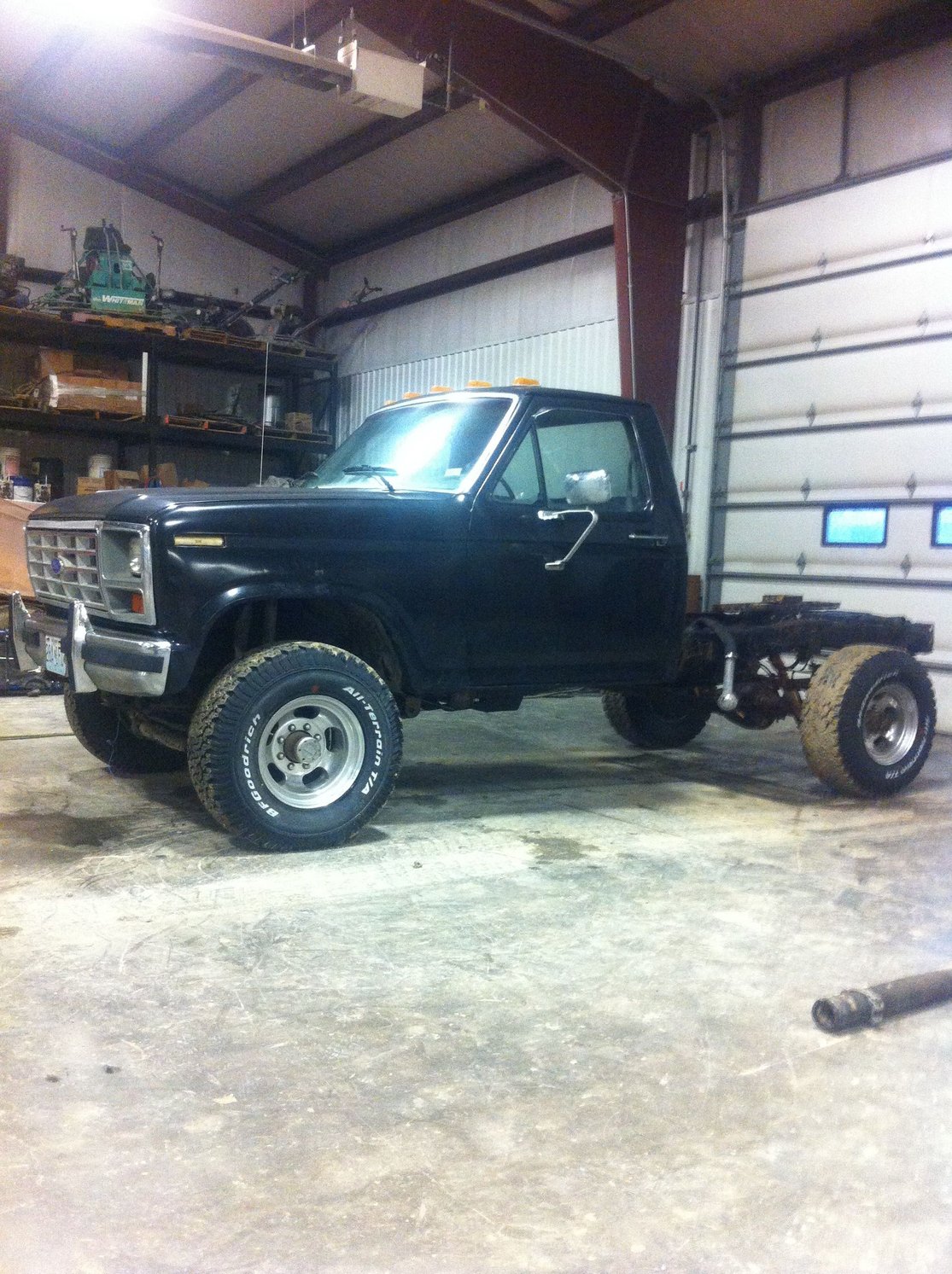

I was on craigs list on looking for something and like always I found something else I did not need but had to have,these wheels are going to make it right! As the plan is to have this truck as if it was strait out of 1986 new

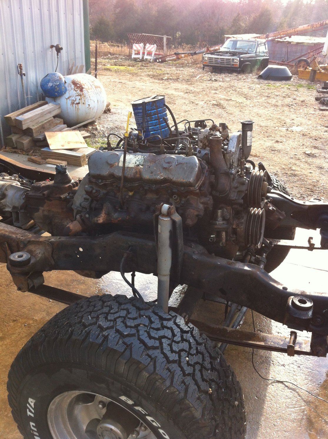

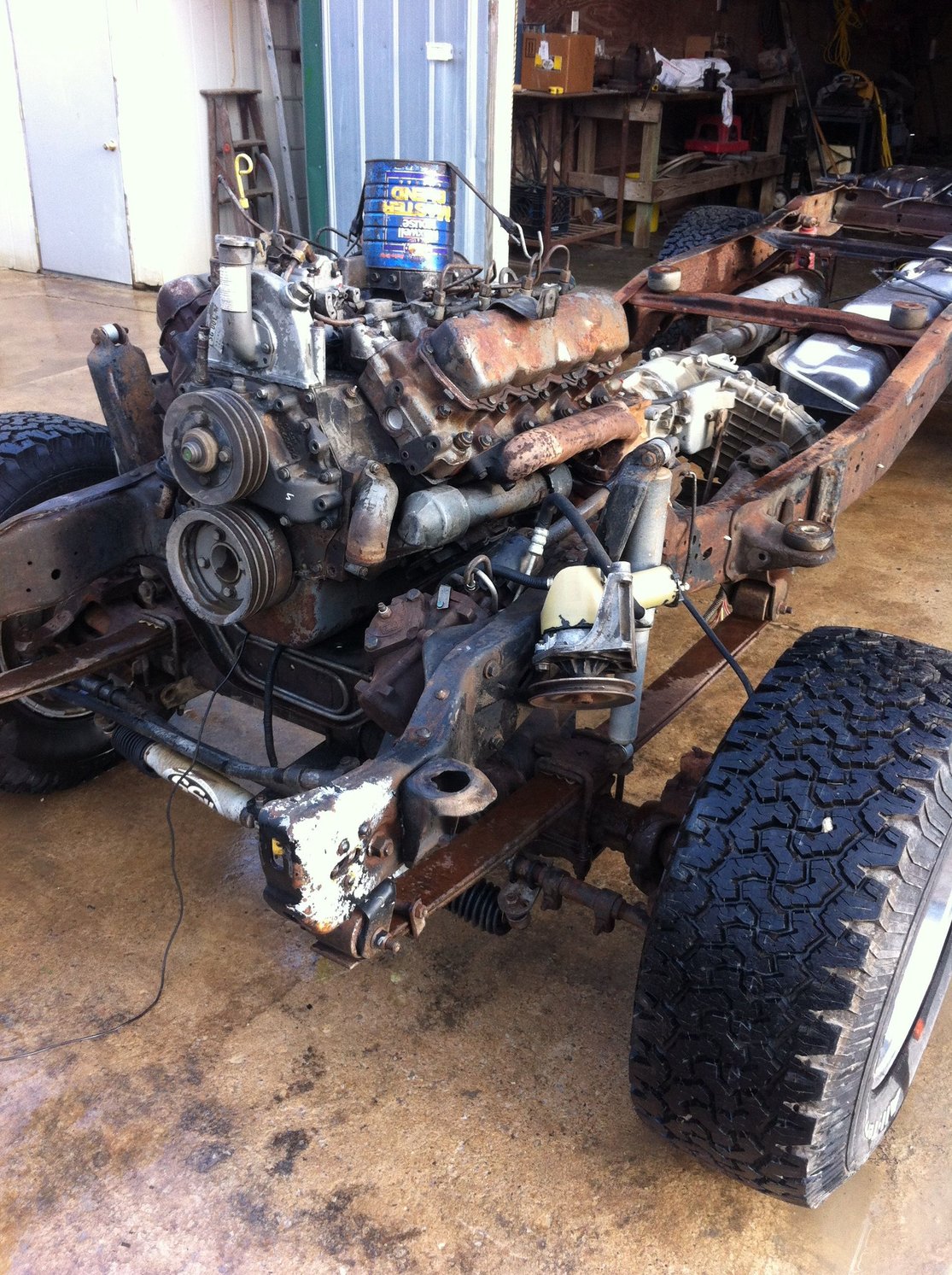

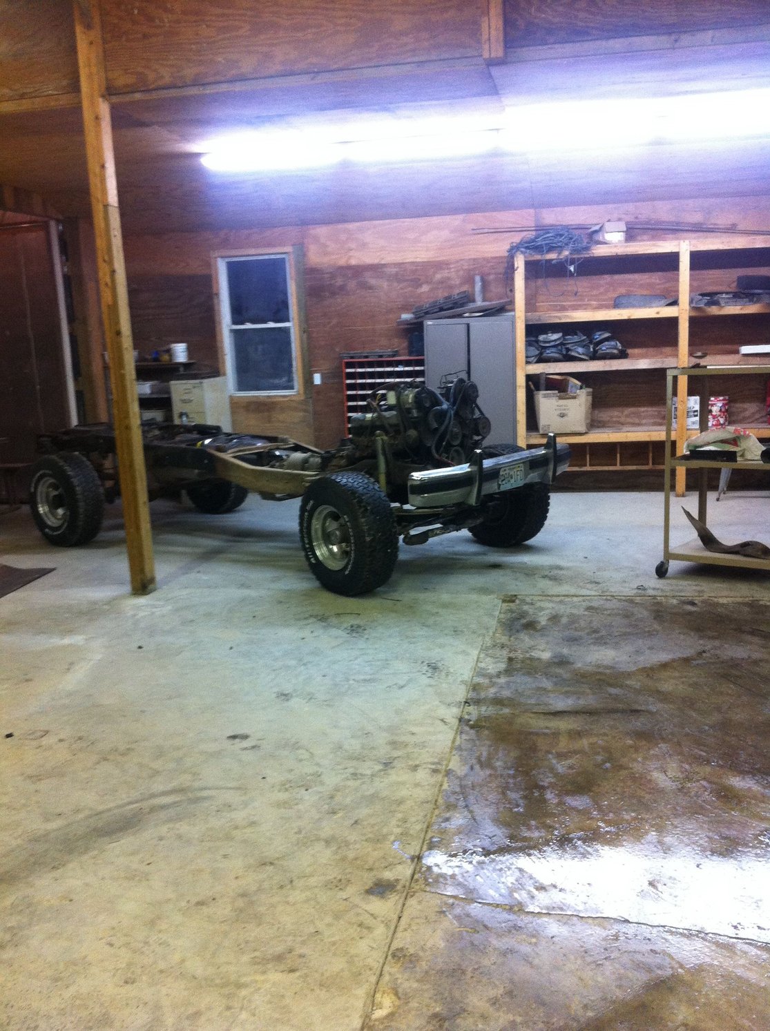

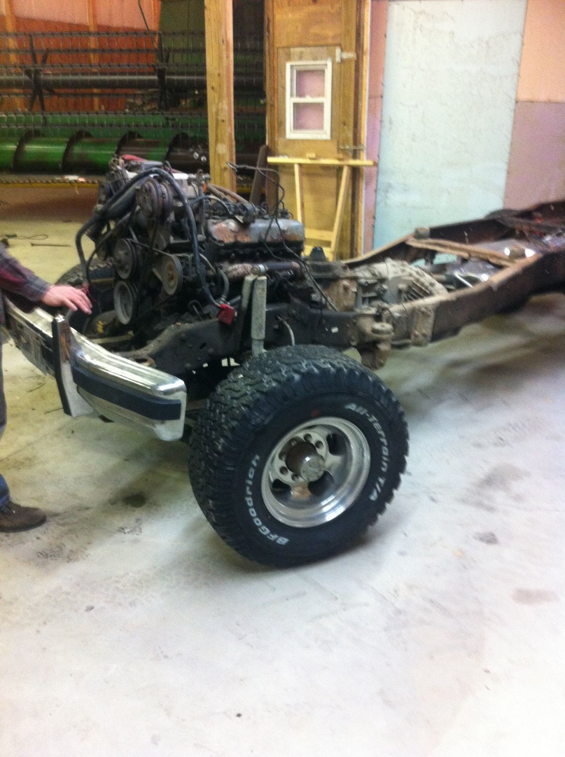

Since the cab mounts are shot I decided to pull the cab and front clip off as one,with the engine work I'm going to do it will make life much easier,took two hours to get it off

After I determined where a few oil leaks were coming from everything got a bath with the Hotsey

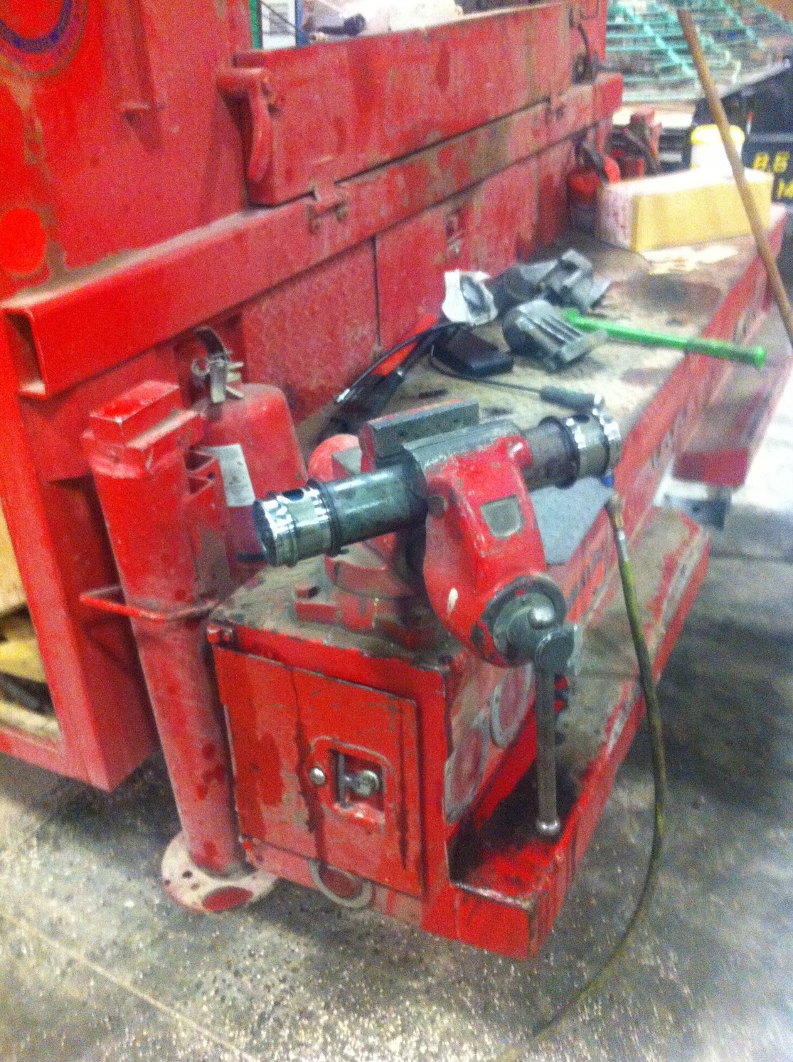

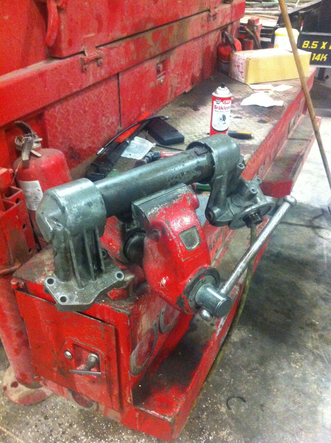

The oil cooler was leaking so I rebuilt it
Cleaned up ready to go back together

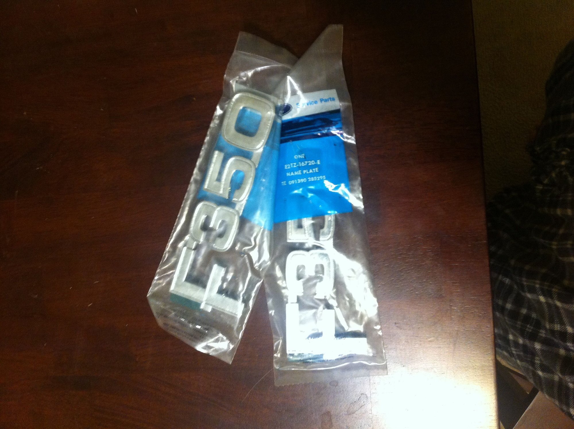

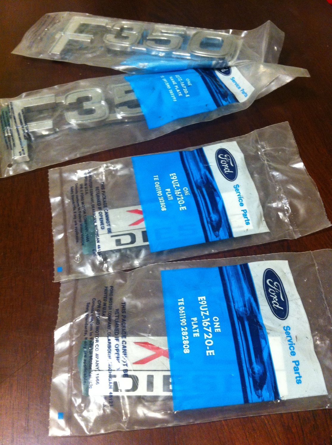

Scored some NOS emblems for the fenders

Nice work! Will you be getting a bed for it, or keeping the flatbed?

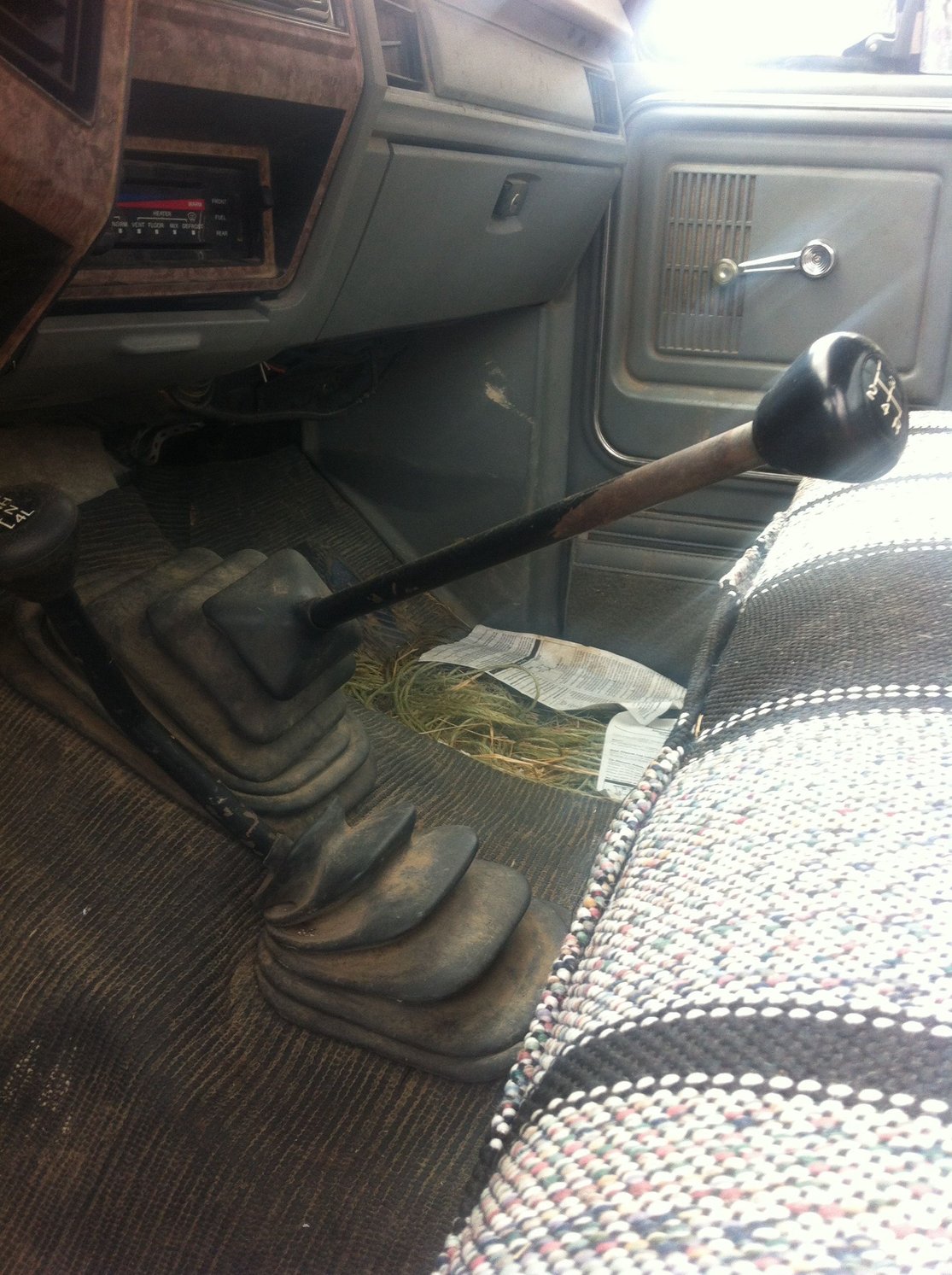

What transmission do you have? They came with a T19 4 speed, no overdrive. People do swap in 5 speed zf's and they do have overdrive 5th.

I agree. Get rid of the Non over Drive T19 and put in a ZF5. You will thank us later
I've got a bed off of an '85...went to Tulsa OK from central Mo to get it lol
I've been told its a 4spd overdrive,it has a strait shifter unlike the "s" shifter.I also have a sale's book from the 1986 model year and they list a 4spd,4spd o/d and C6 as tranny options.

Here's the ****er

Originally Posted by Dirtboy953b
Here's the ****er
You were LIED to. NO OVERDRIVE. That is a cast iron trans and they were straight 4 speeds with NO OVERDRIVE.
The T19 was used behind the diesel and 460. It has a PTO plate on both sides of the trans(yours is a T19)
There were 2 OD trans available in those years and both were aluminum and were only available in a 1/2 ton. A diesel would blow them up in about 1 day
