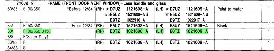

The actual metal itself, it's starting the rust oddly. I didn't know they were replaceable, but according the LMC, they are:

Yes, they are. But the one you listed is for 87-91.

Would those not work?

I don't know. They show the vent window seals go 80 - 86 and then another for 87 - 91. But they show the same glass fitting both. And they don't list a frame for 80 - 86. So, I would call them before ordering.
Having said that, this shot from the catalog seems to say that the same one fits 80 - 89 as this catalog goes across that timeframe and "80/" is supposed to mean "from 80 to end of catalog". So, the ones you listed should fit.
