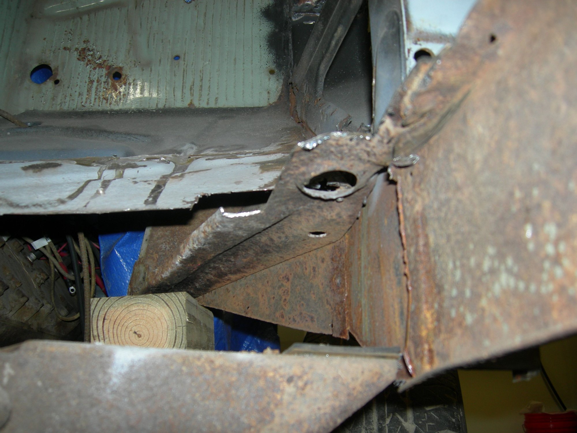

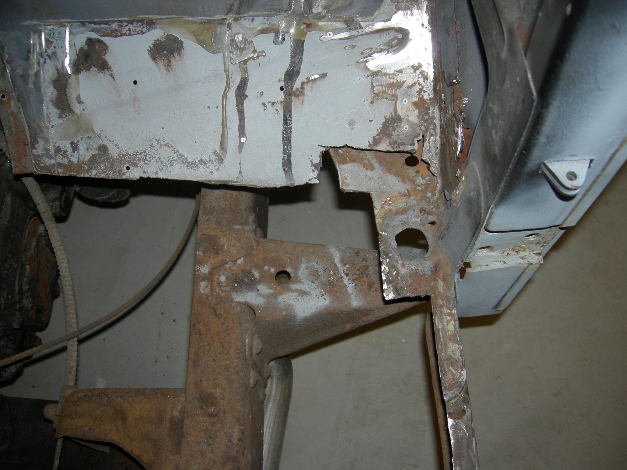

Originally Posted by jonf
Do the patch panels for this go under the toe board and become the front mounting hole to the frame?
I'm not sure what year your truck is (suggest that you add that info to your signature) but here are some pictures of my '50 F2 before I put in the new floorpan. Note that there is another structural piece that goes under the toeboard. Ross is correct, the piece that Stu showed you from Chuck's Trucks goes over top of the floorpan and should be welded into the side panel structure along with the floorpan.
