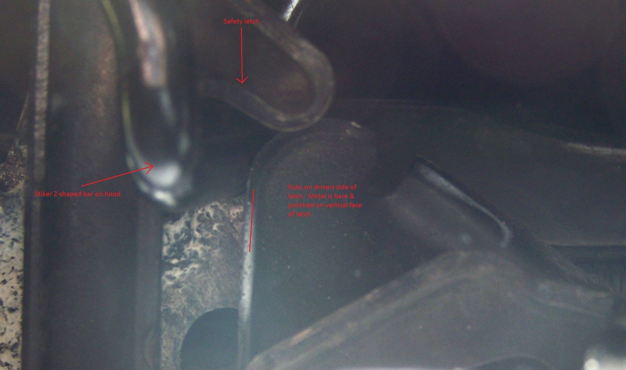

It seems like the "striker" (z-shaped heavy wire/bar attached to the hood) is hitting one side of the latch (I can see it with the hood cracked open, and see the bare, shiny metal on one side of the latch) but I can't figure out how to adjust it. The latch moves up/down but not side-to-side and the striker doesn't move at all.
I've screw'd with the latch a couple times and didn't improve it at all. I tried turning the z-shaped bar around on the hood but it's too well made I guess... it fits the same both ways. I tried bending the "u-shaped" loop that goes into the latch in a vise but it didn't really bend.

Old Dec 9, 2014 | 04:47 PM
David - WI's Avatar
David - WI
Joined: Aug 2014
Posts: 138

I did manage to go from a "dead" feeling cable (no "pop" when you pull the lever) to a distinct "pop" from the latch by putting a couple small washers under one side of the z-shaped striker on the hood last night... but the hood still does not jump up out of the latch into the safety latch the way it should.
