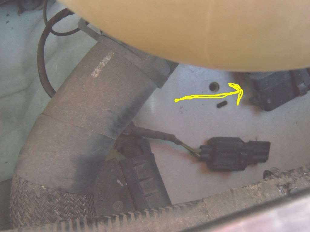

The only way to swap out or add in factory CC along with the steering wheel controls is first determining if the "new" chassis/body has the necessary wiring. If it doesn't then you're mostly SOL.
There will be a flat 10 pin plug (brown or black) clipped to the left (drivers) side inner fender. Look under the battery junction box, master cylinder and coolant reservoir for this:

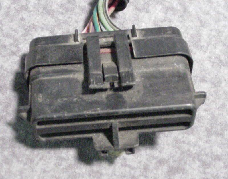

This is a more close view of the plug:
Without it abandon hope for adding factory CC----trust me on this---been there, did NOT do that!
BTW the other connector below this is a secondary CC cancel switch connector----it does NOT have to be there for factory CC to work IF the other plug is installed.
