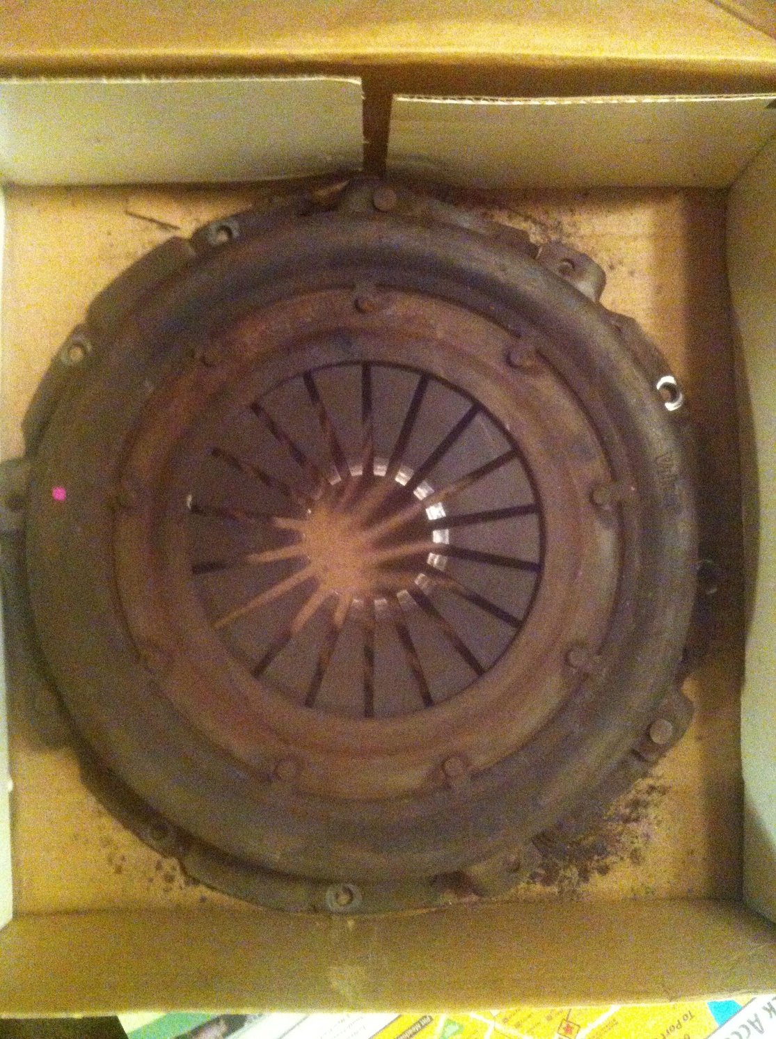

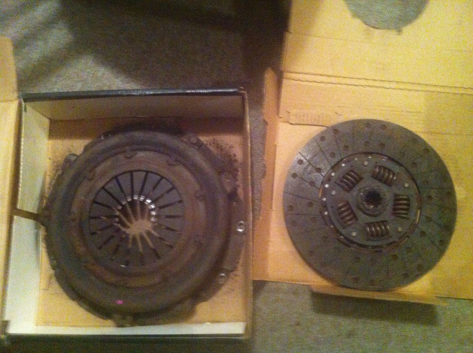

Just found a slightly used clutch. Next to no wear.
Its from a 1985 f250 6.9L. On summit racing many clutches fit the 6.9 300 302 351 460 etc. does anyone have the boltup pattern for a 351w 164 tooth flywheel so I can check if the bolt pattern will fit? Its off a t19 trans and has a 10 spline input with 1 1/16 inpt shaft the same as the ZF. Its an 11" clutch. Is there any reason this wont work if the flywheel has the same bolt pattern as the pressure plate.
Worth a try. If it doesn't work I am sure someone on here can use it.

As long as you have the dual pattern flywheel, it'll be fine. Both trans should be the 1 1/16" ten spline, but put the disc on the shaft first to make sure it is right.
