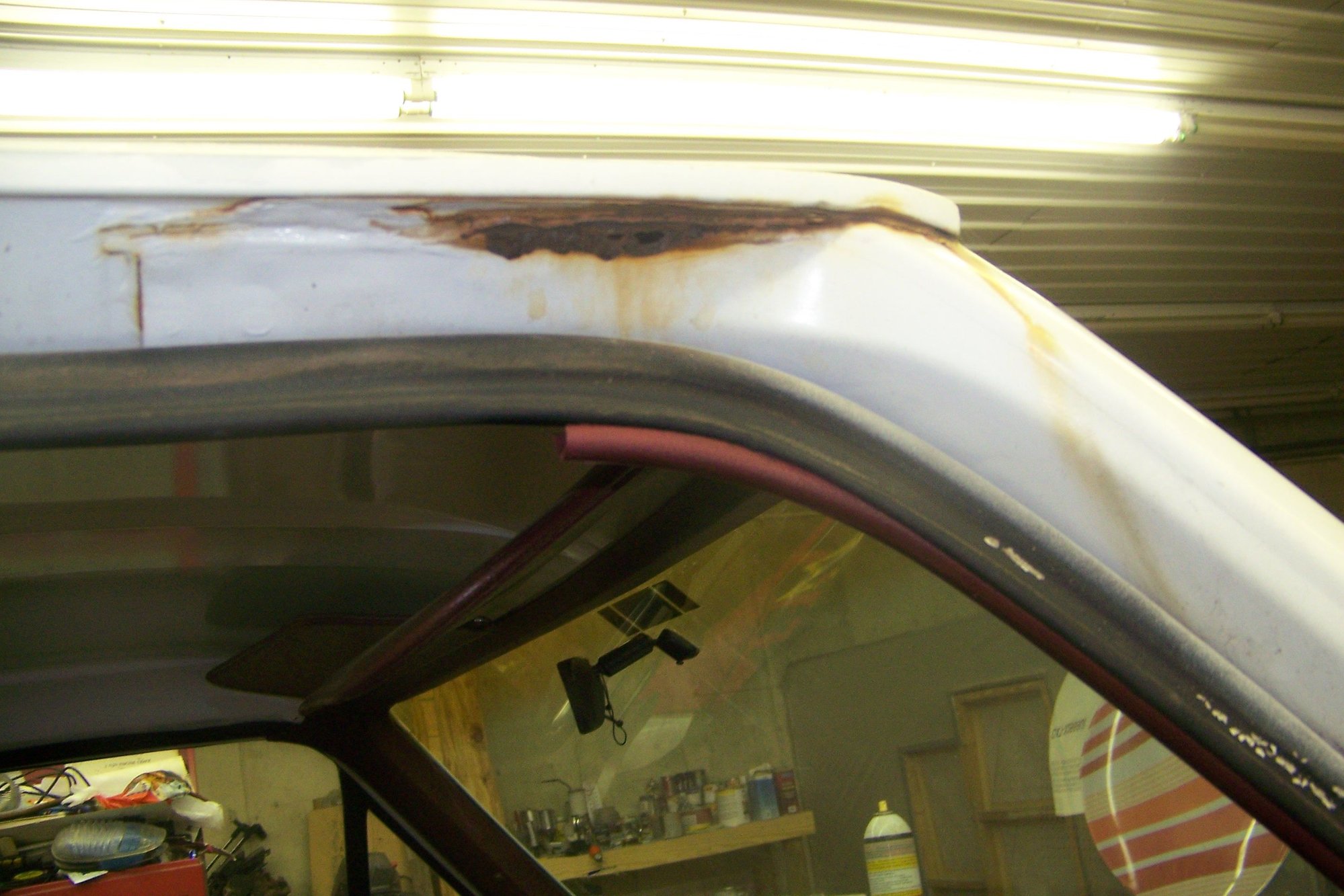

OK, so I have been going through many threads, some very long. I bought this 80 swb a few months ago with a bad motor and having a good motor on hand I thought I would swap and flip this truck. I have always liked this body style so i started thinking about keeping it. I notice a few things though.
1. The cab looks to be rusting from the inside out right above both doors. I thought it was just mine but I have seen it on 2 other trucks in pics on this forum. Is it from the inside out? Has anybody dealt with this? My experience with rust is when it is from the inside out on something double walled like this is that you are just prolonging the inevitable, so I might think about changing cabs.

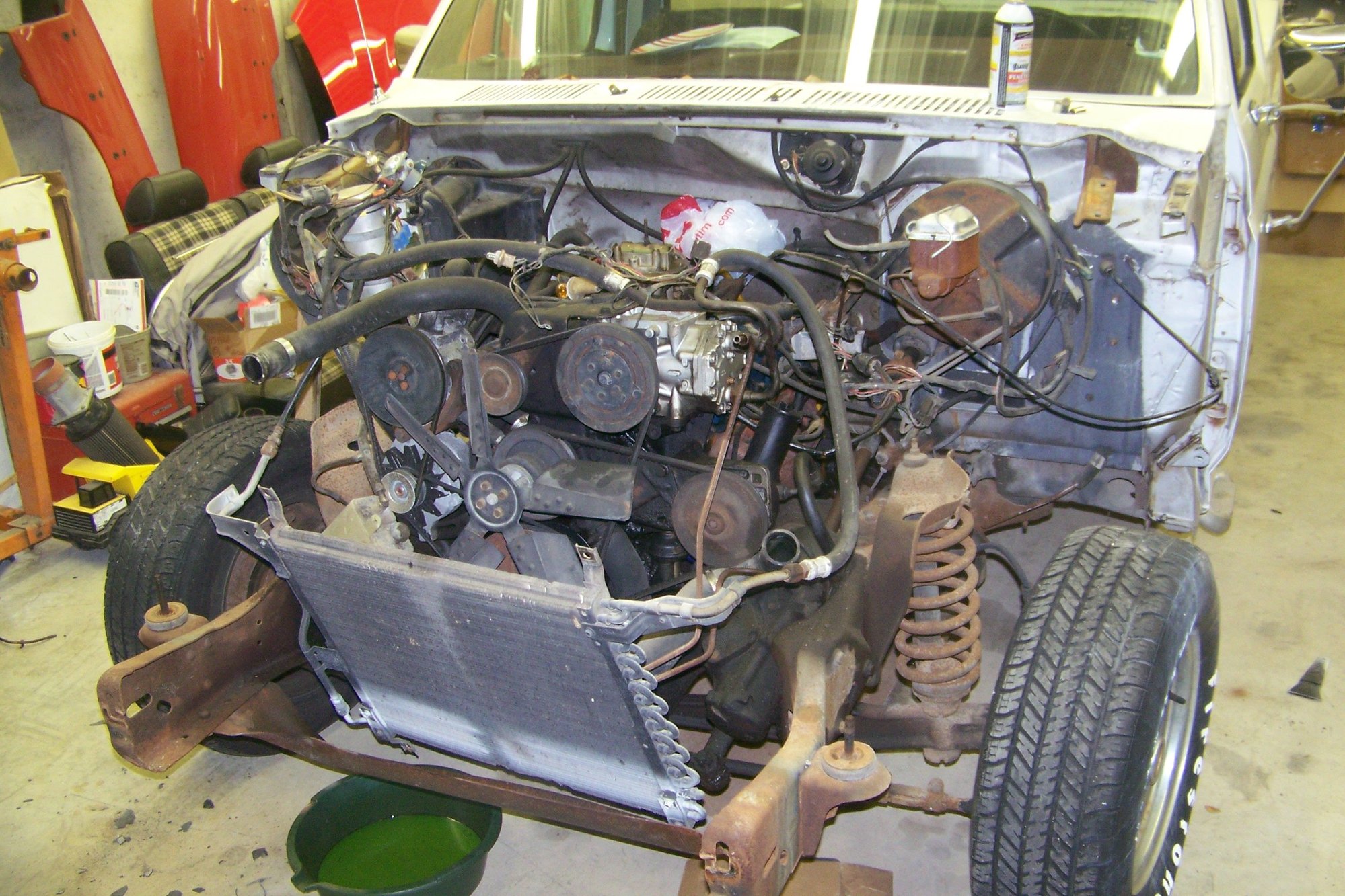

Anyways, I will have more to ponder and I can add pics if anyone is interested in seeing. I just got the complete front end taken off the truck tonight so I could pull the motor and trans together easily(that's what I told the wife), and I could look over the truck better to determine to keep or not to keep. Looks like it was originally silver. The besides, inner & outer are in great shape(no rust) but the floor has a couple rot places, not big.

I don't understand where the rust problem is? From your description it's in the roof above the doors? Not a common area for rust that I have ever seen. All the common areas for rust are down low in the bottom part of the cab and the doors. You can get patch panels for all the common rust areas, including the bottom part of the doors.
I would consider patching the cab if possible. You will run into VIN and title problems with a new cab, unless you get a title with the new cab. Even then, the VIN may not match your original trucks specs if that's important to you.

When I get home I will take a pic of the rust to show you. The truck that Kyle's dad off Craigslist has the same rust maybe not as but I could see it in the pic. I'm on my phone right now so I can't attach a link.

The rust may not look bad in the pics there are through holes on both sides. My cab corners have a little bubbling but I've replaced cab corners in the past and that doesn't worry me. This is the state of the engine change right now. All screws have been logged and packaged as I went along.

Is that where water got behind the seam sealer? I never had that on any of my trucks. But if that's what caused it, I would dig all the old seamer sealer out, get a wire wheel on a drill and clean up the rust, and then paint it and put new sealer in place. If the hole is too big for the sealer to cover, put a little bit of that green fiberglass bondo over it and then paint and seam sealer.
That should be a easy fix, and the repair won't show, it's behind the door. Rust only happens where water sits for a long time. That's down low in the cab and I am guessing it sat behind the seam sealer on that truck. That's why I think a quicky repair would work, water will not be sitting up there if you re-seal it.
Check the seam that shows from the back corner of the door that goes around to the back window on both sides. That seam sealer sometimes cracks and that's what can rust the cab corners out.
