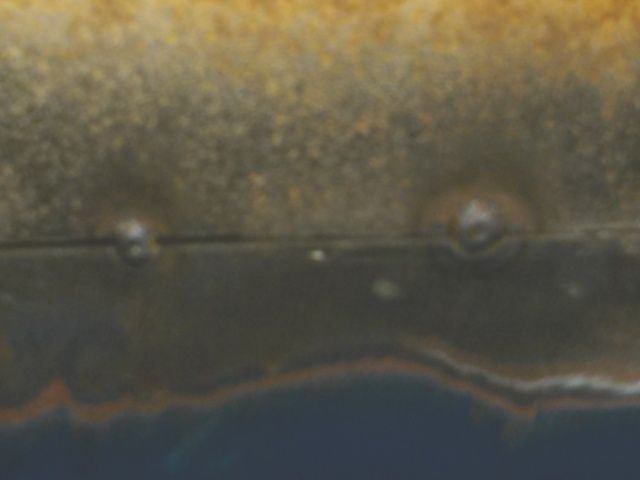

I am not disagreeing that I am not getting a proper weld. I have not experienced anything like this which is why I posed the question to an experienced professional welder such as yourself.
While I am not a professional welder, I have spent every weekend for the last 10 years or so doing it in my shop as a hobby. I have read your thread, not because I felt I needed to, but because I thought maybe there were some things in there I could pick up. Through trial and error, I have the best results with .030 wire and slight gap between my panels (Typically .045", the thickness of a cutoff wheel). The areas are prepped with a 50 grit bristle disc, and then edges knocked down with a 2" 80 grit flap disc.
Here you can see the initial ground down area after welding, this picture shows the pits (left from blasting, the P/O didn't have a clue), they are deep and the skin wavy the trucks skins are all a wavy mess. I am afraid to grind much more off or they will be thin. I figure a good coat of high build primer and they will even out. I will take care of the waviness through hammer dolly/slapper, and a shrinking disc.
Here is the outer skin of the opposite door, no issues................
And a close up of the same tack (the left one above) of the inner...............
Look just as the ones you posted above? No?
The only difference I can see, is the left door apparently had a thinner coat of primer? Didn't get as deep in the pits?
I am not sure what the answer is.............

You know sitting here looking at what I just posted, I may have just answered my question.... I didn't clean the back sides of the panels (something I typically do on more accessible areas.....

CV, What I meant maybe didn't translate. I do things completely differently than you, wire diameter, panel gap, etc, so if you find that you are sucessful and happy with your way, good, If you don't want to change, learn a different way, then if you have a problem, I have no experience with the way you are doing things, then I can't help you, any more than I can help with a problem on a Mac computer operating system when I work in windows on a PC. What I do know of the physics, chemistry, metallurgy involved in welding, I cannot agree you are getting a true weld but are filling a long narrow hole with filler wire. Since sheet metal is not structural, I guess it might be strong enough, but I wouldn't be surprised if you have some cracking along the seams later. My spots are smaller, don't usually have a crater in the center, my heat affected zone is darker around the welds.
