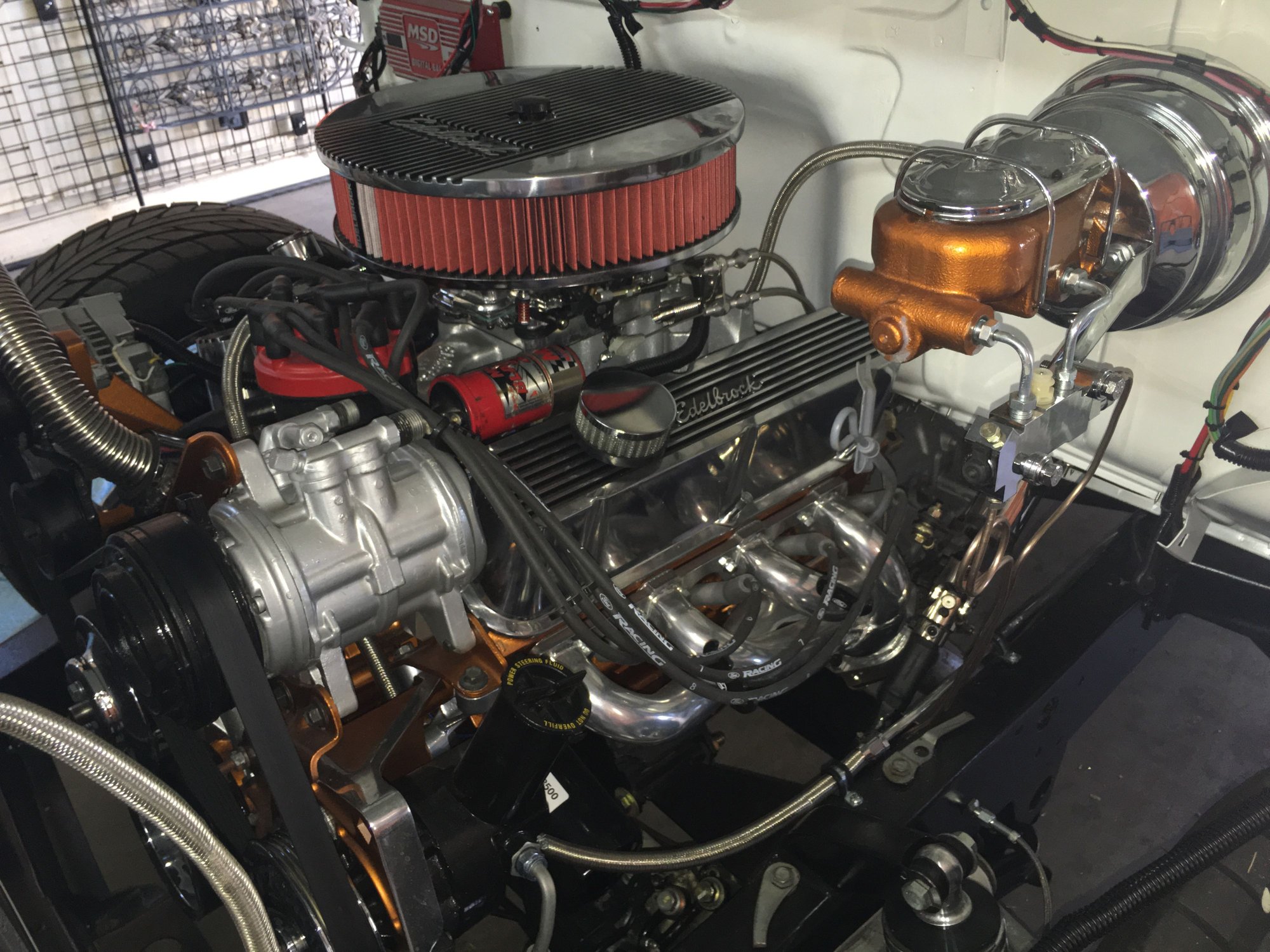

Hey there, just checking in to see how your build is goin? I got the call today from the machine shop that my motor is ready for pick up. Getting ready to put it together. Any tips or ideas on motor and transmission mounts? By the way what length coil overs did you use on the front end or how did you determine the length to use?
I can get a few pics for you. I used factory ford rubber mounts to the block and made my own from the block to the frame. The trans mount was just a standard universal c-4 c-6 AOD crossmember and rubber factory mount. Coil overs are double adjustable / dampened QA1's with 9 inch 500 lb springs. Might have to go up another 50 lb on springs but won't know till I get some miles on her.

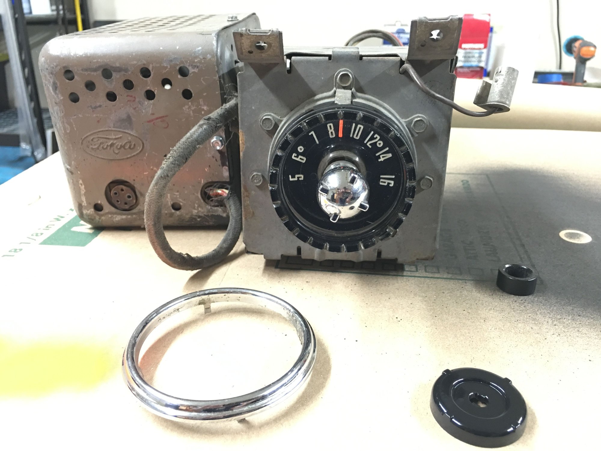

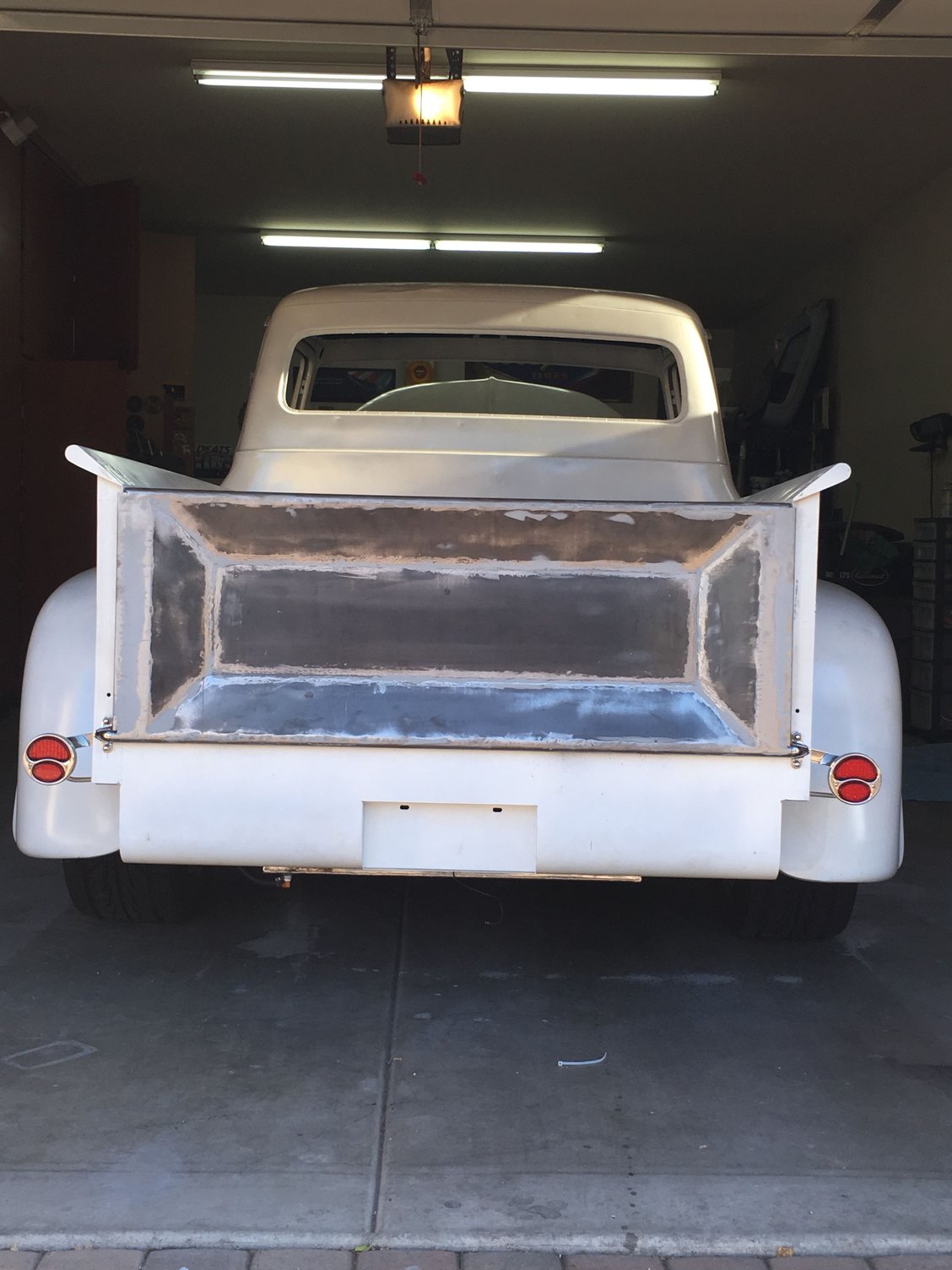

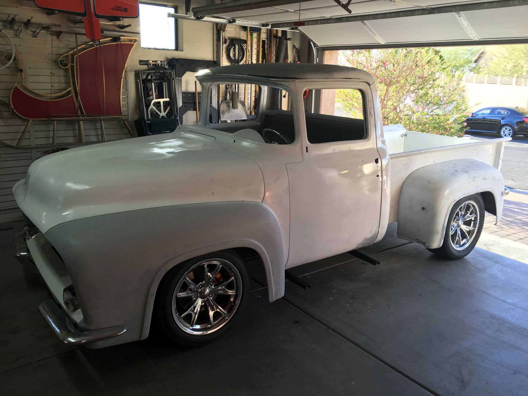

Here is a few of the latest ones
Originally Posted by Evansdad
Thats cool, so you've got it on the road. Would love to see some fresh pics of that ride. Thanks for the info and Happy Cruizin!
Still need the bumpers on.
Starting bodywork
Radio ready to go in..

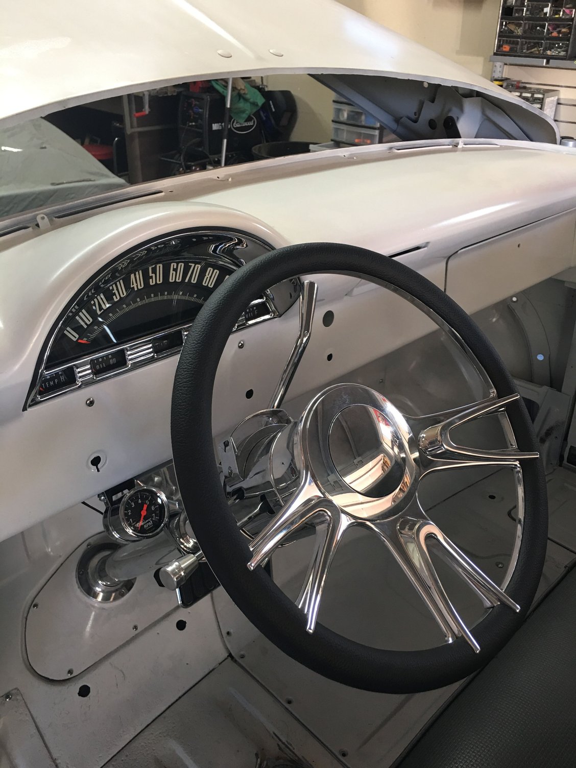

I am doing this same set up. What did you use to connect the steering column to the Lexus steering?
Old Apr 11, 2016 | 10:51 AM
cdl2374's Avatar
cdl2374
Joined: Jun 2013
Posts: 188
I cut the splines off the end of the factory connection to the rack, then just used a 3/4 DD connector , a short piece of DD shaft and connected it to my flaming river column with the standard 3/4 x 1 DD connector. It's almost perfectly straight.super easy.

Old Apr 11, 2016 | 11:09 AM
cdl2374's Avatar
cdl2374
Joined: Jun 2013
Posts: 188
The photo shows the latest connection eliminated the lower one and just used the Lexus joint and the upper 1 x 3/4 to connect to the column . I had forgotten I had updated it.
