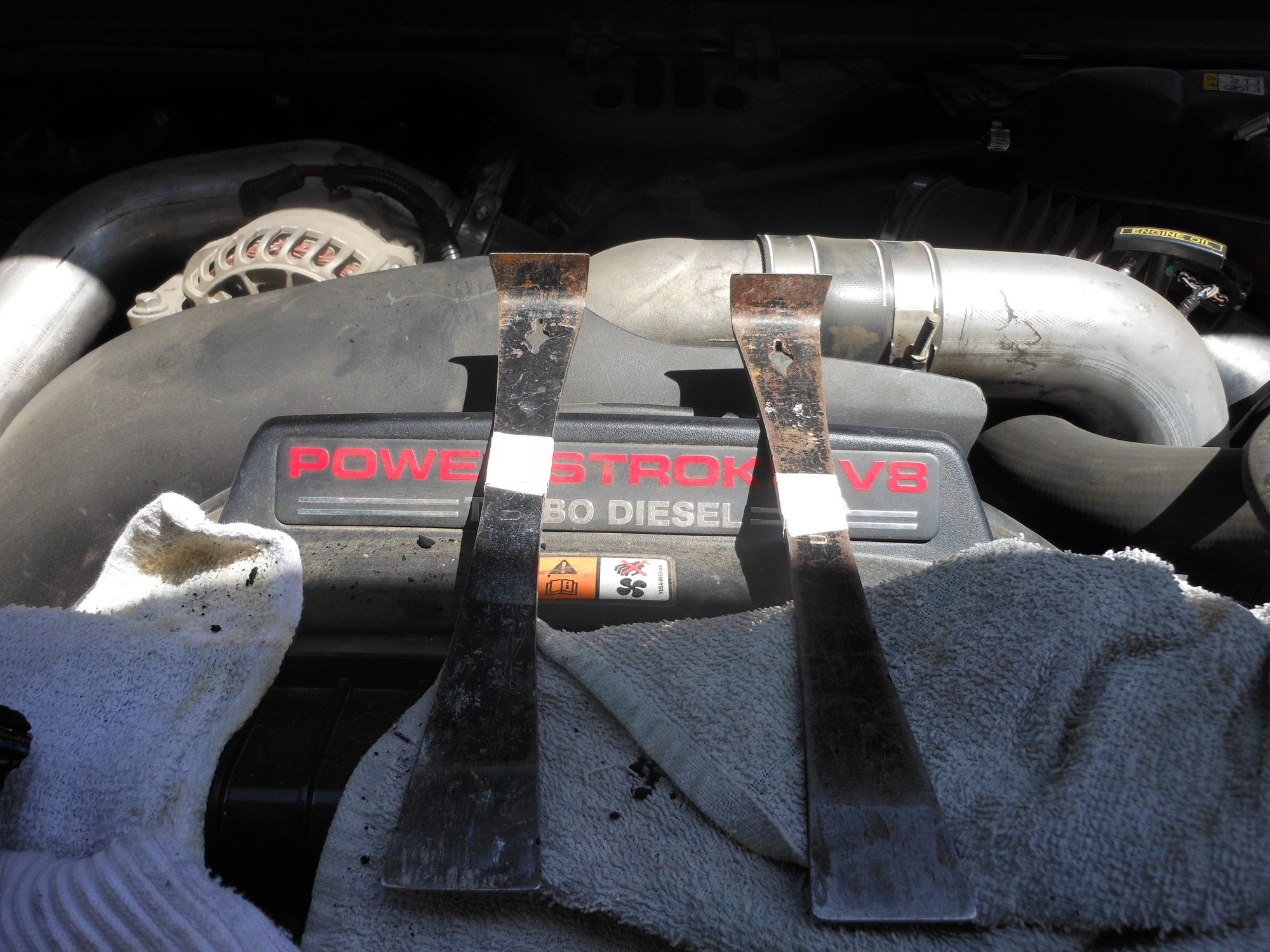

These are the flat bar's I use , it seems to help pop the valve upward , you should really get new O-rings If you haven replaced them.
I like those-- not sure if I could get em in place. Cant get the intake tube off--but I do have the small pry bars. I do have the orings and gasket--got em when I bought the tstat. I'll have to wait on the cleaning now til the week of Thanksgiving

OH yea they fit in perfect once you turn counter clock wise you get the bar under the tabs pop up no need to take anything off , I do remember that the bolt closer to t-stat 1 on the right was a little longer , just a heads up .
