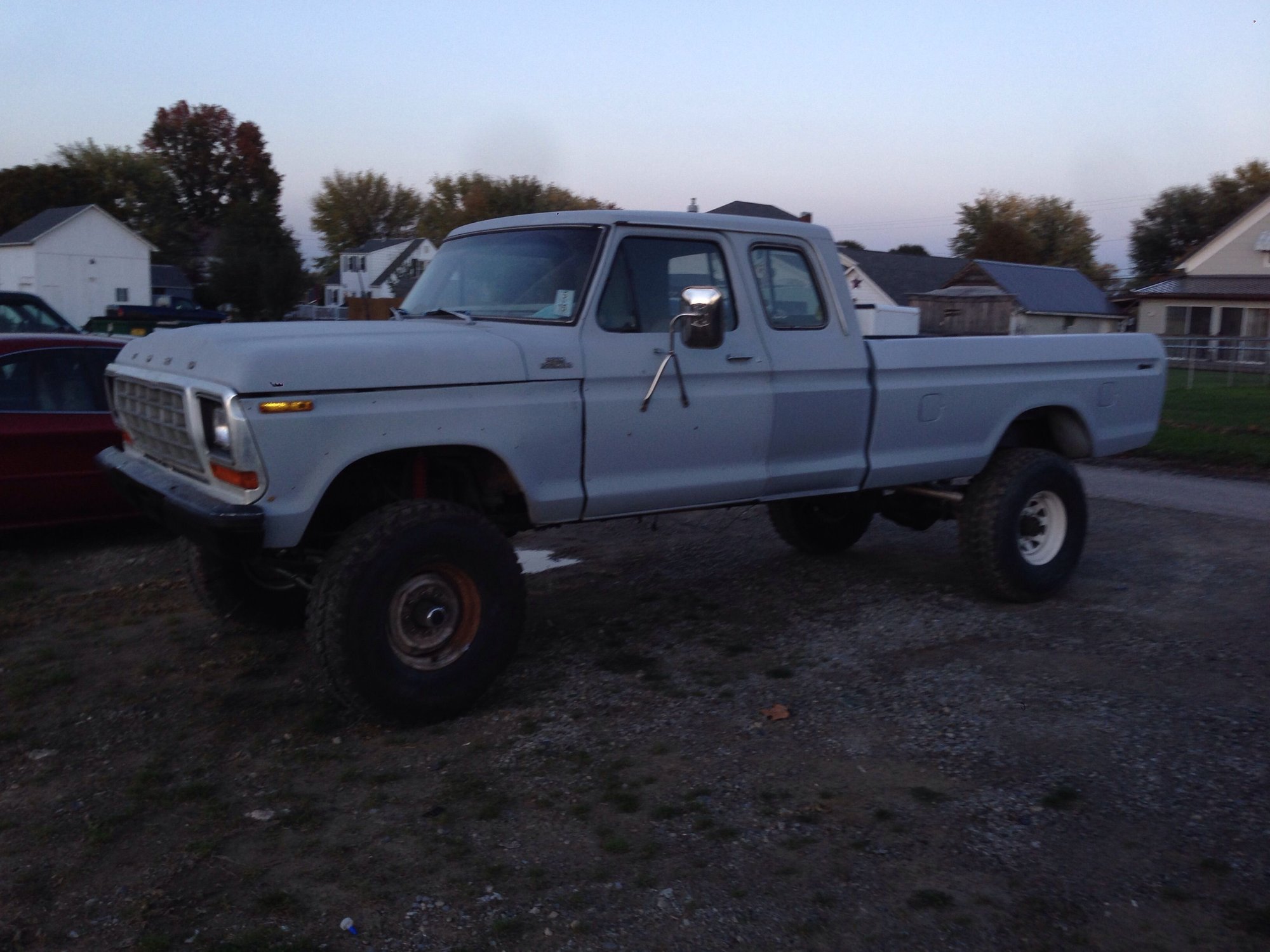

Does anyone have some pictures of a 78 f250 with either a 4 or 6 inch lift? Also would like to know the tire size that you are running. Trying to plan some springs out. Thanks

This is my 78 f250 with a 6 inch skyjacker lift and 37 inch military tires. No rubbing when steering at all.

That looks awesome. Can 39 inch military michelins clear on a 4 inch lift, is anyone running something close to that? The measure out at 37.5 tall.

Blue 78 (swapped round headlights for square) with a Rough Country 4" and 35's. I bet I could off road the tires into the front fenders.
Red 79 with a Skyjacker 6" (front and rear springs, but still use the OEM rear block) and mil take off 36's and then 35's.
I'd guess room for 38's or 39's? And I bet with a little front edge fender trim for 40's?
I would say no on the 4" and clearing 40's, unless you seriously trim the fenders.
Go 6" and then maybe a fender trim or a 1" or 2" body lift?

1978 F250 with the skyjacker 6" lift (new springs all around), on 38.5x16" TSLs

my 78 F250 with 6" lift and 35's ( no drive train yet )
