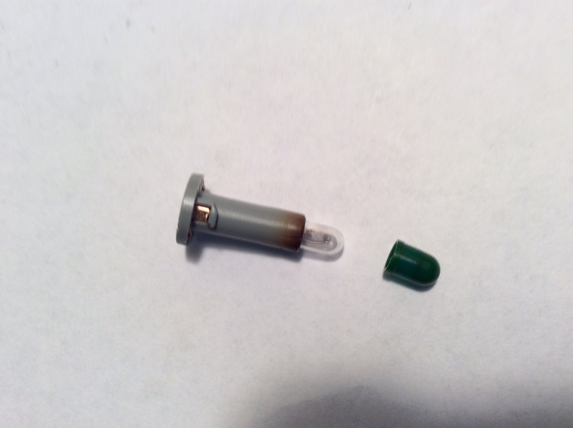

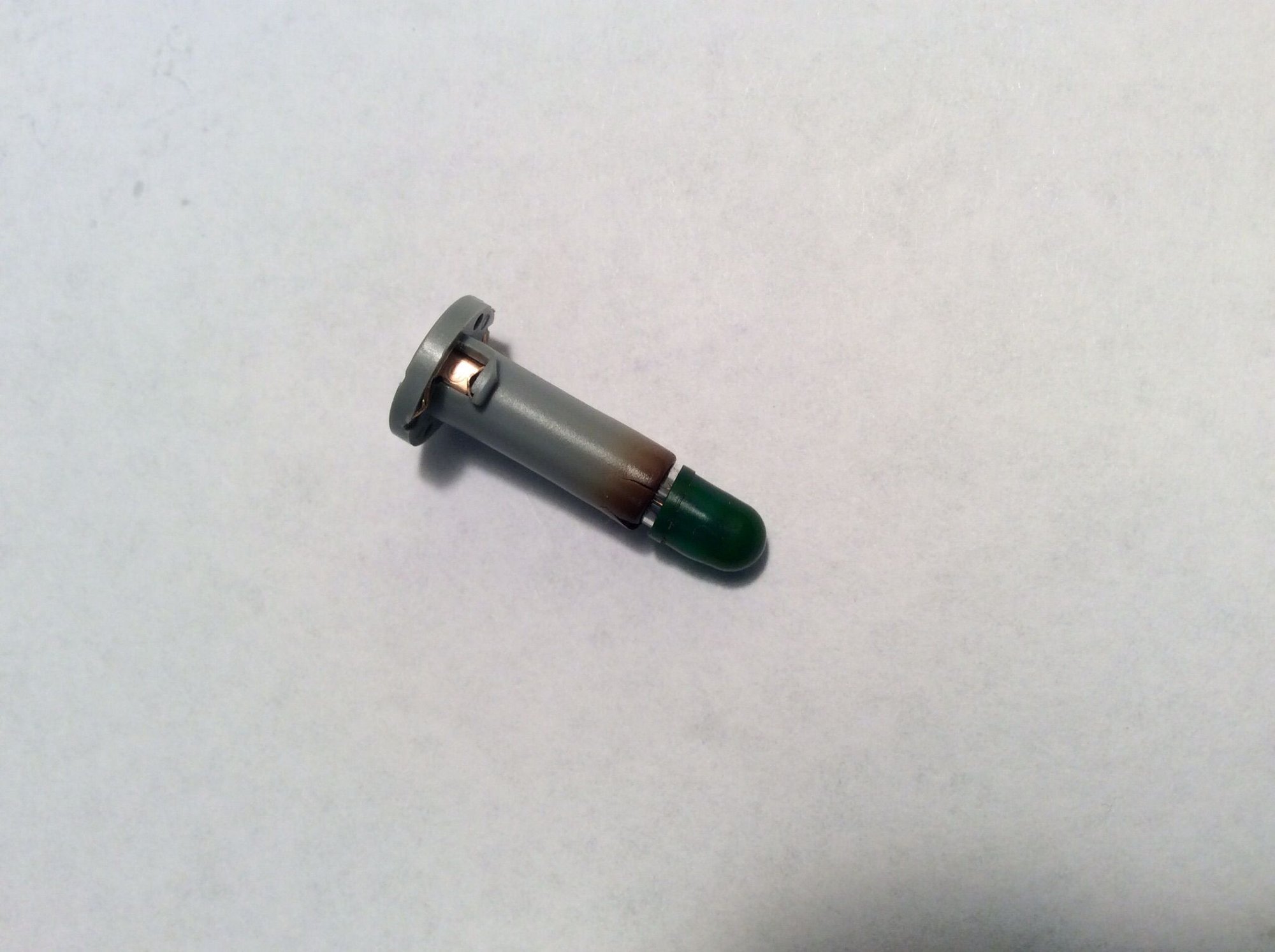

Nope, it's an incandescent bulb. Here are some pics to help. Basically the assembly twists and falls out the back of the switch. The green rubber goes over the end of the bulb for coloring.

"Part Description: W/ ESOF; Green illumination, 3-position switch, bulb not serviced separately." $69
So, I would take that somewhere or try to get a part number off of it. An Auto parts store should have something that would work with a little ingenuity.

T4 or T5
Should be a T4 or T5 bulb in there. Thats what my 1995 bronco has in the switches. And going to check my truck now. I put blue T4s in the bronco and it looks great.
