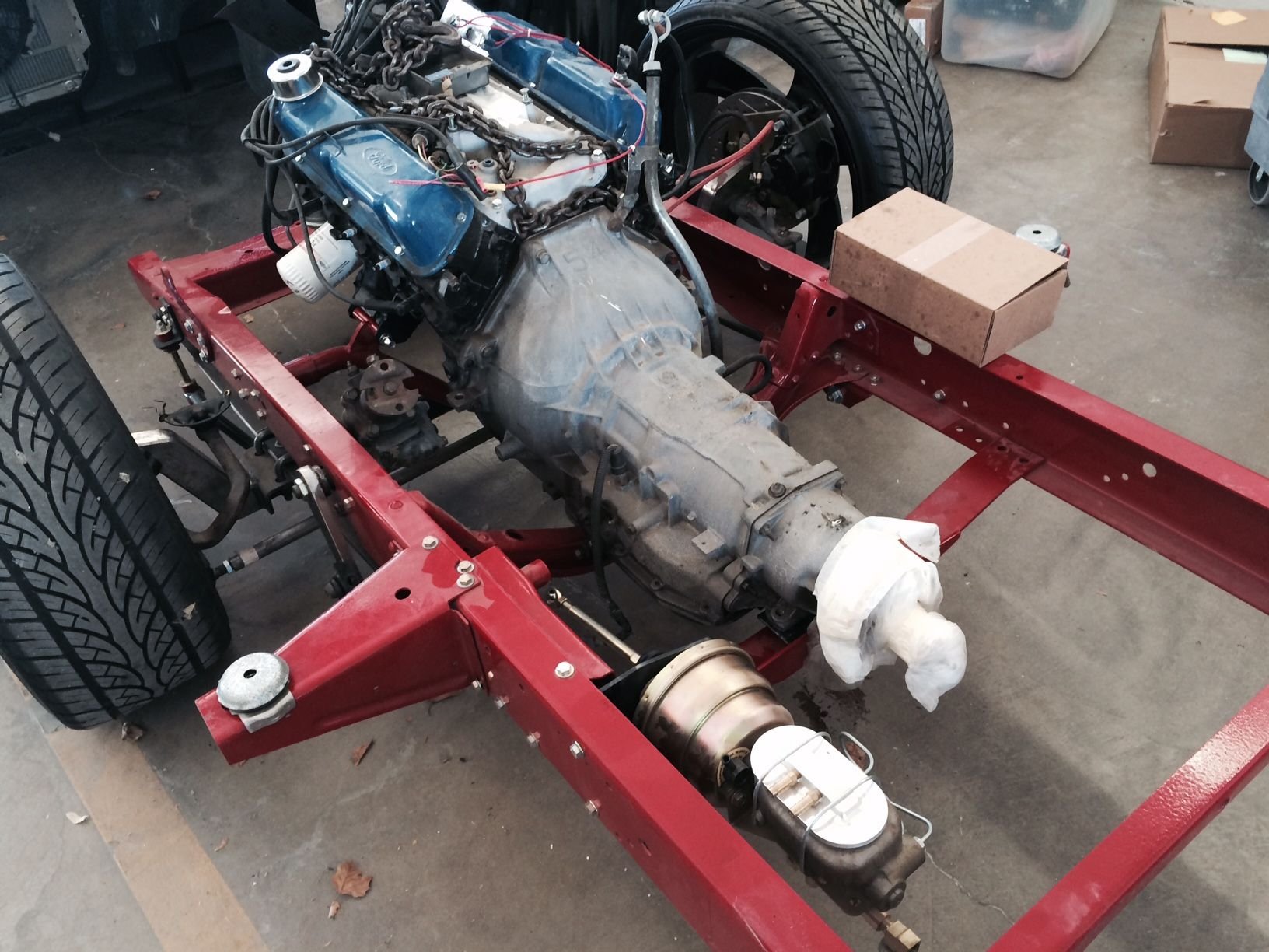

Skip forward about a year or two to today, and here is what we have so far
Its been sitting around collecting dust for a while now, but recently we started working on it again

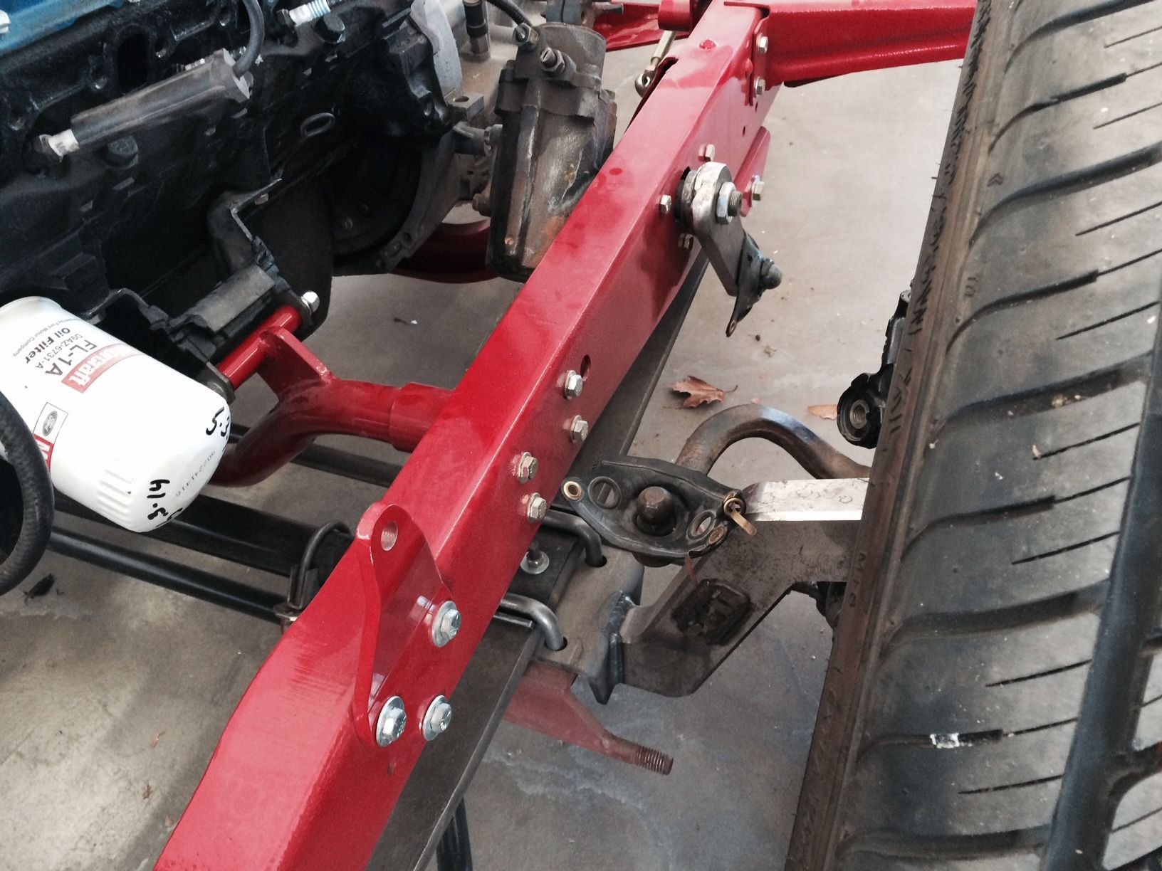

All new front and rear suspension
Front disc brakes, rear coming soon

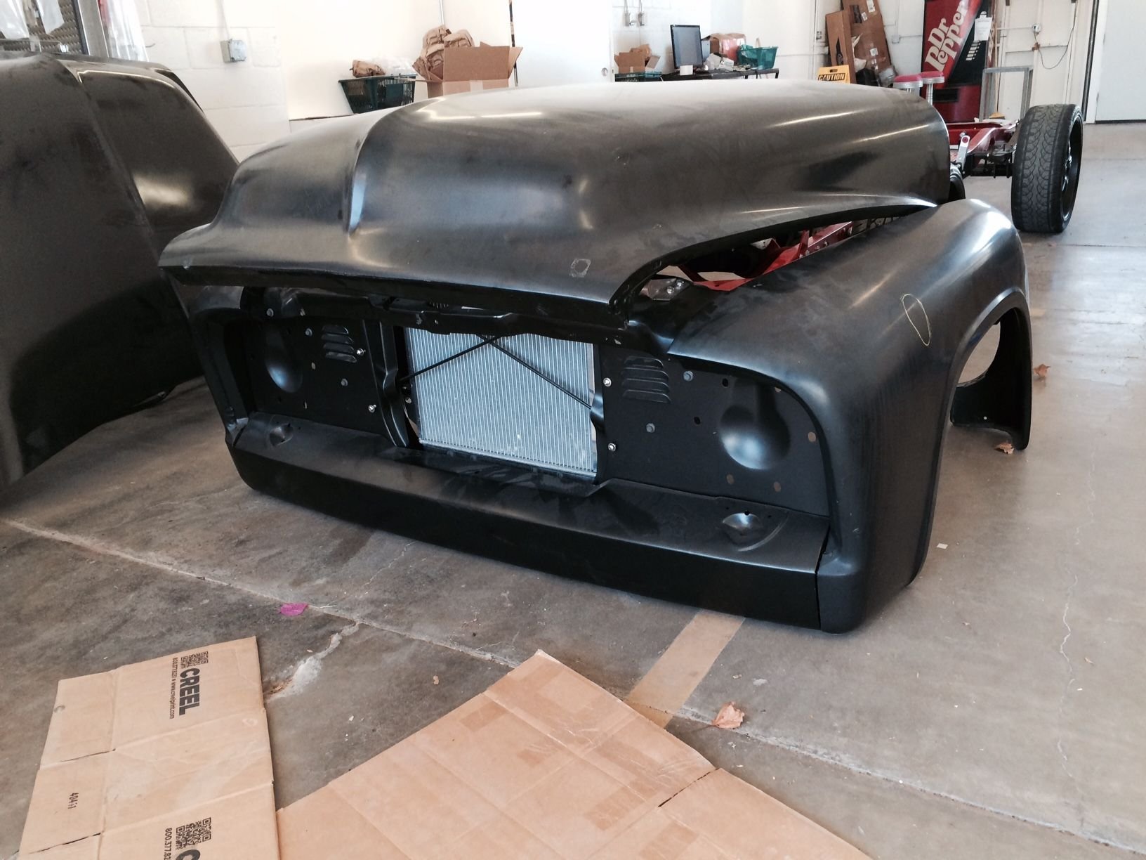

New front clip pieces, well actually most of it is scratch n' dent parts
Polished stock style radiator
Tilt hood kit
Toyota power steering
Underbed gas tank
And bunch of other stuff, please ask if you have any questions

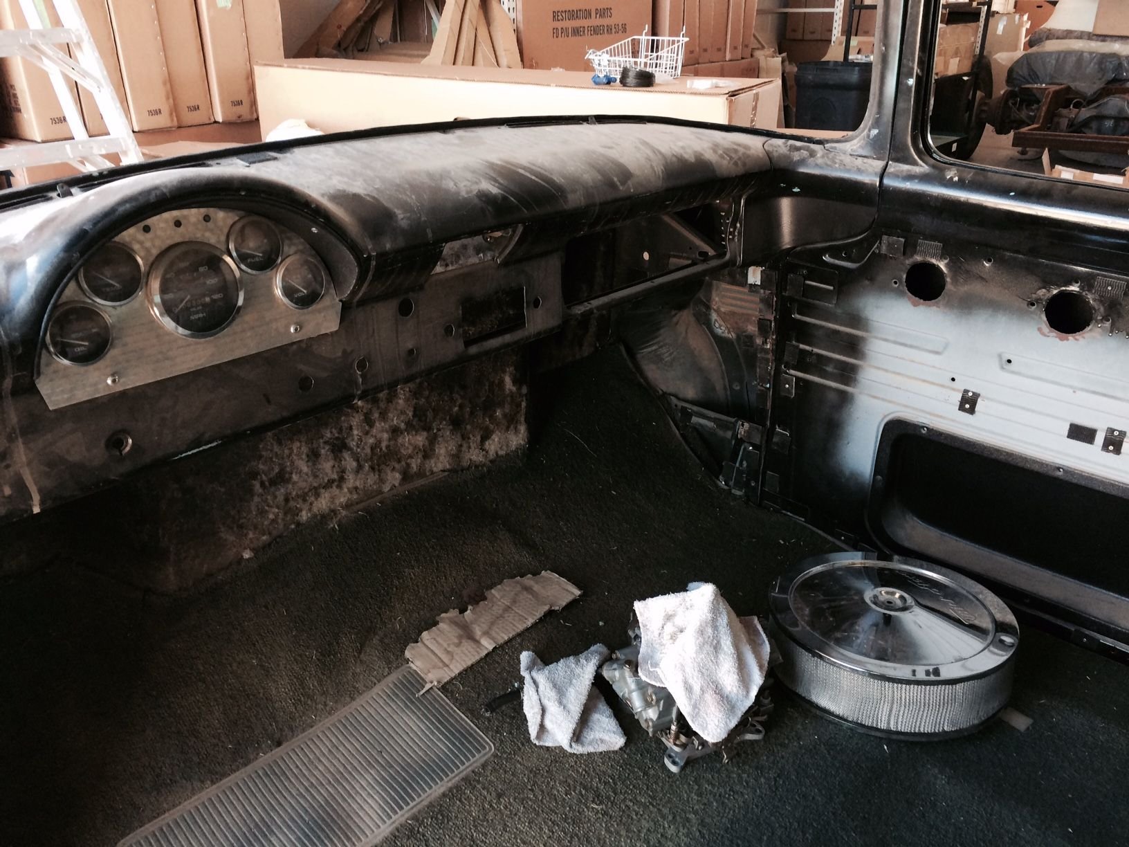

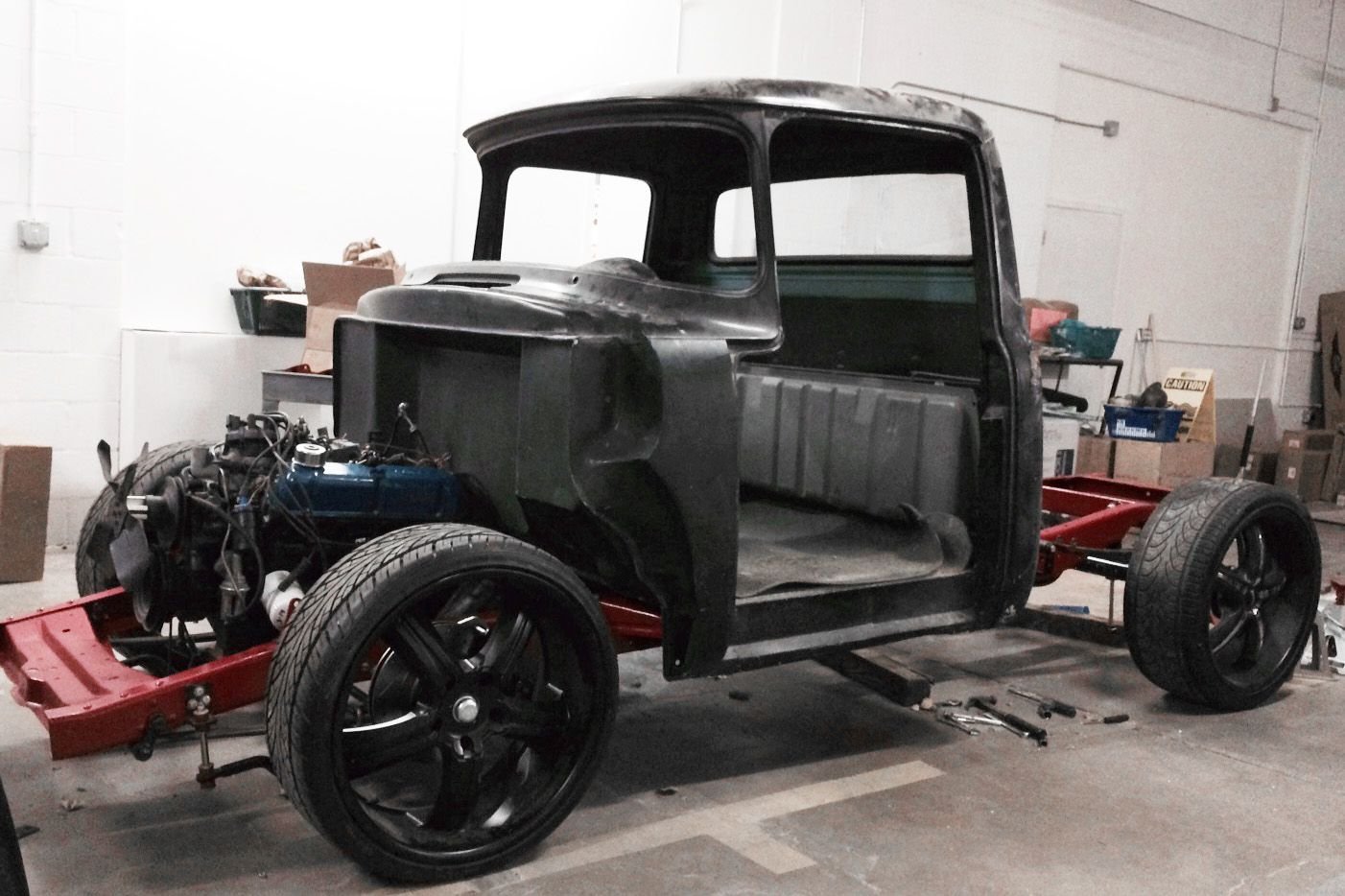

We removed the 53-55 cab that was originally on it and are going to replace it with a 56 cab that is in much better condition
While the cab is off we put a small block in it that came off a panel truck we had laying around.

Looks like they put the cab on after I left yesterday

A question on your front suspension. In the two pics of the front spring shackles, it looks like the springs are flexed out to the point the shackles are all the way forward and the spring eyes are resting on the frame. Is it just my eyes because it looks like they won't flex like that.
Just went out and jumped on it as hard as I could, the shackles don't touch the frame when flexing, the middle of the leaf spring is going to hit the frame before anything else, gotta have them put in a bump stop

They got the front clip back on the new cab
