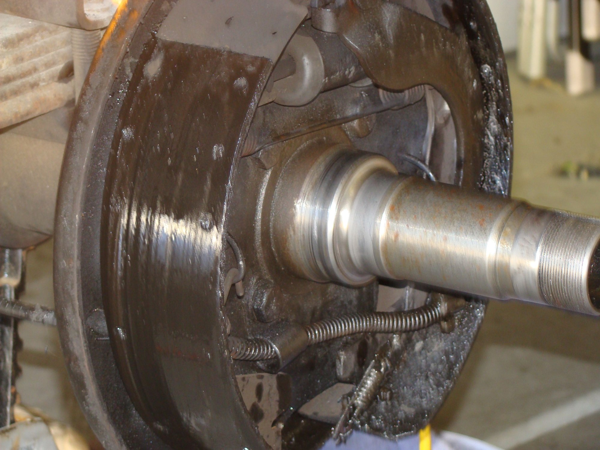

If either side looks like this, you're boned. Time for new brakes.

Chris, we're in the middle of doing the brakes on my moms car. Both sides had leaking wheel cylinders, the right rear looked like that!

Quaker,
If you have the 10.25 be sure to get the upgraded two piece hub seals.
Then there's no problem with scoring.
My brakes looked like that when the seal went bad a three years ago.
