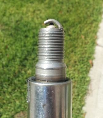

Well, I think I'm screwed... I pulled the plug and found this.
My assumption is that the insert went in too far. I pulled the fuel pump fuse and cranked and didn't hear metal-to-metal, so I don't think it's a lost cause yet. However, I need to figure out a way to keep the plug from going in too far. When I tried reinstalling it and just not torquing down as tightly, the engine sounded worse. Thinking a washer with an OD slightly smaller than the unthreaded recessed hole in the head that leads to the threaded portion. Then the plug should bottom out against the portion of cylinder head that isn't the OD of the insert, which would keep it from continuing to push the insert further in.
It's either that, or use loctite on the old spark plug, reinstall it and hope the insert can be removed. I used hi-temp RTV on the Helicoil per the instructions, rather than loctite as I had read in some posts online, so that's the only reason I think this option might work.
Opinions on best way to get myself out of this jam?

Bummer, time to pull the head.

do the head swap before it gets messed up worse.

... and hope you didn't damage the piston.....

Got it!
Successfully removed insert this morning... doesn't look too bad. Piston touched one edge of it (maybe a quarter inch of the circumference about one thread's width).
Sorry for the oversize picture but my phone won't let me resize it.
