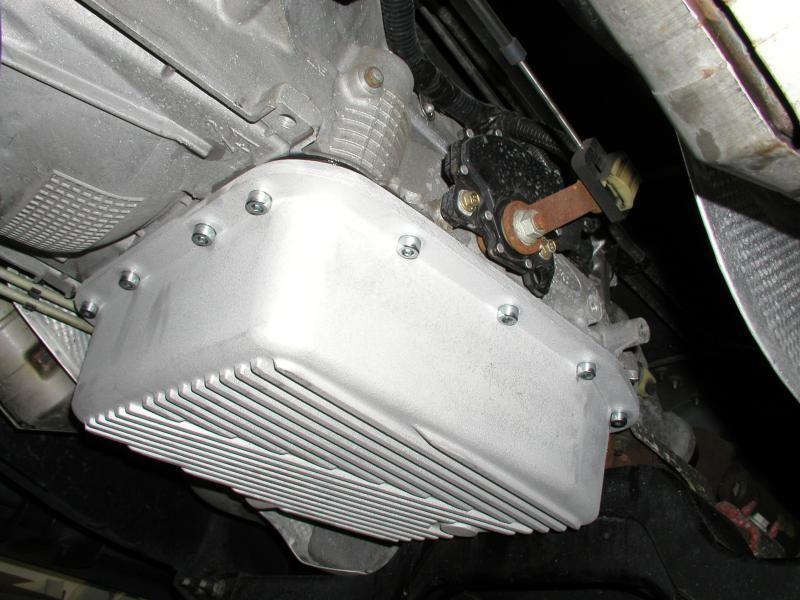

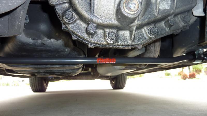

On my Expy I added a PML deep tranny pan that added a gallon to the tranny fluid capacity as well as an inline Magnefine filter in the return line. Along with a Autometer Cobalt series trans temp gauge to keep an eye on things. Under normal towing of my 5k lb. boat it never gets above 180 down here in south Florida. If you're towing through hills you may see higher. The temperature sensor installs in a boss area there in the side of the pan. You have to drill and tap it. If you're still using P-series tires make sure they are the 44 psi type, not the light duty 35 psi crap that Costco and Sams try to sell everybody. LT tires are better for towing because they have a thicker sidewall. I replaced the stock station wagon swaybar with a heavy duty Belltech 5550 truck rated swaybar to help stabilize the rearend. I use drilled-slotted rotors up front to help with heavy load stopping. Make sure to check your rear pumpkin for correct fluid level. They do start to seep a little at that age. Not sure what type stereo system you still have in your Expy. But a new Nav system with backup camera is a nice addition as well. The White Night Backup Lights might be over the top though.... LOL.
-Mike
PML tranny pan and Autometer temp gauge....

What the pan looks like under the truck...

Belltech 5550 swaybar vs. stock swaybar....
What it looks like under the truck....
