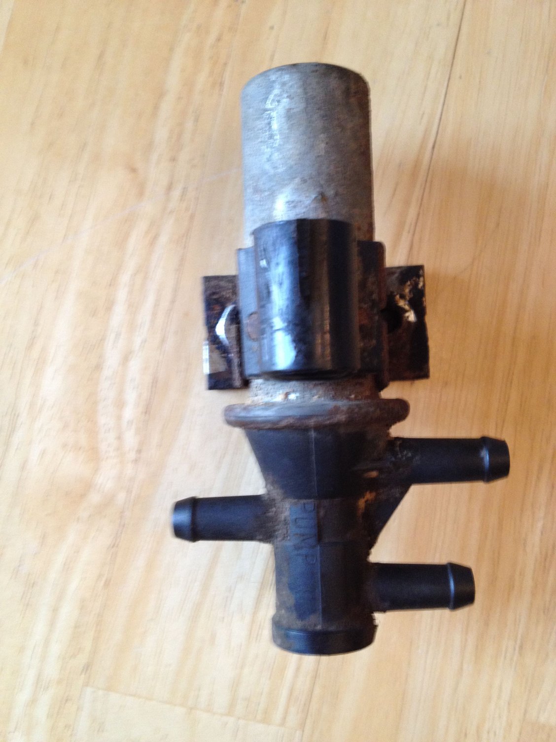

If you want the same as you have with the correct connector, I have a couple of used ones.
Priced between ... make offer and free to a good home.
http://spokane.craigslist.org/pts/4704171086.html

Does it look like this?
Ford F150 1985 86 Fuel Tank Selector Valve 3 Port E5TZ 9189 A Nylon Lines | eBay
I sold my spare on Ebay a while back. That is a hard valve to find. Good luck!
Jim

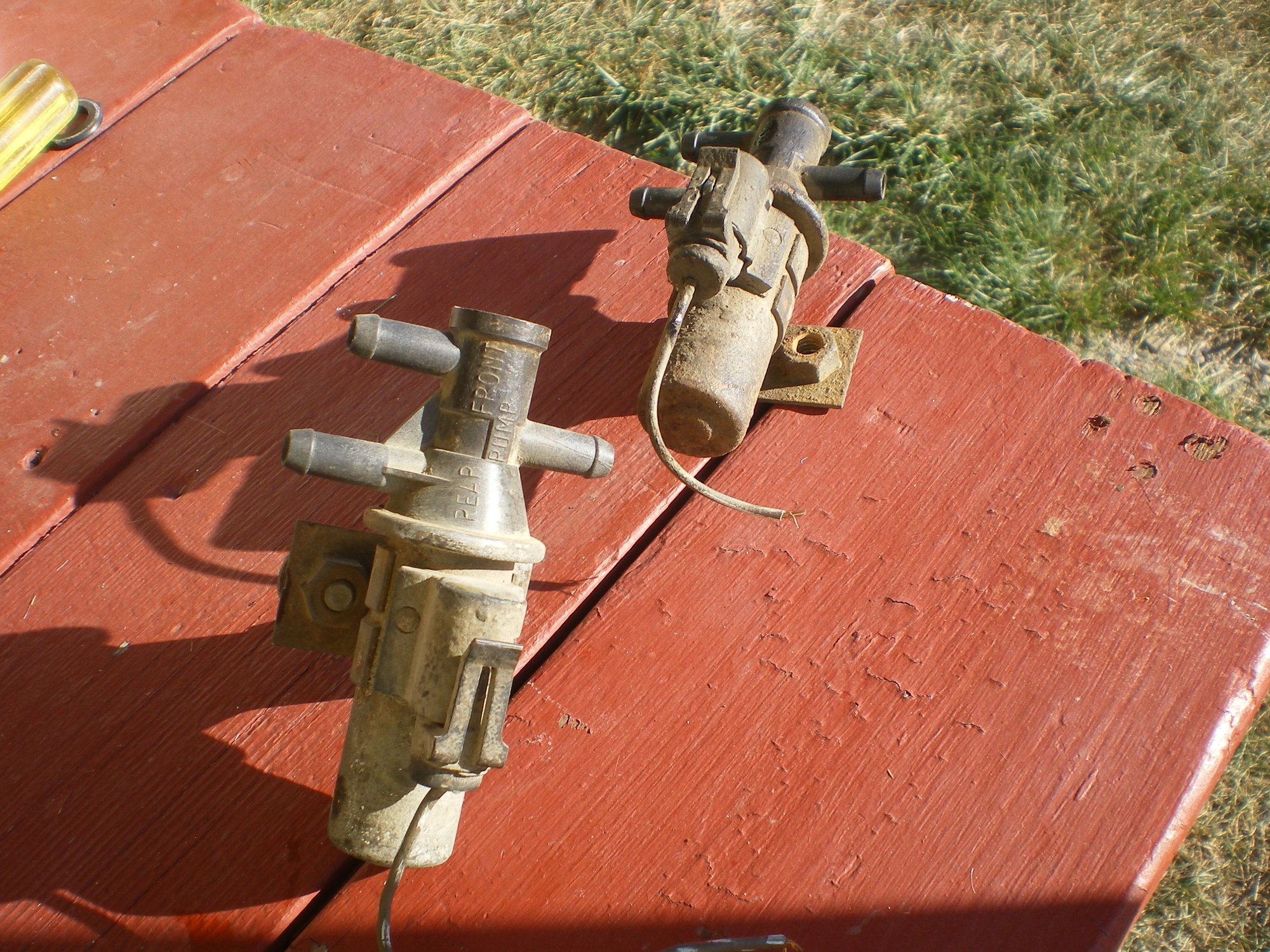

Originally Posted by JimsRebel
This 3 port valve was first installed in 1985 .. ebay seller listed the applications.
Here's the valve I believe the OP wants:
E3TZ-9189-D (replaced E0TZ-9189-A) .. Fuel Tank Selector Valve & Solenoid Assy - Use with mechanical fuel pump - 3 ports / Obsolete
There is another thread on this exact same topic titled 84 f-150 / The OP has a 1984 F150 351W, but the valve is the same.
Post 6: I listed this Ford part number, ID numbers, applications, last MSRP & dealer net cost, sources that have this valve NOS .. so I'd rather not have to do it again.
