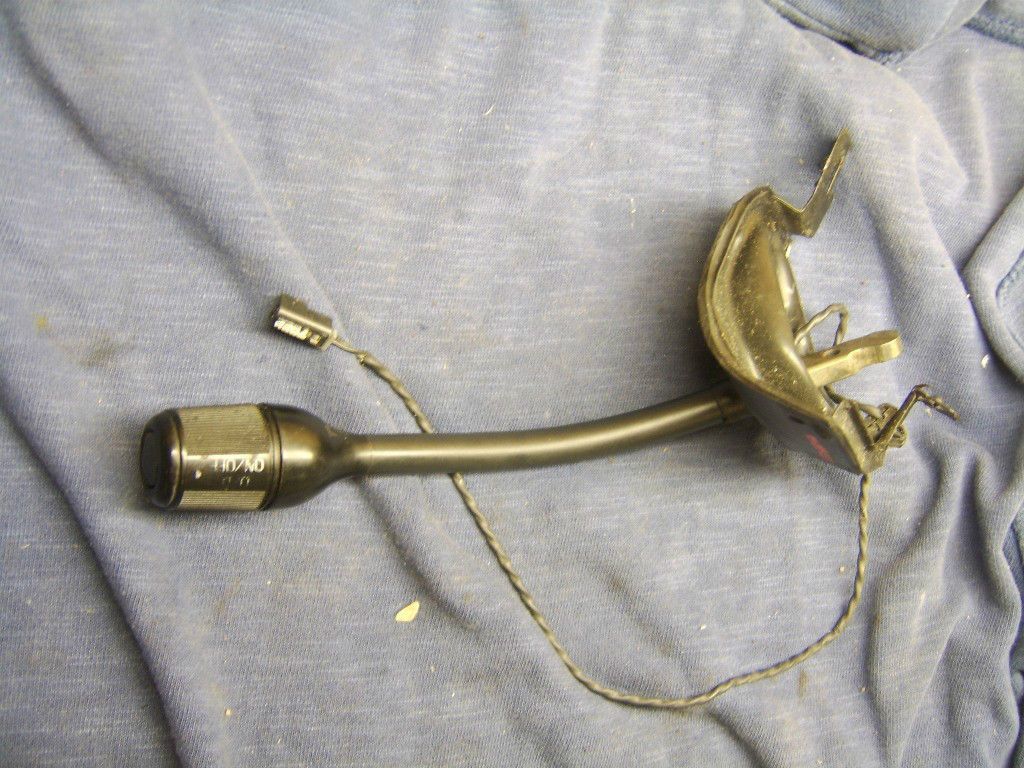

ok, i found the wires broke on overdrive in steering.. 2001 ford explorer sport..is there a special way to wire them? the wires are both grey under the black sheath....if i try to hook them up one way... i get a spark, then blow a fuse.. if i hook them up the other way i get no spark and dont blow a fuse, but do not see the overdrive light turn on on dash....please help?.....

yes 2 wires come from button from end of shift lever...i found wire broke inside steering column...but both wires are grey..no positive or negative color on the wires for hooking them up...they are 2 little grey wires in a black sheath...

thats not my shifter, but it shows the wire..
