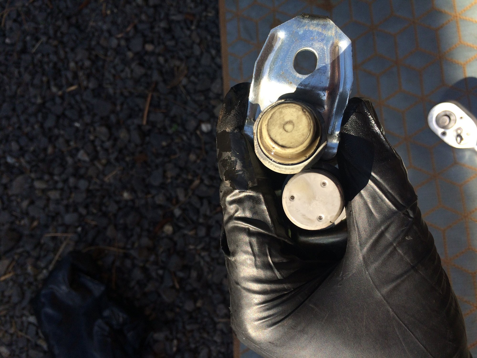

Old cps is the thinner of the two. New one is the fat one. Yes I know they're both gray but that's all I had on the shelves in garage. (Have a 97 7.3 also so I keep cps on hand).
