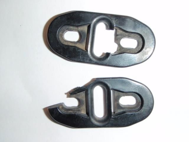

I am restoring my 67 F100 Flareside and the upholstery shop is doing some work on it. I don't know what to call it other than bench seat adjustment kit -- plastic is broken and I am missing the bolts. Anyone have some insight? schematics?

I think the parts are where the back meets up with the bench.

I think it may be the stop set, front seat back & cushion. Unfortunately, NPD has it from 68-71. It looks a bit different on my 67 seat if I recall correctly.

You were dead on. I was able to find a part number for the seat stop, C3UZ-8960060-A. It was used on 64-67 Econolines and the 67 F100. Now I need a lead on an Econoline or someone that has a spare off of a 67 truck. I have checked with various sources and have struck out. Here's a photo of the stop. I imagine that there is a pin or screw that goes along with the stop.

C3UZ8960060A.
Klimesh Motor Sales shows 1.....563-562-3241.
Manderbach Ford shows 3.........610-929-3683.

Originally Posted by Sam's1967
You were dead on. I was able to find a part number for the seat stop: C3UZ-8960060-A
It was used on 1963/67 Econolines / 1967 F100/750 & N/NT500/1100 / 1968 F100/750 from serial number C42,001 & 1969/71 F100/750 / 1972 F100/750 before serial number N00,001
Fixed it for you...

Prior to your post, I had called Manderbach and was told no, that they did not have them. I think the guy must have thought it was a big part or something and didn't see it on the shelf. I decided to call again and explained that it was a small part and the gentleman that assisted me was able to locate the part. Thanks for your help. I can check another thing off the list.

ND/JEFFFAFA, do you know what kind of pin or screw went with the stop (C3UZ-8960060-A)? Do you have a part number, diagram for same. As always, thanks for your assistance in this matter.
52735-S8 .. Pan Head Philips Head Screw - #10 -12 x 5/8" long / Obsolete
No Ford dealer or obsolete parts vendor has any. Try a hardware store or Fastenal.
