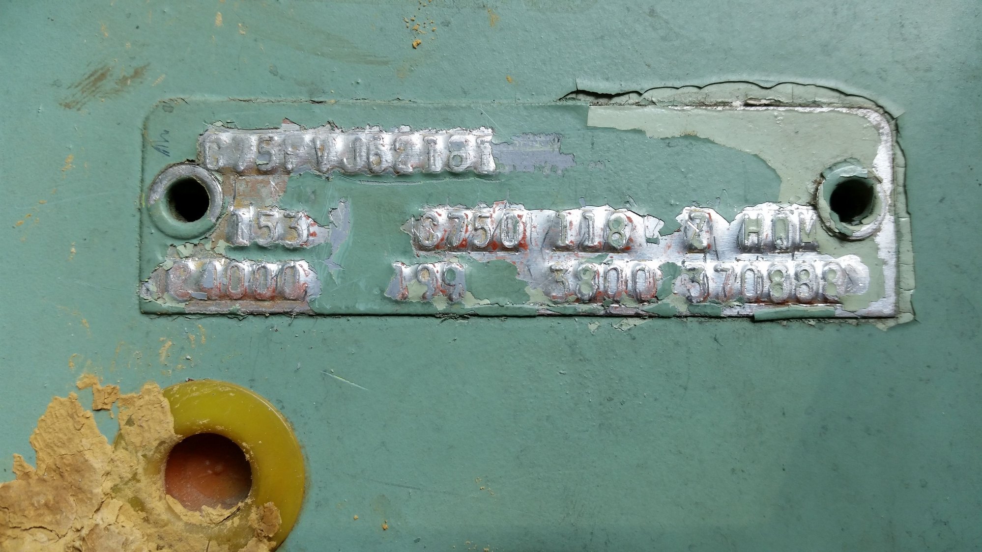

Hello, I am new to the site, but I have been tinkering since I was 10. I currently have two c series ford trucks. One I just purchased and I know the government issued title application is completely wrong. I would like some help with year, engine size, any details that can be obtained from the id plates.

C75FVJ62181 / W.B. 153 / COLOR: Blank / MODEL: C750 / BODY: 118 / TRANS: Z / AXLE: HQM / MAX GVW LBS: 24000 / CERT NET HP: 199 / RPM: 3800 / DSO: 370888
C75 = C750 Tilt Cab (gas).
F = 391 4V FT engine.
V = Kentucky Truck Assembly Plant.
J62181 = 1970.
153" Wheelbase.
COLOR = Blank, truck painted a non standard color per the original purchasers order.
C750 Tilt Cab (gas), 24,000 lbs. GVWR
118: 11 = Light Grey Crush Vinyl & Light Gray Blockweave Vinyl / 8 = 91A Standard Cab.
Z = Transmatic (Allison) model MT 540 6 Speed Automatic Transmission.
HQM:
HQ = Eaton model 17121 Single Speed Rear Axle / 7.17-1 / 18,000 lbs. Rear Axle Capacity.
M = Ford 7,000 lb. Capacity Front Axle with P/S.
24,000 lbs. Gross Vehicle Weight Rating.
199 net HP @ 3,800 RPM
370888:
37 = Buffalo NY Ford District Sales Office, where the original selling dealer ordered the truck from.
0888 = Domestic Special Order number, truck special ordered by original purchaser, not "bought off the lot."
C61EUF15425 / W.B. 135 / COLOR: G / MODEL: C612 / BODY: 4B91 / TRANS: O / AXLE: 55D / MAX GVW LBS: 23000 / CERT NET HP: 182 / RPM: 3800 / DSO: 710607
C61 = C600 Tilt Cab (gas).
E = 361 2V FT engine.
U = Louisville KY Assembly Plant.
F15425 = 1969.
135" Wheelbase.
G = Chrome Yellow.
C612 = C600 Tilt Cab (gas), 23,000 lbs. GVWR
4B91: 4B = Black all Vinyl / 91 = 91A Standard Cab.
O = New Process 541 5 Speed Direct or Fuller model T-905-B 5 Speed Direct. Same O code used for both.
55D:
55 = Rockwell model H170 Single Speed Rear Axle / 7.17-1 / 17,500 lbs. Rear Axle Capacity.
D = Rockwell 7,000 lb. Capacity Front Axle.
23,000 lbs. Gross Vehicle Weight Rating.
182 net HP @ 3,800 RPM
710607:
71 = Los Angeles (SoCal) Ford District Sales Office, where the original selling dealer ordered the truck from.
0607 = Domestic Special Order number, truck special ordered by the original purchaser, not "bought off the lot."

awesome, thanks for the info. I knew the title was way off. It lists the c750 as an 81 f750 diesel. I will get some pics up a.s.a.p. I am taking the fire engine body off, trying to decide what I want to do with it. Thinking of making it a car hauler for my other toys.
