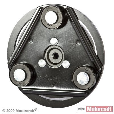

There is good resistance to the fan. I just had my intake manifold gasket replaced about 3 weeks ago and the antifreeze was at the normal level then but when i went to try and spin the fan i noticed that the anti freeze level was way below the cold line, so i added anti freeze to the cold line. so Im hoping that was the problem and not another leak. I checked the oil and oil cap and there was not sign of anti freeze in or on them and there is no anti freeze smell coming from the engine like before. but i did notice on one of the pulls there is a triangle piece of metal that usually spin but it doesn't do it all the time and the fan would spin faster and today i had the truck running for about 30 mins and it didn't spin of move once that im aware of.

Triangle piece is probably the electric clutch for the Air Conditioning Compressor.
It is normal for this to cycle on and off depending on demands of the climate control.
Amazon.com: Motorcraft YB3020 New Air Conditioning Clutch Hub: Automotive Amazon.com: Motorcraft YB3020 New Air Conditioning Clutch Hub: Automotive

I did figure out that the truck starts to over heat when the AC in on and that Triangle piece is the AC electric clutch ( thanks ArdWrknTrk for the pic and help) and as soon as the AC comes on the truck drops in rpms and when u step on the gas its harder to push and the engine sounds like its under a large load. still not sure whats going on.
