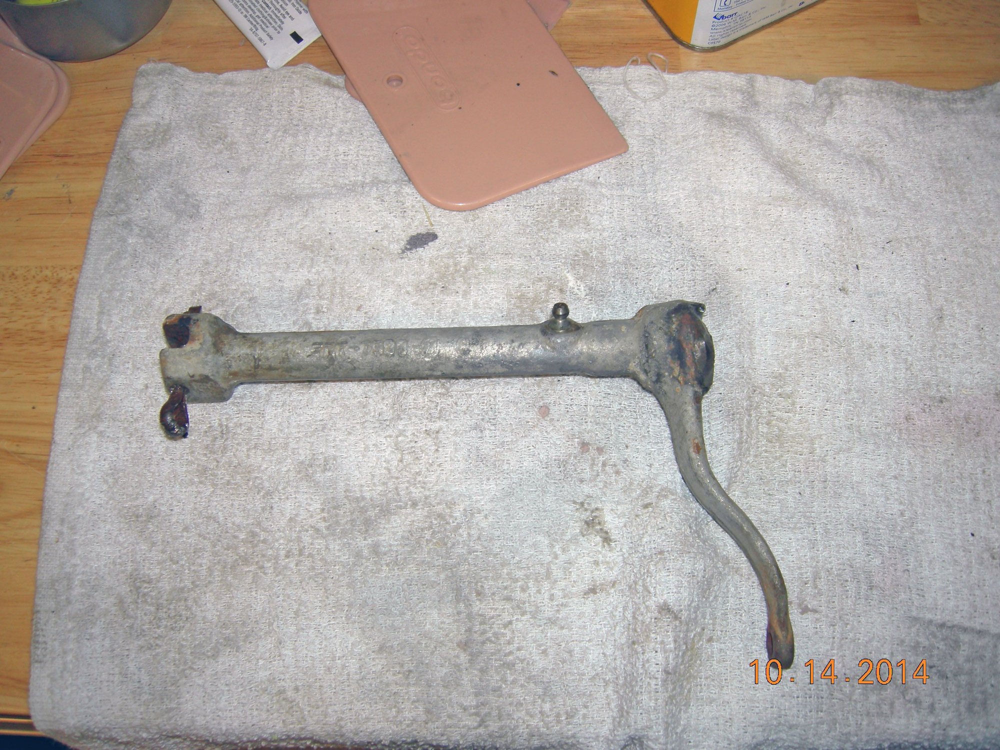

I just got a set of new bushings from LMC truck if that helps.
But, I need the clutch equalizer shaft (new or used) that these bushing fit inside. Here is a picture of the part from Van Pelt but they don't have any in stock. If anybody is parting out a 48-52 truck would you mind checking to see if you have one? It may still be attached to the clutch if you have removed the engine/trans as an assembly.
Mine is in pretty bad shape and has been semi-fixed at least once.
EDIT 10/20/14 1:41PM: You can ignore this I found the part - Bob @ NJPARTS
