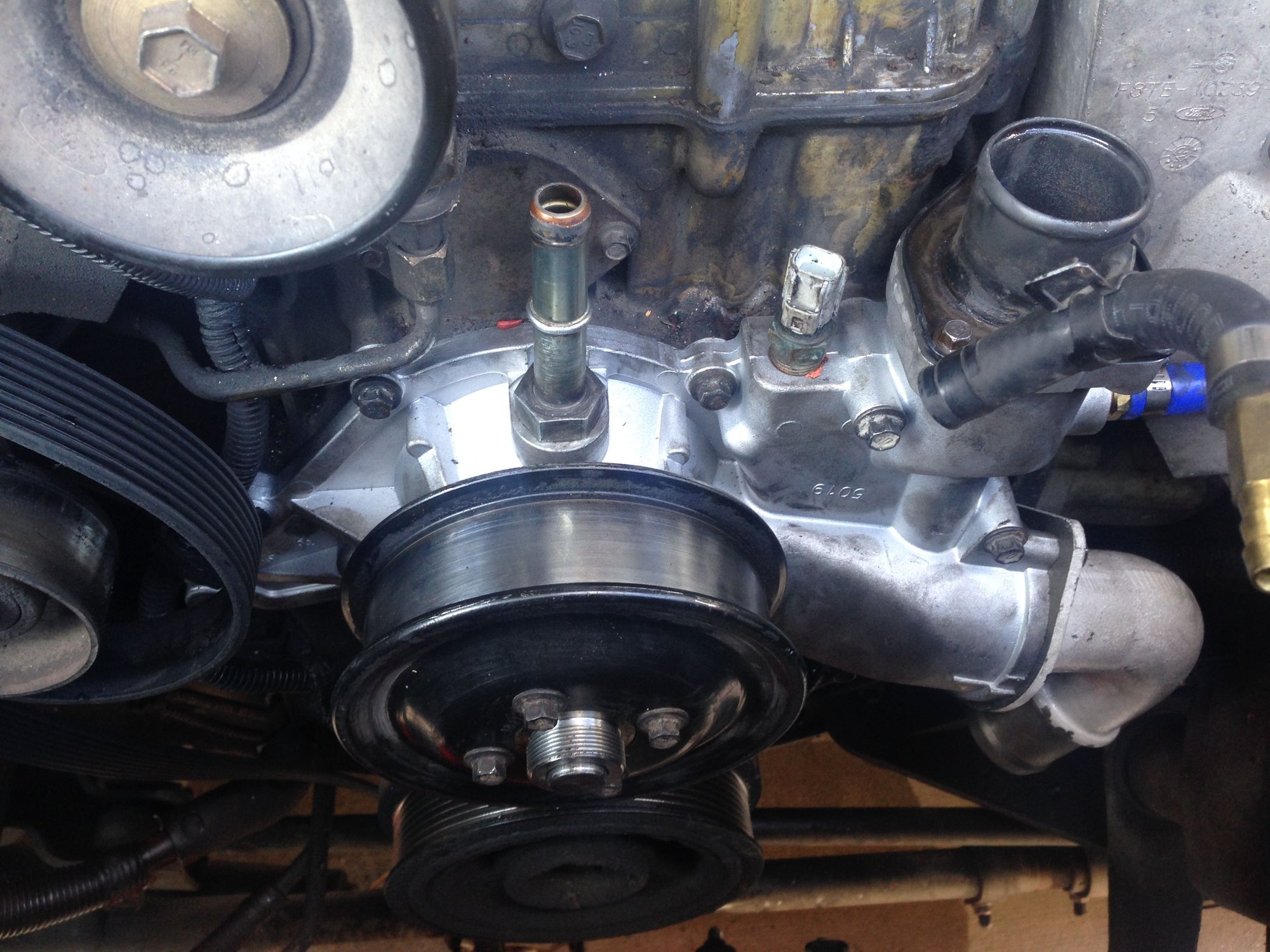

I'm going to try to post photos of the process. Y'all may have done this before, but I found that a belt-type filter wrench holds the WP pulley very well while installing/removing the fan and the bolts on the pulley (if you've already removed the belt or you don't feel like messing with the "fan removal tool"). It was pretty obvious the WP was bad once I removed the belt, and definitely after I removed the WP. I spent a good amount of time cleaning-up behind the WP due to all the shavings. **The only problem I ran into was the outlet for the lower hose that I got with the new pump was different than the outlet on the original pump. I considered using the old outlet, but it didn't look like it was going to seal well to the WP, so I used the new outlet. I had to cut the hose to align with the new outlet, but after doing so, I found that the hose wouldn't fit properly. It took a little grease and a lot of convincing for the hose to slide onto it. I hope it lasts. If it doesn't, does anyone know a part number for the correct hose for this application?

Boy! That was one toasty pump ! WoW !
