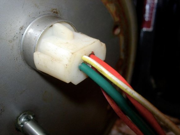

First, I bought a new Bosch pump (69430) from Rock Auto. Then I removed the sending unit from the tank and took the pickup foot off it. (Mack has a dump body so I just put it all the way up and have nice access to the tank!) Then I cut the little valve off the pickup foot and installed it on the input side of the pump, which was very tight. You can see the input of the pump from the bottom of the foot:
Then I removed the mixing valve thingy from the sending unit and bent the 3/8" feed pipe so that the pump would clear the fuel gauge bracket. Then I ever so carefully measured the proper distance for the bottom of the foot to be from the sending unit top. Dan suggested that I leave a little bit of space between the foot and the bottom of the tank so that the fuel flow isn't too restricted under high demand. Then I cut the stainless steel feed pipe on the sending unit at the right spot, and after drilling out the restrictive check valve on the pump fitting, I welded the fitting to the pipe. Now, my torch welding skills aren't that great and stainless is not easy to weld, so I had lots of pinholes in the weld. So I used some silver brazing rod to cover the holes and put some fuel tank patch epoxy putty over that for good measure:
For the wiring, I drilled through the wire block that the fuel gauge wiring goes through. I measured the diameter of the 14 g wire that I'm using to power the pump and drilled holes as close to that size as possible. I put a little dielectric grease on the wire and it's a snug fit:
Then I built a little "chimney" out of a gear oil bottle to protect the wiring from sloshing fuel (see first pic). This was an important tip from Dan, who said his first wiring broke because it wasn't protected.
