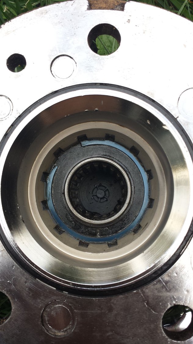

I realized this last night when I started to disassemble! Is this a newer style hub? Anyway, it gave me flashbacks to my '93 Explorer and I figured it out pretty easily. The only PITA was getting the caliper off the disc. It was definitely dragging a little, but not so much that I couldn't turn the disc by hand. But it was tight enough I had to whack it several times with a hammer to get it out. I will push the piston back in before re-installing, and grease the slide pins really well.
I got the spindle cleaned up and it looks good to me. Not scoring or pitting, just slightly discolored...maybe from heat? Here is a pick before I cleaned it up (too dark to take one after);
The outer bearing came right out as I pulled the rotor off the spindle, just like it should. I used the back (flat side) of the spindle locknut socket to tap the inner bearing and oil seal out. While cleaning all the old grease off the races, I noticed a lot of small metal shards. It actually looked just like gold flakes. Not sure what component this is from... The inner race looks fine to me, but the outer has two small gouges;
I am assuming I should go ahead and replace the outer race and bearing. Is it better to go ahead and replace the inner as well? Or should I just re-pack it? I will definitely be replacing the seal. Locknut looks ok to me. Here are the parts that came off the spindle, left being outermost, and right being innermost;
As for the hub, there are some gouges on the outer edge. I don't think this acts as a race or even a seal, so note sure it's worth worrying about. Thoughts?
