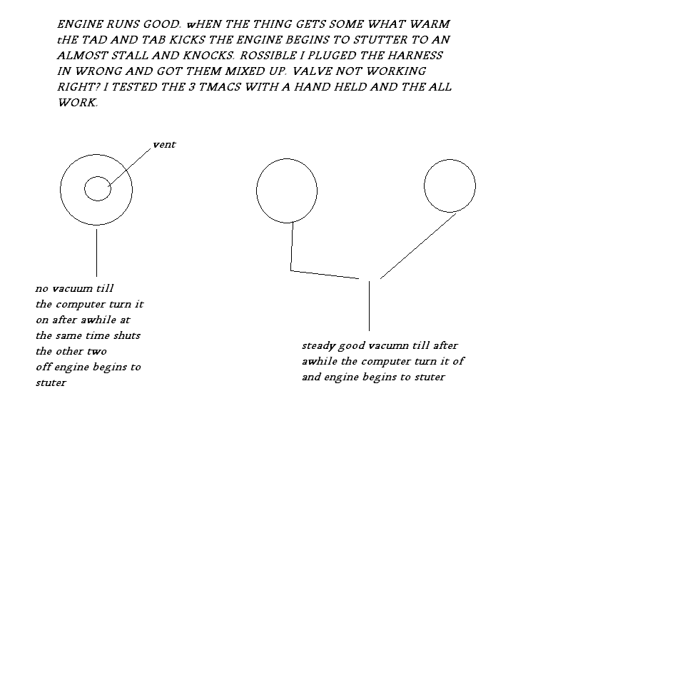

Replaced the new egr valve with a new working egr valve and changed my new colant senser with a new colant sensor that works and it runs real good
till it it starts to warm it loses some and at idle as soon as the tad and tab switch it stutters and starts to knock.

What are we looking at here. what year make and model engine size what was done to her. I will try to help but I need info

92 ford f250 351 4x4
I pulled the engine replaced the oil pan. Port head had a blown head gasket
so I replaced the head. 152000 miles

Air pump filter. I forgot there was one. Thats good .I had the truck for 11 years
and never changed it. Its raining now but when it stops I go pull the hose of and see what it does

Whats that thing on the starboard fender, Attached to the airpump
Looked like a filter. Is that an intake or somekind of discharge?

I think theres a sticker on the hood with the emmisios diagram.
