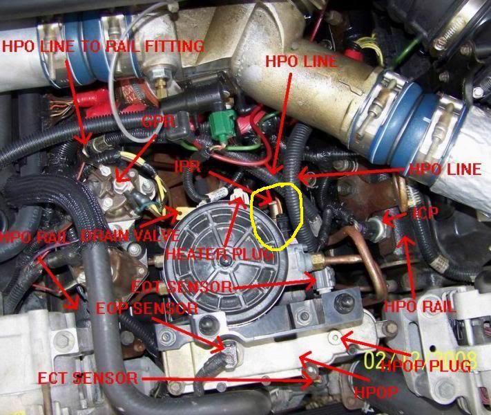

The IPR (injector pressure regulator) controls the HPOP (High pressure oil pump). The nut on the back (tin nut) along with the spacer holds the solenoid onto the IPR. It is located in the rear of the HPOP here

In the center of the engine up front is the HPOP. On the drivers side of that is the IPR.
It should have a tin nut holding the coil on, if its loose or off it will change your high pressure oil to the injectors or not work at all. Take a look. Always go OEM on sensors!
Nice job of making it clear, with cartoons and all. Reps sent

The tin nut tends to fall off into the valley, then the solenoid part slides around.
They also tend to get stuck internally with age. You really need some way to read live data for us to do more than guess what the problem is, though.
