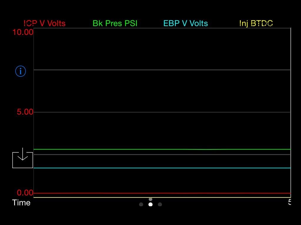

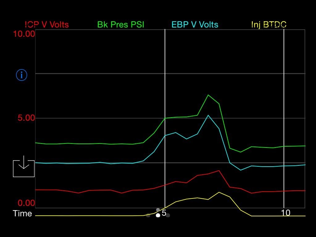

It looks like all of your measurements above are in psi, not inches of mercury but would expect EBP to be around 14 plus too.
My EBP volts show 1.7-2.3 KOEO, 2.7-5.7 when running.
Here at KOEO. Volts at 1.74.
While idle with slight surge.
