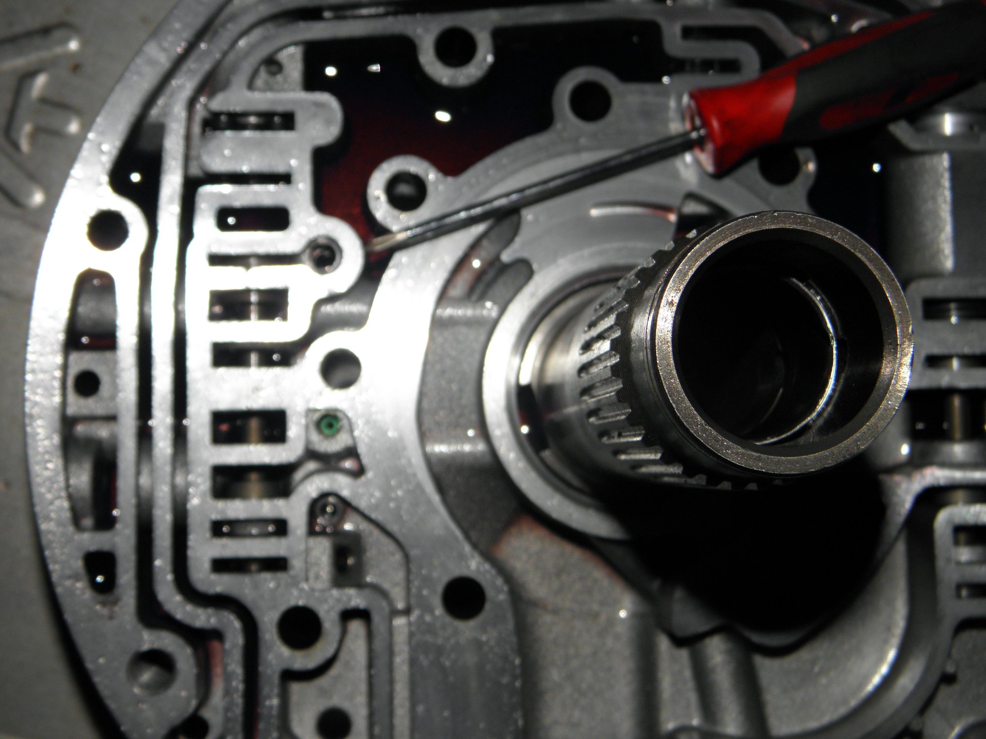

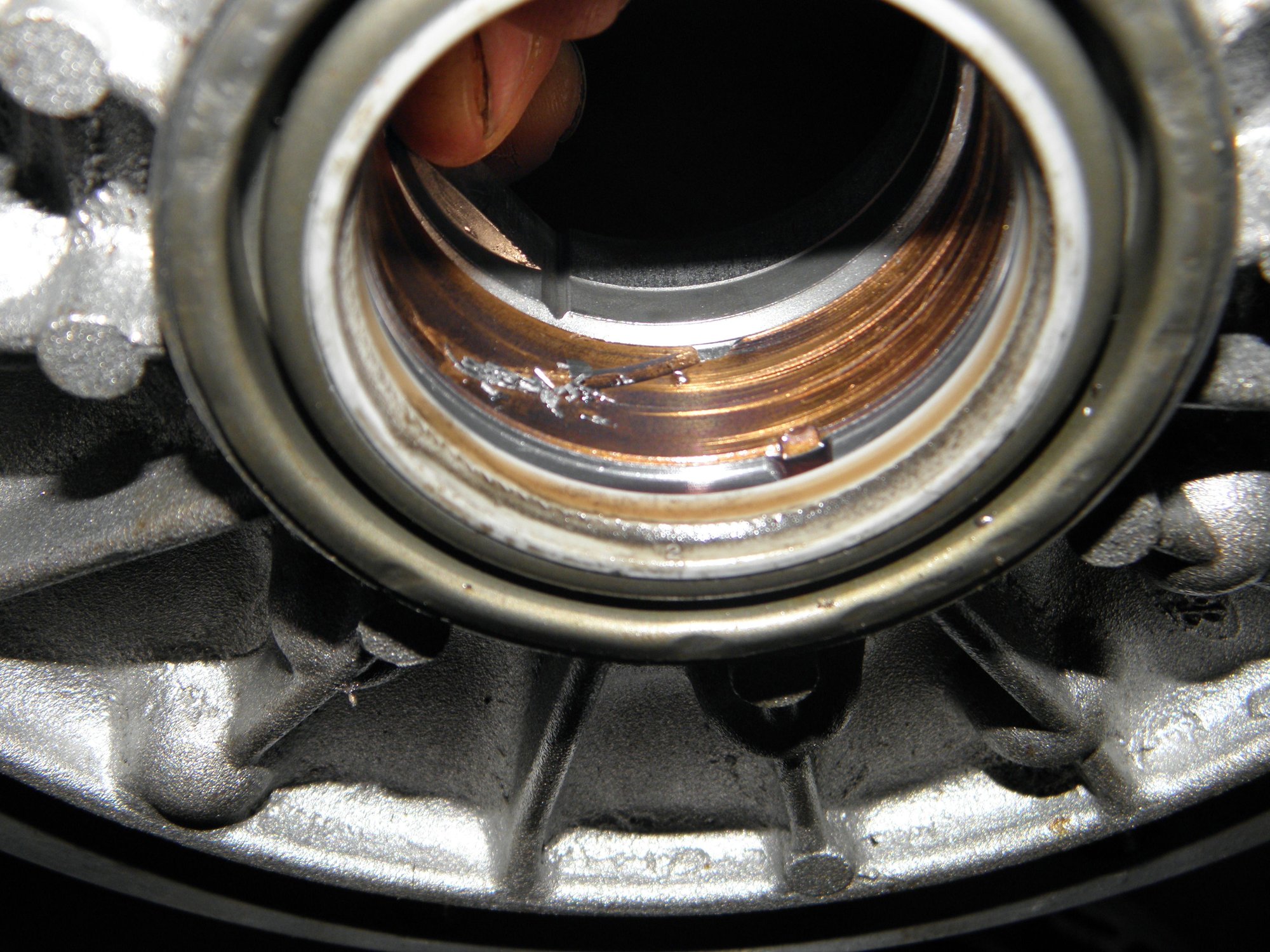

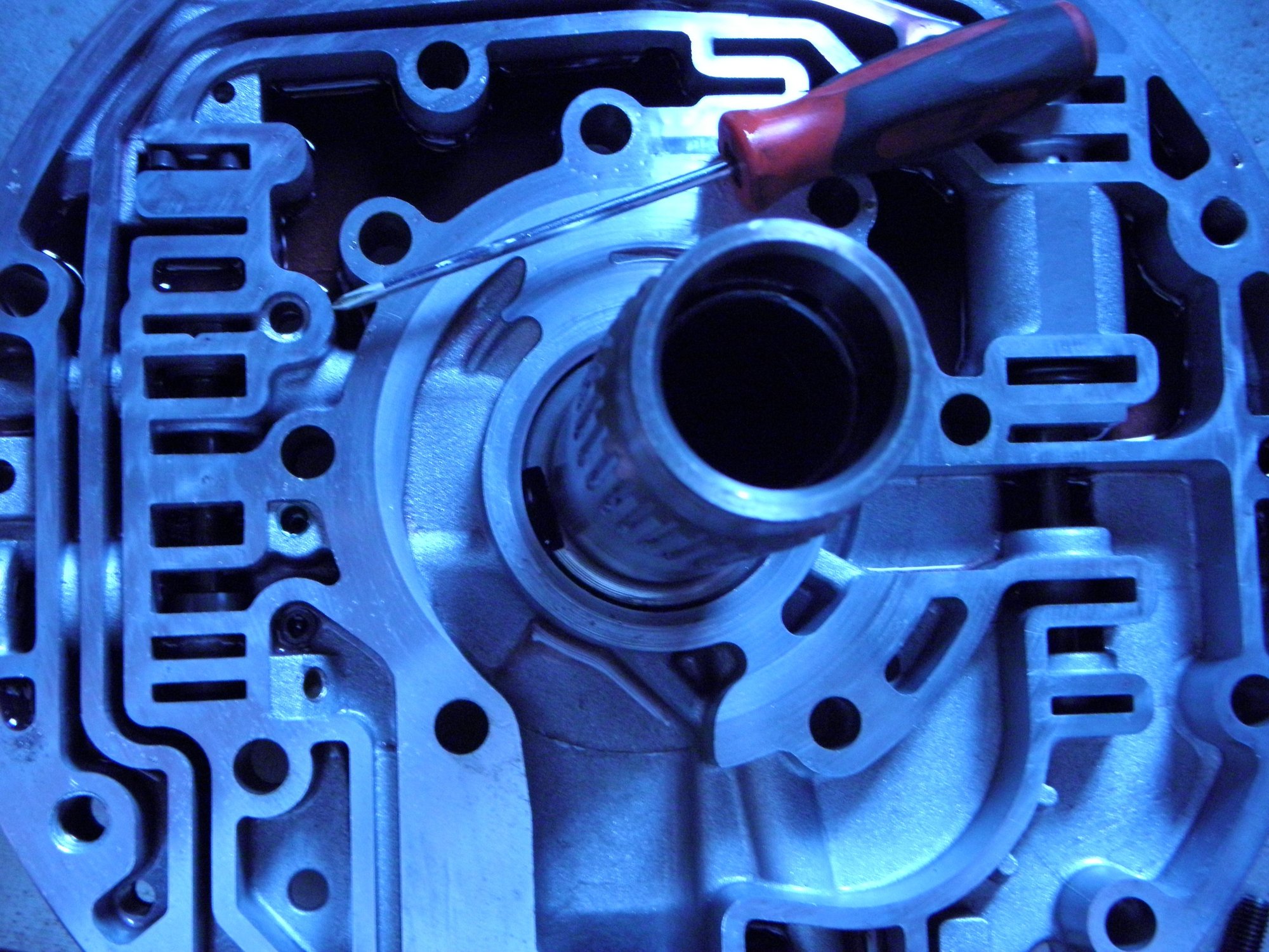

so the saga continues….I have just about zero budget, so please understand I will not be a btw candidate anytime soon, although nothing would be finer than a scrap and slap at this point….so I will try and post some pics, but meantime I have decided to do some investigative teardown….I have the trans out and it looks like someone beat the pump seal in with a drift punch….the hub on the converter has been strapped with emery cloth…..so I decided to remove pump and disassemble…..the bushing is still in tack but looks to be chunks in the oil groove….but what the question is ….while looking at the transgo pump upgrade info, it shows drilling out the hole in the orfice plug larger…it seems to be missing the plug altogether, even though you can see a stake mark where one used to be…is this normal or not good??

I am just wondering if that missing plug in the pump housing was contributing to my overwhelming fluid loss….besides the seal?

99.5-up use a PWM (Pulse Width Modulated) torque converter lock up and E4OD and E99's have the non-PMW (On-Off) lock up. The pumps are different and do not have the converter release orifice plug on the PMW versions. There is a TransGo kit to convert the PMW to Non-PWM, if desired. I did this on mine.

Which plug is missing?

Pictures
So it took a few minutes, but I figured out the upload process…..
