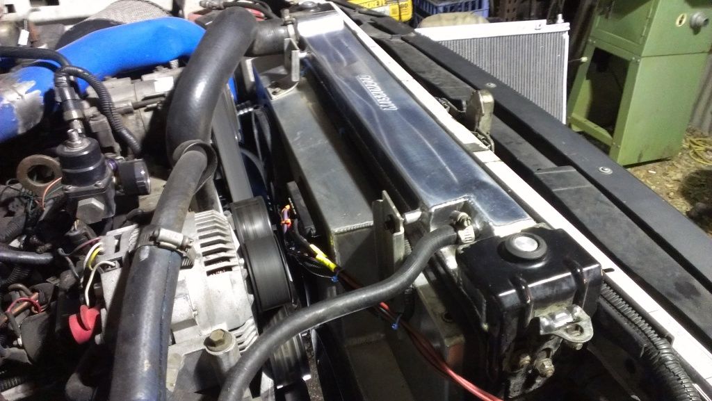

This is Travis setup
He swapped to a SD setup with SD e-fan, upgraded alt. and upgraded charging wires

E-fans are great if the setup is done correctly. The most I've towed with mine was about 15,000 lbs gross. Honestly, I don't think I'd put them into a setup knowing I was going to tow much more than that. I didn't overheat pulling that load, my oil temps got up around 215*. It used to run anywhere from 210-220* empty with my mechanical fan and 203* t-stat cruising at 2500+ RPM.
My fans are wired with a switch in the upper radiator hose and use a multi speed controller to ramp up the speed depending on what you're asking the fans to do. I have them wired to turn on @ low speed with the AC running when the engine isn't up to temp. If the engine is up to temp and the AC is running, they will go to high speed if they aren't already there. My fans pull around 35-40 amps IIRC.
At idle, a stock alternator cannot keep up with the fans, AC, and headlights all running at one time. It doesn't really even like the fans and AC running together. I switched to a 270 amp Mechman alternator and a 0 gauge charge cable to alleviate that problem. Voltage held at a solid 14.3v after that.
Here's a more recent pic of my Flex-a-lite fans and SD radiator setup.
