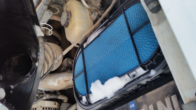

Oh right. Pictures.

Originally Posted by A/Ox4
Oh right. Pictures.
Attachment 105154
Soap suds?

Originally Posted by Y2KW57
Soap suds?
Not a clue what caused the foaming.
