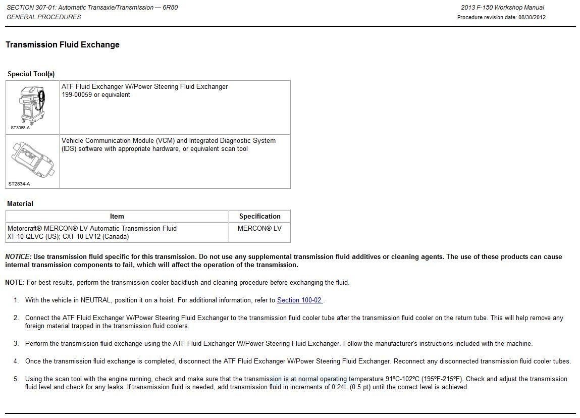

You can't flush the 6r80. It has an internal thermostat that will block it. The only thing that can be flushed is the cooler.

Originally Posted by gDMJoe
Fluid exchanging is NOT flushing.
That contradicts everything I've ever read about the subject, to include lots of posts from Mark K. Lots of people believe in the mythical "backflushing" of a transmission, which is a physical impossibility with a positive-displacement fluid pump.

Flushing typically involves using a chemical additive and is pressurized via the machine pump. Flush machines do not typically heat the fluid. Ford's exchanger allows the transmissions own pump do the work and the fluid is heated in the exch. machine to overcome the internal thermostat.
Notice that you also have to use a scan device to monitor trans temp? It may seem like splitting hairs but in fact it's a completely different process.

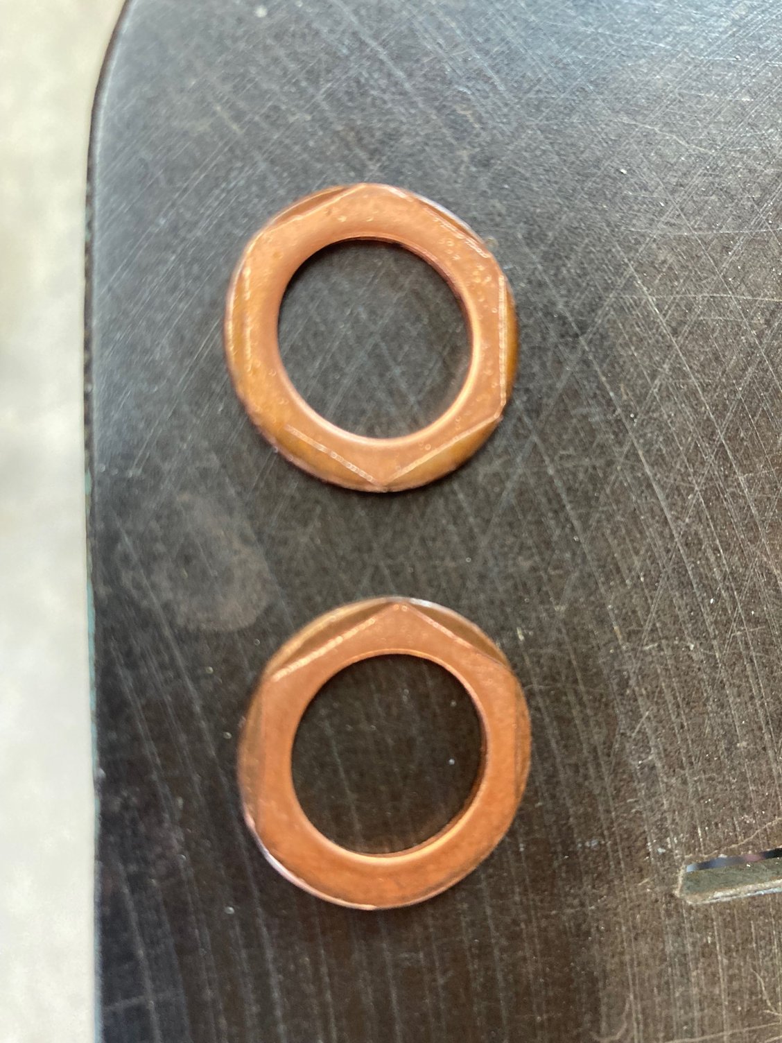

A little off topic, but when I did my pan drop/filter change, I went back with a Dorman pan with drain plug. While there have been some quality problems with the Dorman pan, including the first one I got, this makes it real easy in the future to do drain/fills at much lessor intervals.

Originally Posted by techexchange
Do you know the Dorman part #? I'm a 2010 Explorer 4.6L V8 with 6r80. Looking for a way to get a drain. Will the pan work for me? What were the quality issues?
i cant speak regarding compatibility between explorer 6R80 vs f150 6R80, but can do a search.
the quality issues, i and others have noted here, is the drain plug does not sit flush. The first pan I received had this issue, I notified Amazon and got another pan in just a couple of days, the second pan was perfect.
the pics below show the issue and the copper washers. You can see how even the impression on the second washer from the replacement pan is even
